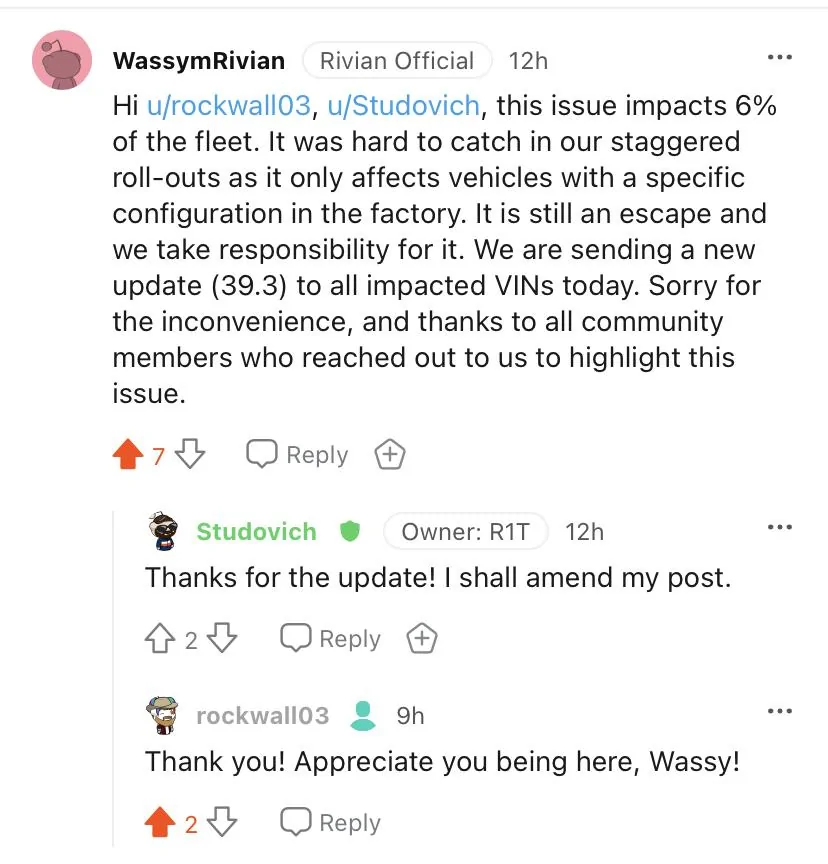

Was there any confirmation of it being software related
That is probably the patched 39.1 that will fix all of our compressors!
I spoke with Cust Service today, no fix yet but one coming S00N. Curious as to what 39.3 is...no one has posted release notes.
Release notes are identical to .1, so unnamed bug squashes (though presumably not the one we want). So, seems like we're waiting for something after .3.

Regarding compressor not functioning after update 39.1
Sounds like those of us who have functioning compressors will stay on .1 rather than get .3.
I’d be curious to know what configuration triggered the problem.
