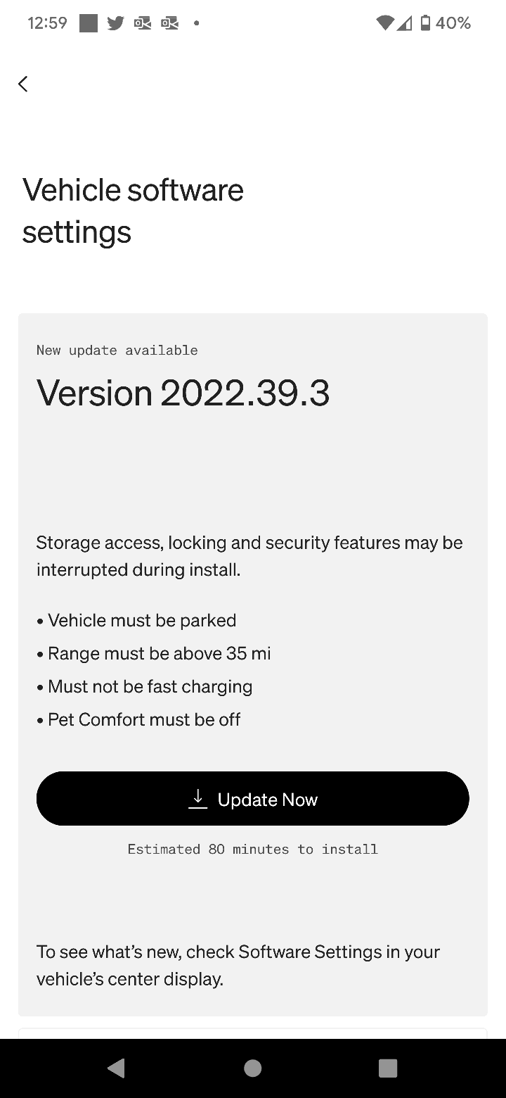

No 39.3 for me yet, waiting for the notification on my phone. Truck is with my partner at their house tho but should be able to get it updated as soon as it rolls in. Would love to get it before a day trip tomorrow.

Anyone definitively know if we need to install the 39.1 update BEFORE the 39.3? I have a pending update notice in the truck for 39.1, but wondering if it will be replaced by a notice for 39.3? Or is the only way to get the 39.3 updates is by installing the 39.1 first?
i went straight from .35 to 39.3 just now. Notification to update to 39.3 showed up about an hour ago and i downloaded it right away. I don't think you need the 39.1 to get 39.3
Thanks. I'm wondering if my pending 39.1 will block me from getting the 39.3 until I install it (39.1).

has anyone that installed 39.1 gotten the notification to update to 39.3?

went from 35.3 to 39.3. Air compressor works and media buttons work. FM radio does not. sat at the reconnecting spinner for a while and now says Could not connect
