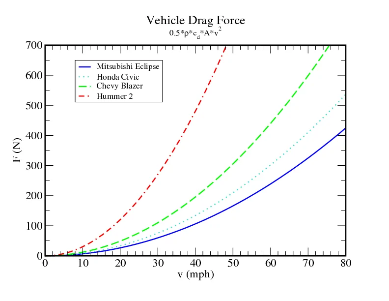

It sure does seem like aerodynamics matter more than weight at high speed. I wonder what the test would look like around town (45mph or less). The answer will likely be a combination of more battery (trailer or tow vehicle) and better trailers. Image below just a more fun version of standard drag vs speed graph.

Once you get the weight up to speed, inertia helps a lot, so yes, I'd agree that aerodynamics are vastly more important than the amount of weight in the back, and you can't take that 1500lbs as any 1500lb load, since the trailer they were using, even without the wood setup, would have generated a fair bit of drag.
