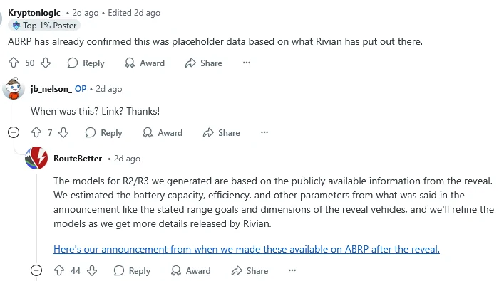

Update:
ABRP confirmed these range figures are just them guessing based on public info.

Update:
Reminder: Just because Rivian now owns ABRP doesn't mean the people who are day-to-day involved with ABRP have any inside knowledge about Rivian vehicles. From what I can tell, ABRP is still essentially being run as a separate company.
