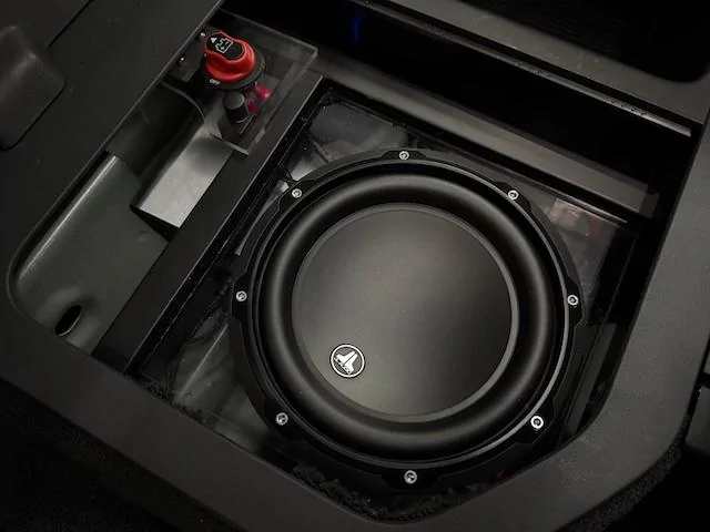

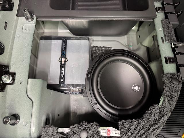

The main bracket is designed from 10 Series 8020 aluminum and a piece of 1/4 cast acrylic slotted in the groove. I used Sikaflex-252 to hold the aluminum and acrylic together. It is used in the automotive industry to bond components together, and it has a slight flex to it. The entire bracket is suspended with 1-inch industrial rubber spacers. The bracket is drilled to accept longer M6 bolts that pass through the original subwoofer mounting points. The rubber spacers allow the sub to sit just about ~1.5 inches below the seat but high enough to allow the amp to sit below it.

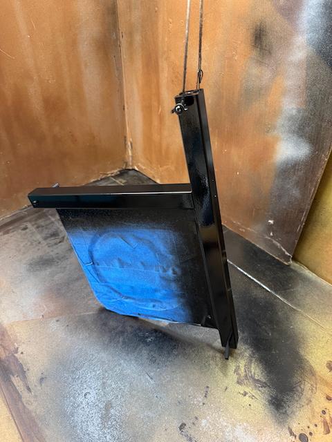

High end paint booth:
Rivian R1T R1S 2025 R1T Tri Max - Subwoofer Replacement - Upgrade to Premium Audio IMG_4404

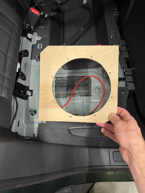

Bracket template:
Rivian R1T R1S 2025 R1T Tri Max - Subwoofer Replacement - Upgrade to Premium Audio IMG_3543

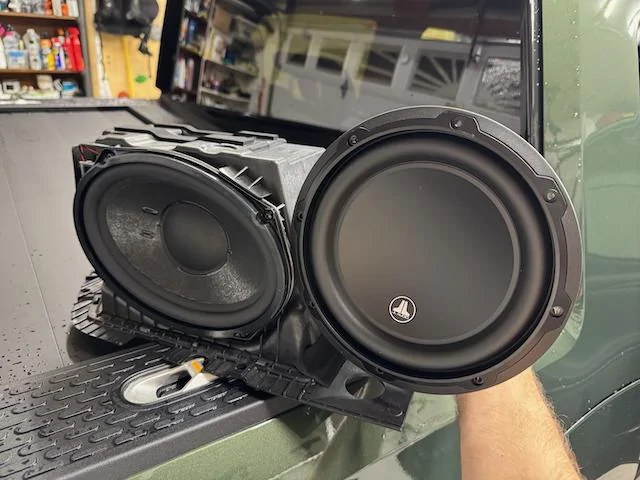

Sub comparison to OEM:
Rivian R1T R1S 2025 R1T Tri Max - Subwoofer Replacement - Upgrade to Premium Audio IMG_3520

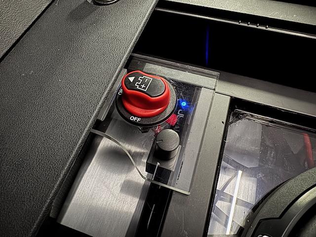

I added a on/off switch in case I need it off, and the volume know to adjust the sub output. I just like switches.
Rivian R1T R1S 2025 R1T Tri Max - Subwoofer Replacement - Upgrade to Premium Audio IMG_4479

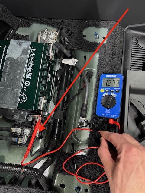

The power was connected to this specific bolt on the 12v battery under the seat. It's long enough to accept additional customers. 30amp fuse within ~6 inches..
Rivian R1T R1S 2025 R1T Tri Max - Subwoofer Replacement - Upgrade to Premium Audio IMG_3536

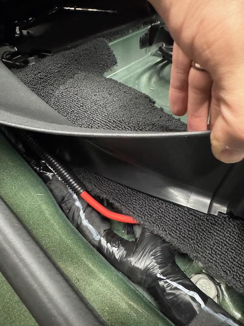

The power cable was routed along all the other 12v cable going to the back of the vehicle behind the side trim:
Rivian R1T R1S 2025 R1T Tri Max - Subwoofer Replacement - Upgrade to Premium Audio IMG_3537

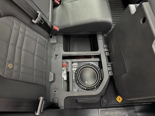

The final product:
Rivian R1T R1S 2025 R1T Tri Max - Subwoofer Replacement - Upgrade to Premium Audio IMG_4448
Rivian R1T R1S 2025 R1T Tri Max - Subwoofer Replacement - Upgrade to Premium Audio IMG_4447

What holds the amp in place? did you screw it down? Double sided tape?
8,808
12,086
Interesting. I've always thought a sub needed to be in a fabricated enclosure, sealed or ported.
My thought exactly. But then I guess the space itself is small enough to act as a ported enclosure? This is my first iteration but I don't mind changing it around if an audio engineer comes by to provide feedback.

According to the sub specs, ideally it should be mounted in a sealed or ported enclosure with the following specs:
  • sealed box volume: 0.3 cubic feet
  • ported box volume: 0.35 cubic feet
I'm not sure how many cubic feet the under seat storage area is (with existing driver side tray in place). IIUC, it's "vented" since the opening of where the original 6x9 speaker is still present.
