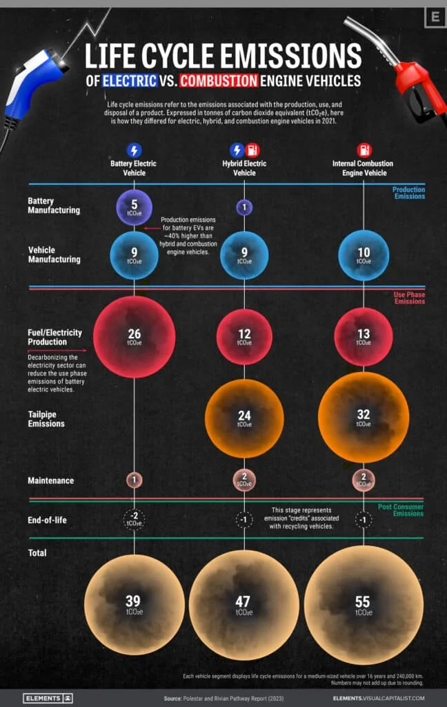

Most comprehensive EV vs ICE study ever performed. Finally someone compared the entire lifecycle to include mining of lithium, vehicle production, electricity generation, and disposal. It also factored in size of vehicles, location, and use cases (including towing).
On average, EVs take 4 tonnes more CO2 to produce, but ultimately save 20 tonnes of CO2 during 15yrs of operation. There is a net savings of 16 tonnes over the entire lifecycle for each EV. Trucks are the biggest delta at 78 tonnes savings over life. They didnt do a seperate breakdown of full size SUVs though, but is likely closer to pickup truck than it is midsize SUV.
New U-M Cradle-To-Grave Analysis
Actual Study
Rivian R1T R1S EV vs ICE - Most Comprehensive Study Ever Performed [report by American Chemical Society] 1757340951278-zo

Of course the study is assuming you will be able to get and or afford the parts to keep your EV running 15 years. The original battery will need to be replaced to reach 15 yrs so add additional manufacturing CO pollution to the final number for EV's. Look at it this way, the Model S was first produced in 2012, that was 13 yrs ago. If you had a 2012 Model S with a shot battery, would you replace it knowing how much a used battery pack replacement (including labor and transporting the vehicle to a shop that will perform the replacement) costs and how outdated the vehicle systems, especially the computers are at this point? Now add another 2+ years to reach 15 years of age. IMO, the study would have been much more realistic if they only projected it out 10-12 years, not 15 years.
Even if the entire battery needed replaced (which it likely wouldn't, or it would be a recycled one) that'd only add 5 to the total lifetime according to the pic.
