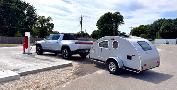

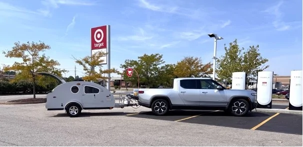

We had to disconnect the trailer at 30-40% of charging stops. We are lucky to have a small, light trailer that we can push around if needed. A nit that I have is that when the trailer is connected to the truck, it does a good job of indicating what target SOC and miles to charge to. However, if you drop the trailer, it estimates this based on the truck without a trailer. I frequently forgot to note the target before dropping the trailer and then then had to pull up my calculator app to estimate the target SOC needed for the next stop.

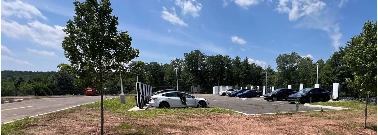

Some Tesla stations are not trailer friendly at all. An example is the new gen 4 station at Willington, CT that has a 2-lane entrance, a tight 180-degree turn to enter, and a confined charger area with no place to drop a trailer or turn around once inside. On top of that, it is a busy station. After getting to a charger, we had to drop and push the trailer aside to not block traffic.
Rivian R1T R1S 5,012 mile journey with a teardrop trailer 3-1
Photo from PlugShare

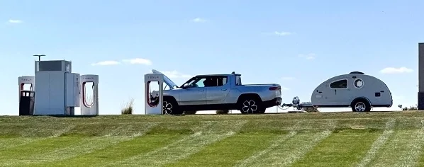

Most Tesla stations still have the single row layout and many were mostly empty, allowing us to pull in at angles or even straight in if we wouldn’t block access:
Rivian R1T R1S 5,012 mile journey with a teardrop trailer 3-2
Bridgeton, MO
Rivian R1T R1S 5,012 mile journey with a teardrop trailer 3-3
Bettendorf, IA
Rivian R1T R1S 5,012 mile journey with a teardrop trailer 3-4
Abilene, KS
