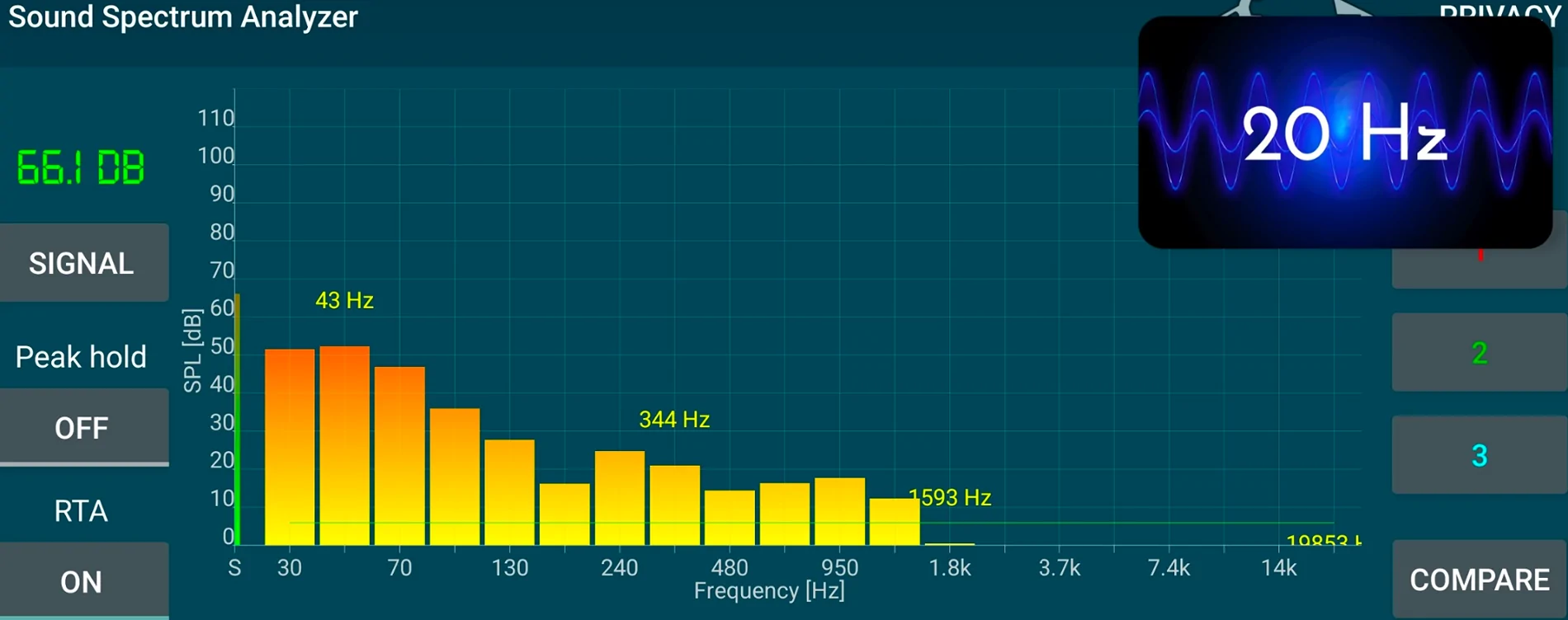

Bass reproduction is similar even down to 20 Hz, but the Merridian has more power. At low volumes, the bass is strong in both systems. But at high volumes, the Premium breaks while the Meridian cranks. You should hear very low bass in your Premium system at moderate listening volumes. At high volumes, you likely hear bass distortion, destroying the quality of the music.​
Testing Environment:
To objectively measure this, I used my Samsung Galaxy S25 Ultra placed in the same place on the center console, microphone facing the rear of the truck. I acknowledge it is not a precision instrument.
I used an application called Sound Spectrum Analyzer to measure the frequencies produced by the systems. I struggled to get screenshots without causing noise during the process of clicking the buttons. I was able to get some clean screenshots and used those in the analysis below.
I used YouTube on my phone as the audio source, via a Bluetooth connection. This is not the best quality connection but because I had a loaner, and I wanted to be consistent between the tests, it seemed like the most consistent method to use. I found audio for specific frequencies and for white noise. I used the exact same sources for testing each system.

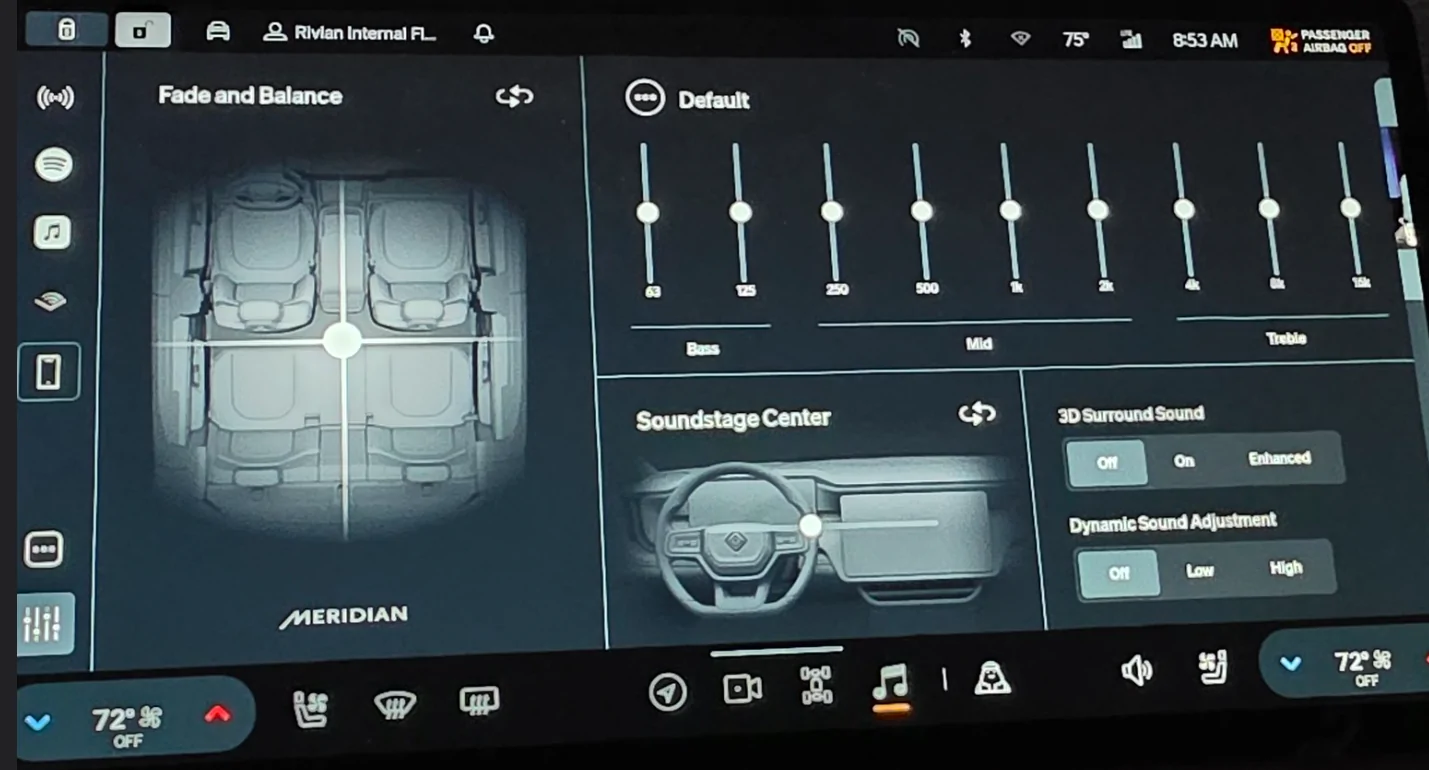

I flattened the EQ in both systems and removed any extra processing. Like shown here:
Rivian R1T R1S Meridian vs. Premium Audio: an objective comparison 1760885882055-i6
Testing:
Since it seems like bass is the biggest complaint between the systems, I focused my testing on that part of the spectrum. However, I did notice the Gen2 Premium has better high end performance, subjectively. This observation seems to be confirmed by the white noise testing. I did some measurements to confirm at 10 kHz, 15 kHz, 18 kHz and 20 kHz. I admit my ears can no longer hear anything at 15 kHz or higher, but I measured up there anyway.
I recorded bass measurements at: 20 Hz, 25 Hz, 30 Hz, 40 Hz and 50 Hz.
Based on subjective listening, I expected the bass to be similar between the two systems. At low volumes it was. But at high volumes, the Gen2 Premium rattled and crackled and sounded like it was destroying the subwoofer, especially as I got below 50 Hz. So sad. This makes me think just replacing the speaker with a decent one that can handle the power would take care of the problem. Maybe I will try that.
The Merridian never sounded stressed, even at high volumes. It just reproduced the bass, strong and clear.
I tried to get a similar volume setting so I could get measurements that objectively compared output. To do that, I used the white noise source and sent both systems at the same dB level for white noise.

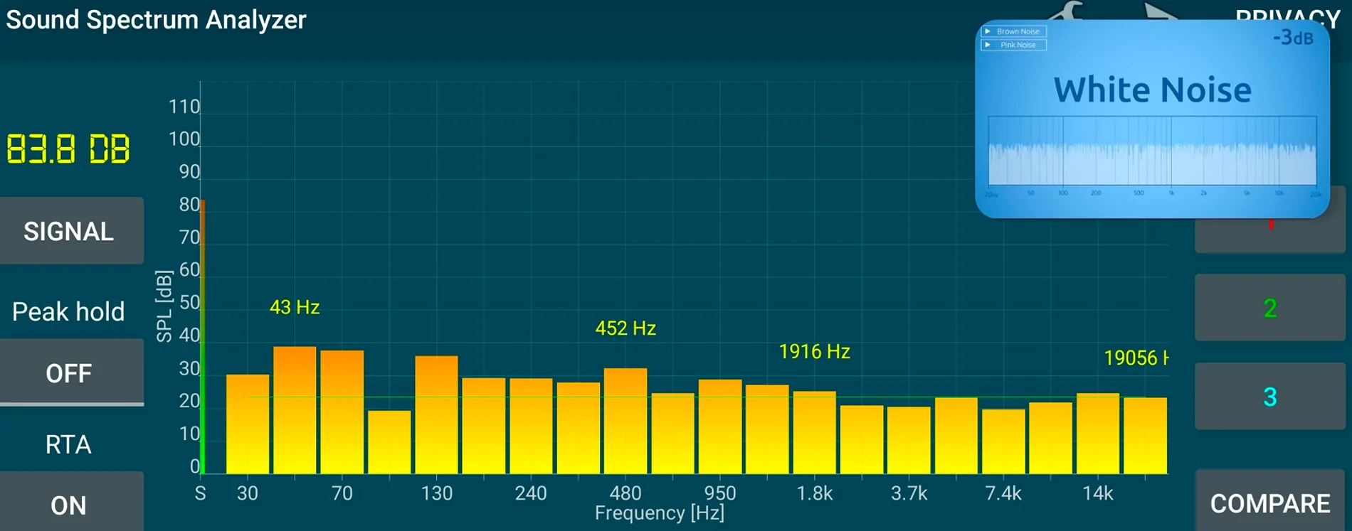

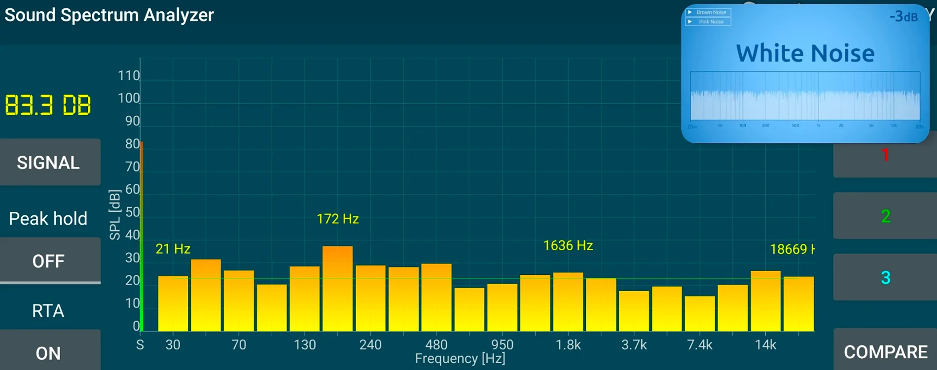

Meridian, white noise:
Rivian R1T R1S Meridian vs. Premium Audio: an objective comparison 1760885933856-wk
Premium, white noise:
Rivian R1T R1S Meridian vs. Premium Audio: an objective comparison 1760885949383-ts
Conclusion: notice how the Premium seems to have a flatter response. Still good bass, but stronger in the higher frequencies relative to the lower frequencies. This was supported by my subjective listening.

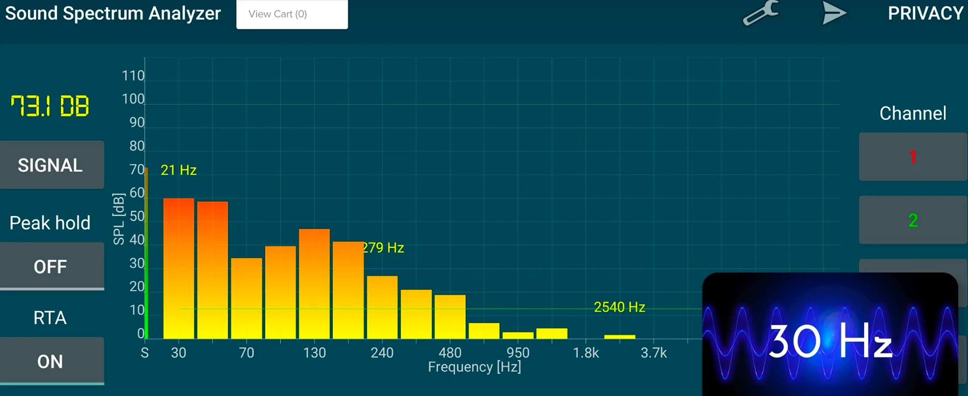

Meridian, 30 Hz
Rivian R1T R1S Meridian vs. Premium Audio: an objective comparison 1760885973292-nt

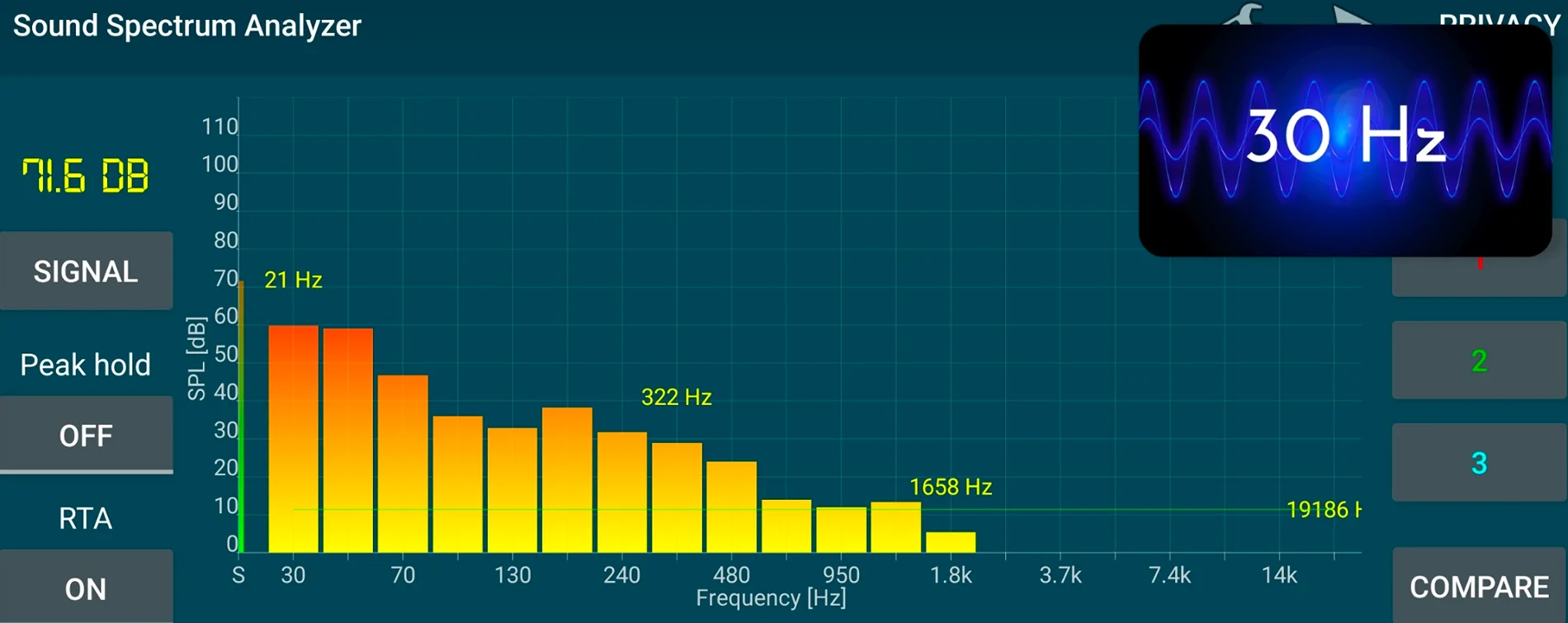

Premium, 30Hz:
Rivian R1T R1S Meridian vs. Premium Audio: an objective comparison 1760885990490-fi
Conclusion: the bass with a 30 Hz signal is very similar in the Premium than in the Merridian, at the same white noise level. The overall dB volume is higher in the Premium, but if you check the low frequencies the volume is practically identical. This was supported by subjective listening.
Meridian, 20 Hz:
Rivian R1T R1S Meridian vs. Premium Audio: an objective comparison 1760886007236-p9

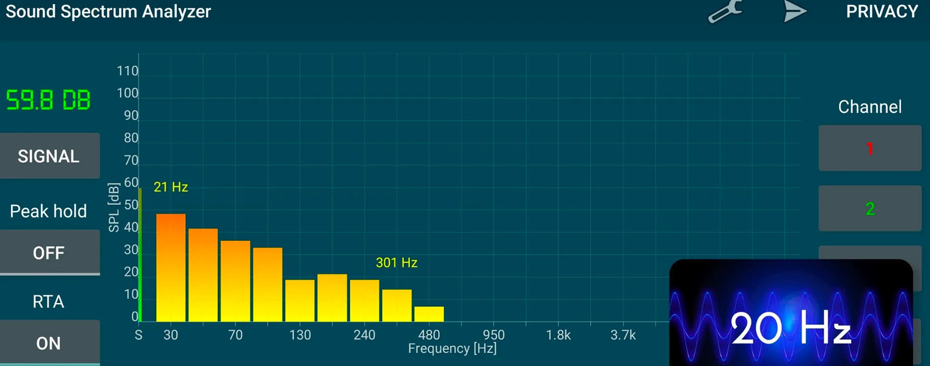

Premium, 20 Hz:
Rivian R1T R1S Meridian vs. Premium Audio: an objective comparison 1760886024598-yi
Conclusion: overall bass at 20 Hz is louder in the Meridian, but the Premium reproduces the 20 Hz frequency with less resonance better (not as loud, but more accurate). Note the strong 43 Hz signal in the Meridian. This may account for some thinking the bass is stronger in the Meridian.

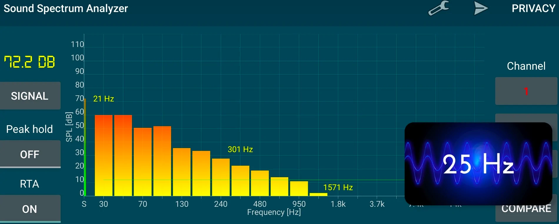

Premium: I turned up the bass at 25 Hz until I started to hear just a hint of distortion. This is the maximum volume the Premium can do without ruining the sound. Obviously, the louder it is, the more distortion you hear. And music without a lot of low bass can be louder (of course) without distortion.
Premium, 25 Hz:
Rivian R1T R1S Meridian vs. Premium Audio: an objective comparison 1760886049379-k2
Subjectively, this is not very loud. I was very disappointed with the inability of the speakers to support the bass being pumped into them. Replacing the speakers with more robust woofers would likely make a big improvement. The distortion definitely sounded like speaker failure, not amp clipping.

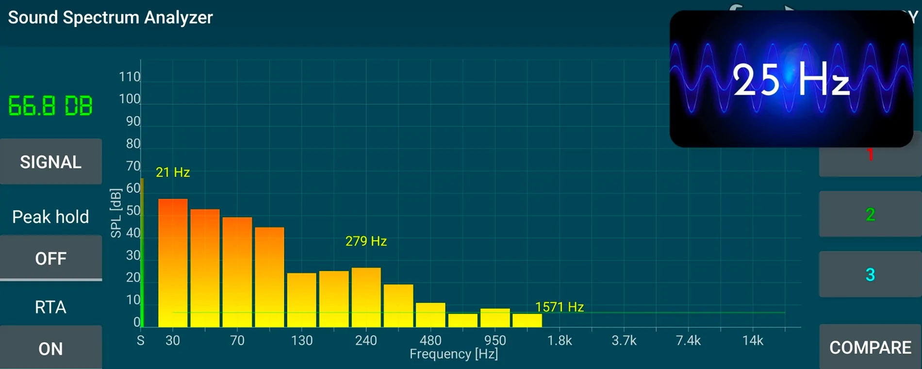

Meridian Comparison:
Unfortunately, I returned the loaner before thinking about cranking the bass up until the failure point. So I was not able to do that test on the Meridian. But I did measure bass volume at a much higher level than the Premium was able to achieve.
Meridian, 25 Hz:
Rivian R1T R1S Meridian vs. Premium Audio: an objective comparison 1760886076766-jr
You can see this is much louder than the Premium. And at this volume level, there was zero bass distortion. It just sounded loud and clean.

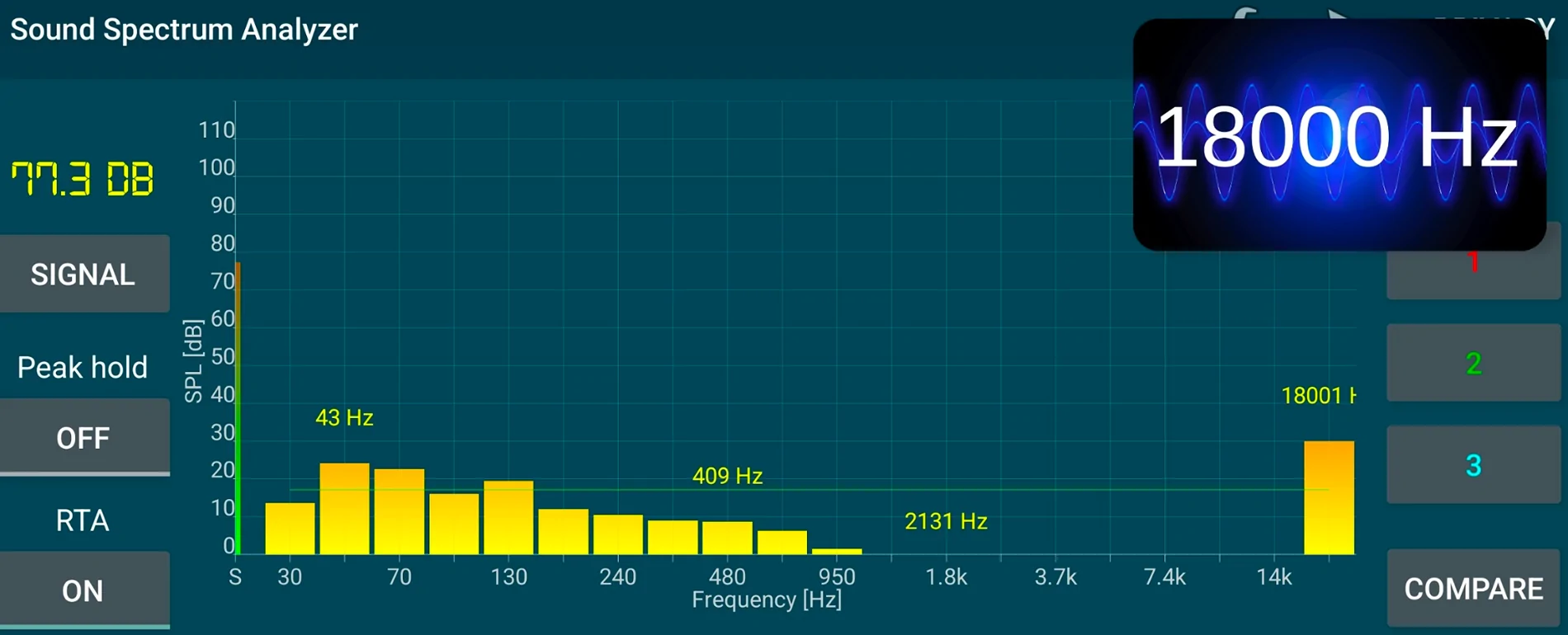

Meridian at 18 kHz:
Rivian R1T R1S Meridian vs. Premium Audio: an objective comparison 1760886138450-ei

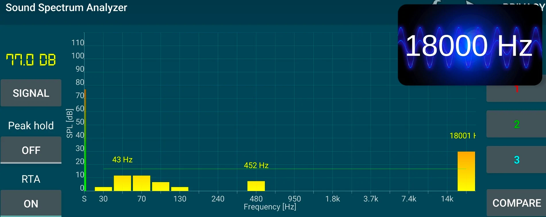

Premium at 18 kHz:
Rivian R1T R1S Meridian vs. Premium Audio: an objective comparison 1760886156957-9j
The 18 kHz response is identical in both systems. (Note the low frequency readings are ambient noise, and not sound reproduced by the systems.)

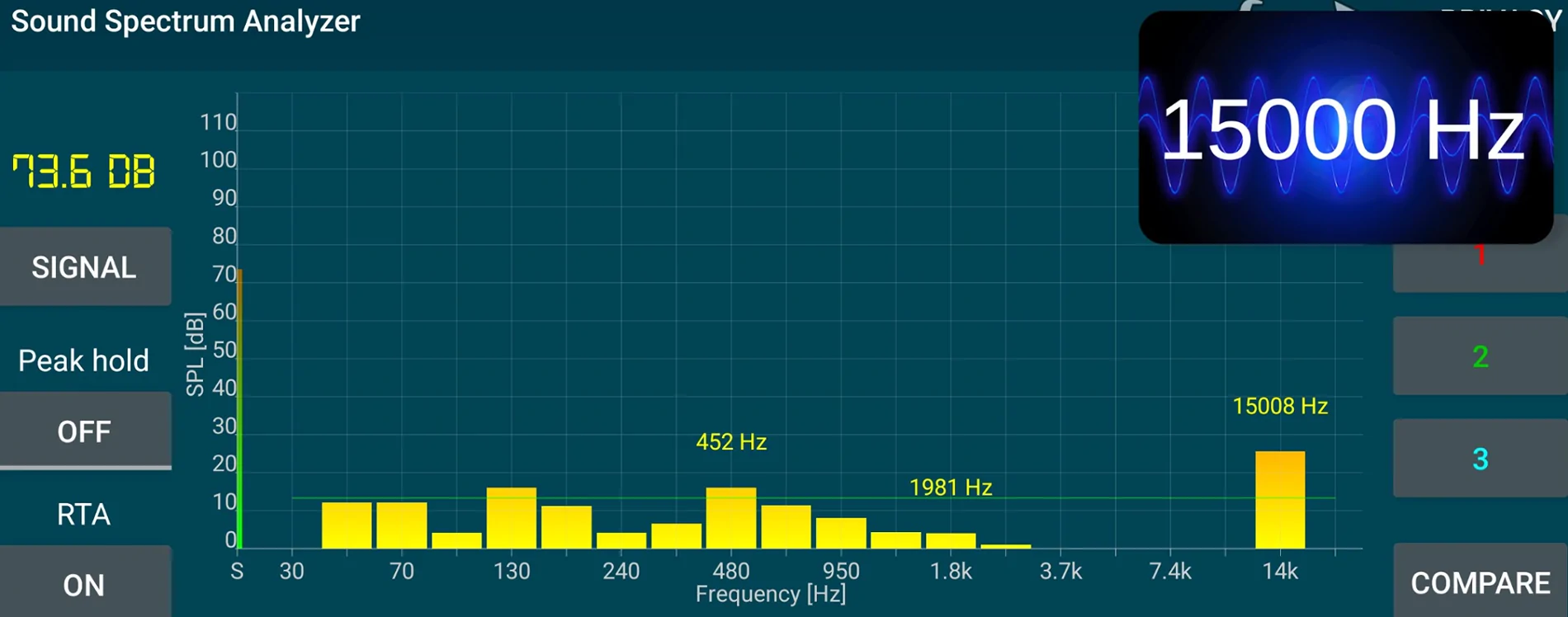

Meridian, 15 kHz:
Rivian R1T R1S Meridian vs. Premium Audio: an objective comparison 1760886174550-p1

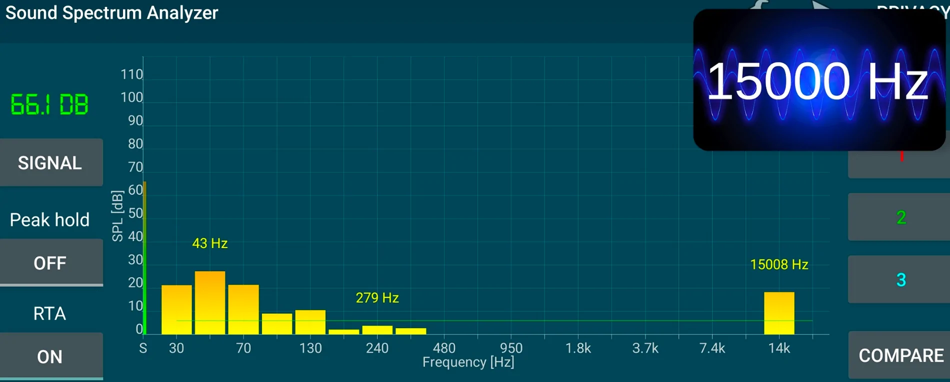

Premium, 15 kHz:
Rivian R1T R1S Meridian vs. Premium Audio: an objective comparison 1760886194924-ga
The Premium has a much stronger volume (~26 dB) at 15 kHz than the Meridian (~19 dB). This seems to confirm my subjective observation that the Premium is clearer at the high end.
Summary:
This testing proves there is a valid bass deficiency in the Premium when compared to the Merridian. This is likely what people have been complaining about. But it also proves the Premium has excellent bass and sound quality at low volumes. If you listen at moderate levels, with a good sound source, you should be very happy with the sound quality of the Premium. If you like concert level volume with strong bass, you won’t be happy at all.
