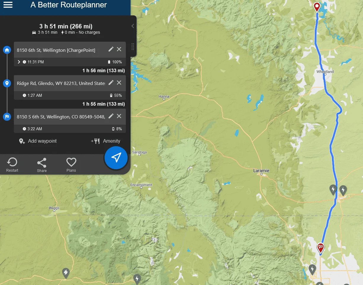

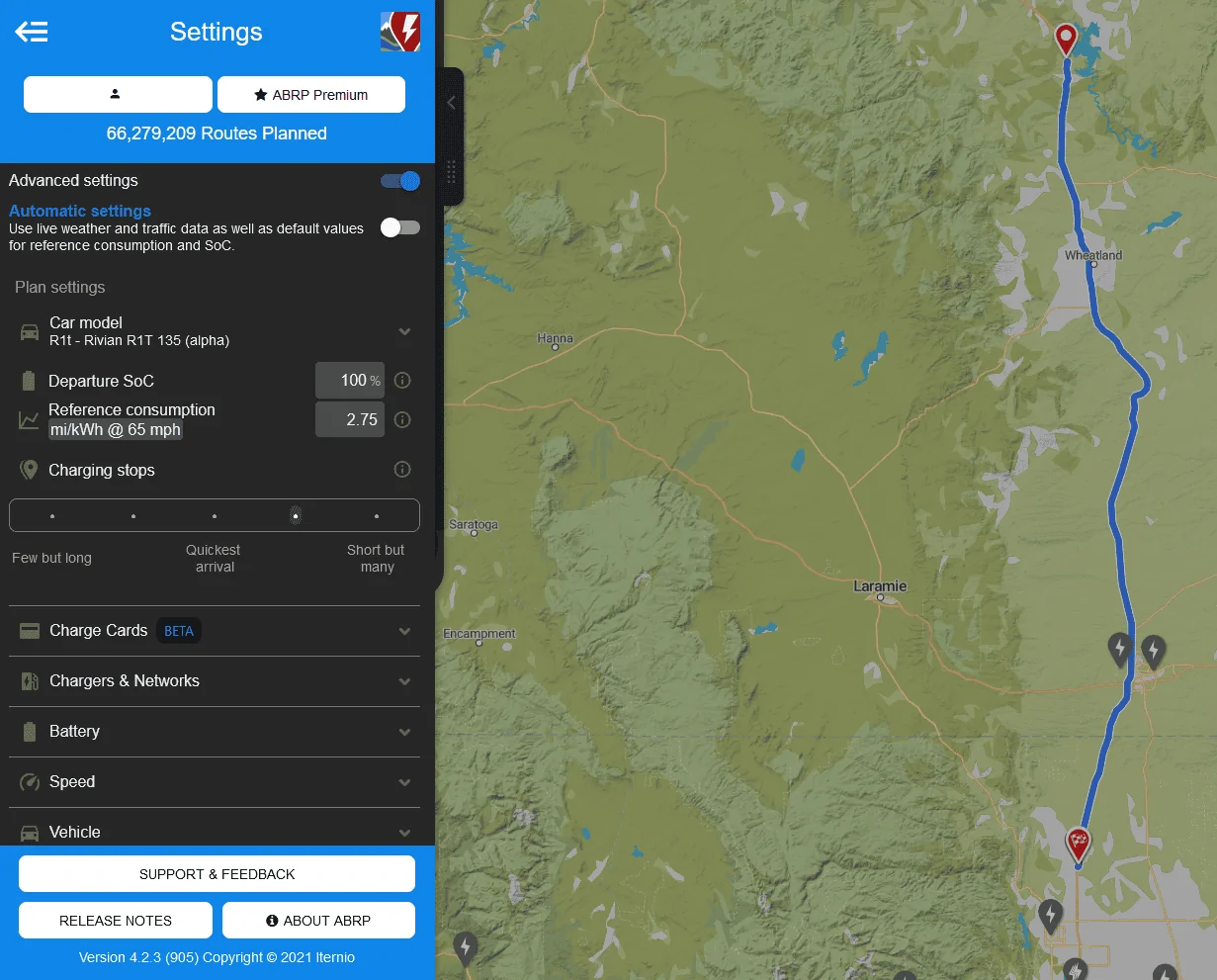

So I was playing with ABRP to try and fit their reference efficiency at 65 mph to match Kyle's range test. It looks like ABRP is assuming about 122kwh usable.
To achieve 289 miles of range at 70 mph I had to use a reference consumption of 2.75 mi/kwh @ 65 mph.
Last I checked, the charging curve they have is too slow at the moment. I plan to prod them about it whenever Rivian issues some fixes for thermal management. For now, it seems better to . assume it charges slower than not. If you're trying to estimate drive times though just be cognizant of this, and consider that you might be better off doing the math yourself.

ABRP currently assumes 474 Wh/mi consumption at 65 mph for the Large R1T. You can set that to anything you like, however.
As for charging speed it seems to assume 0.95C to 1C depending on the SoC span covered in the charging session. This has to be a WAG as there is no way it can possibly know what charge curve the truck will ask for during a particular charging session.
You can ask it to use real time weather data along the route which would tweak the consumption and, I suppose, but do not know this to be the case, the C rate. It has topo data and so can adjust consumption for grade. Nevertheless it can never be more than a planning tool
