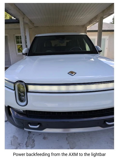

Yeah, that can cause issues as well. Generally recommended to use either fusetap OR AXM power, but not both at the same time. Using both has the potential to send power feedback through both systems.
