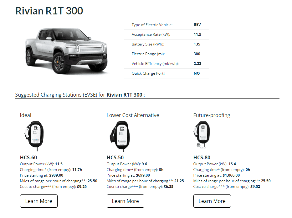

I have a Clipper Creek that I bought a week or so after I got my 2019 Kia Niro EV. Not the latest and greatest but works fine with my R1T. If you're charging overnight, how many miles added per hour do you really need? BTW: I did not go hardwired; if the unit ever goes out or I want to upgrade, I want to avoid expensive electrician visits if possible. Current from Clipper Creek:
Rivian R1T R1S Advice on the best universal wall charger 1649383941813
For me, the delta to go from 21.25mi/hour of charge to 25.5/hour of charge isn't worth it, but to each....
Last point, these folks are easy to deal with and actually answer questions.

Can any current vehicles even go over 11.5 kw (the hcs-60, 48 amp max like the rivian)? My older tesla model S can use the power from a hcs-80, but for the past few years, tesla went down to 48 amps max and I think that is the limit for level 2, home power charging at this time.

Ford has an 80 amp option for the lightening.

I ran a 60a circuit to my juicebox 40 with a 14-50 NEMA for now. I left a bunch of extra coils of wire in a junction box elsewhere in the run. I will hardwire the rivian charger in once the truck arrives.
I think the juicebox has a decent app and has been pretty reliable for me.
