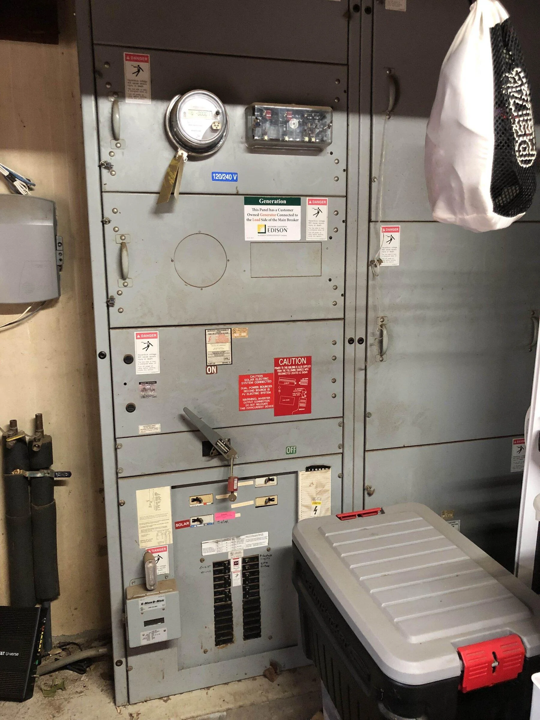

I have a Tesla charger but I'm adding a Chargepoint HomeFlex - Hard Wired. I also have an adapter for my Tesla charger. Will have 2 EVs soon and want to make sure I have 2 chargers always available at the highest rate I can get.
We have a lot of power coming in to our property and I still need to get my head around it all. I'm hoping one day in the near future I can set up Level 3 charging here but the cost is too prohibitive at the moment.
This is the main panel which feeds a bunch of other sub panels and I have only a rudimentary understating of how it all works. My goal for this year is to learn a lot more about my this system and how we can maximize our electrical efficiency.
Rivian R1T R1S Advice on the best universal wall charger IMG_3075_panel
