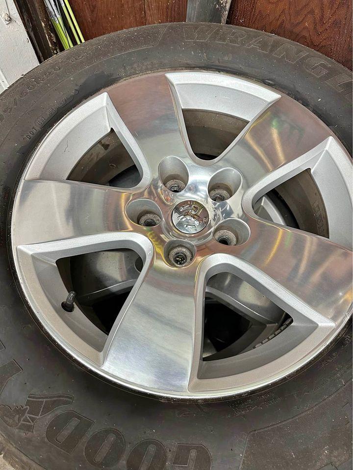

Question,
‘We’ve discussed the 2363 wheels for winter snow tire use. I found a set that looks like the ones shown in this forum only chrome. Is it safe to assume that they will fit my R1S?
Has anyone used the chrome and if so is the stamped number on the wheel the same?
Thanks
James
JAMES
Mar 11, 2020
53
Syracuse
MDX, ACCORD
Retired Teacher, Reading Coach
These are what I found wit Goodyear AT tires.

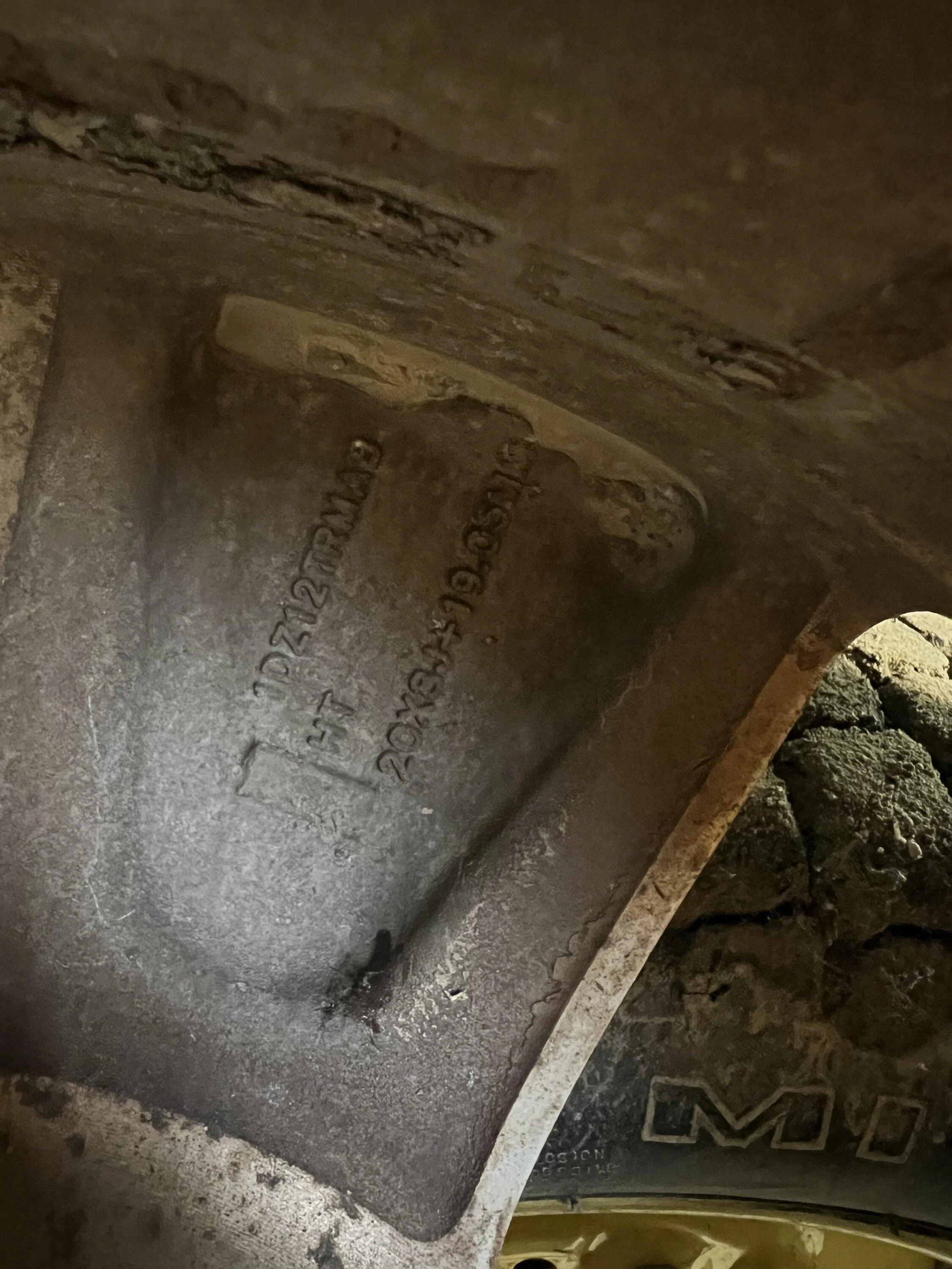

But if you're able, will you take some pictures of the inside barrel? I remember seeing some information on there (manufacturer date, etc.) on mine. But I forgot to take pictures and don't remember if it had a wheel load reading on there.

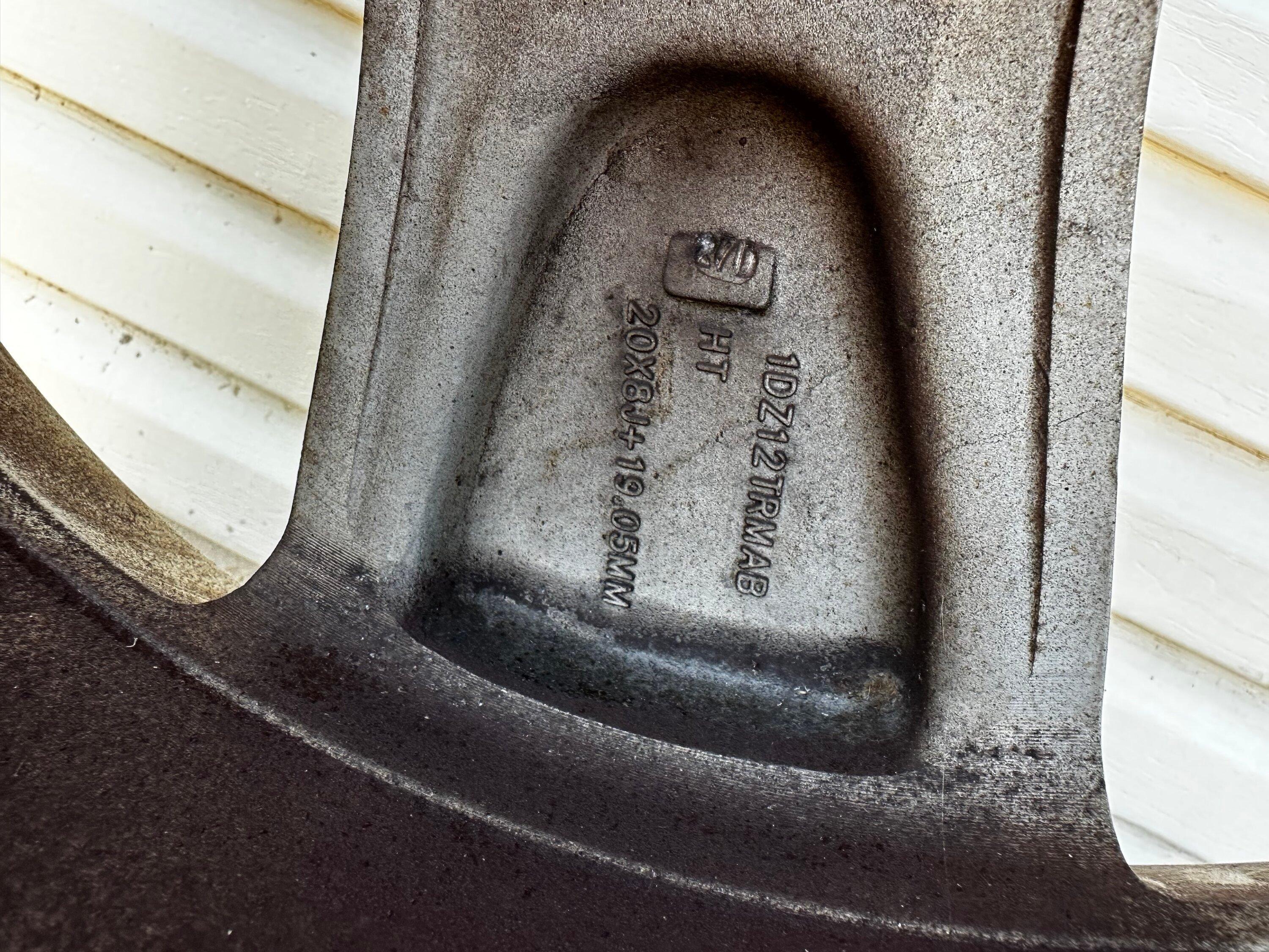

Here is a photo someone else posted in this thread and a dirtier photo my seller sent.
Sadly no load ratings on these ones.

Thanks, I've got those photos of the back of the spokes though.
I'm talking about markings on the barrel 'under the tire'. Mine had bunch but I didn't get photos and suspect they'll be gone following powder coating.
