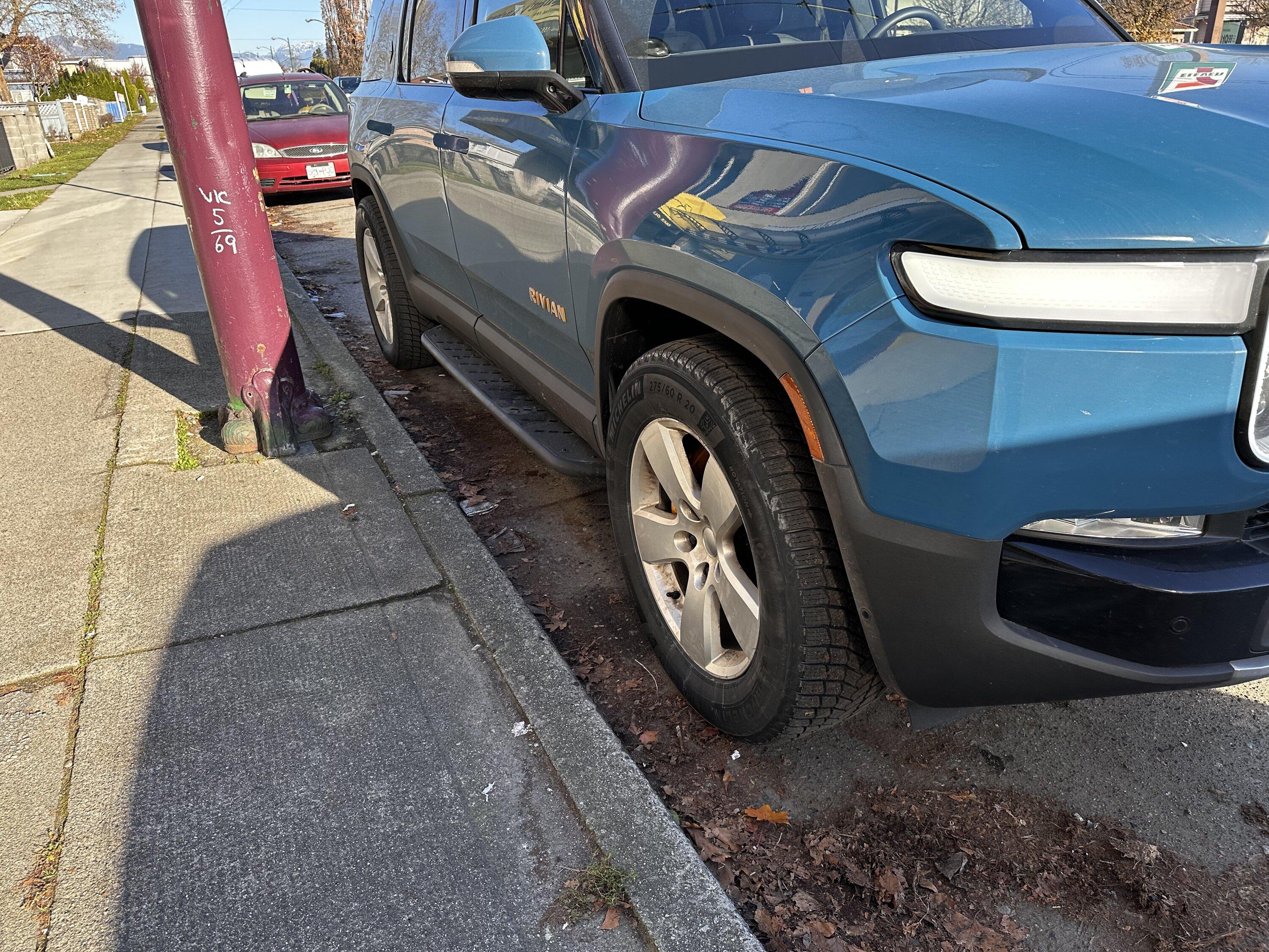

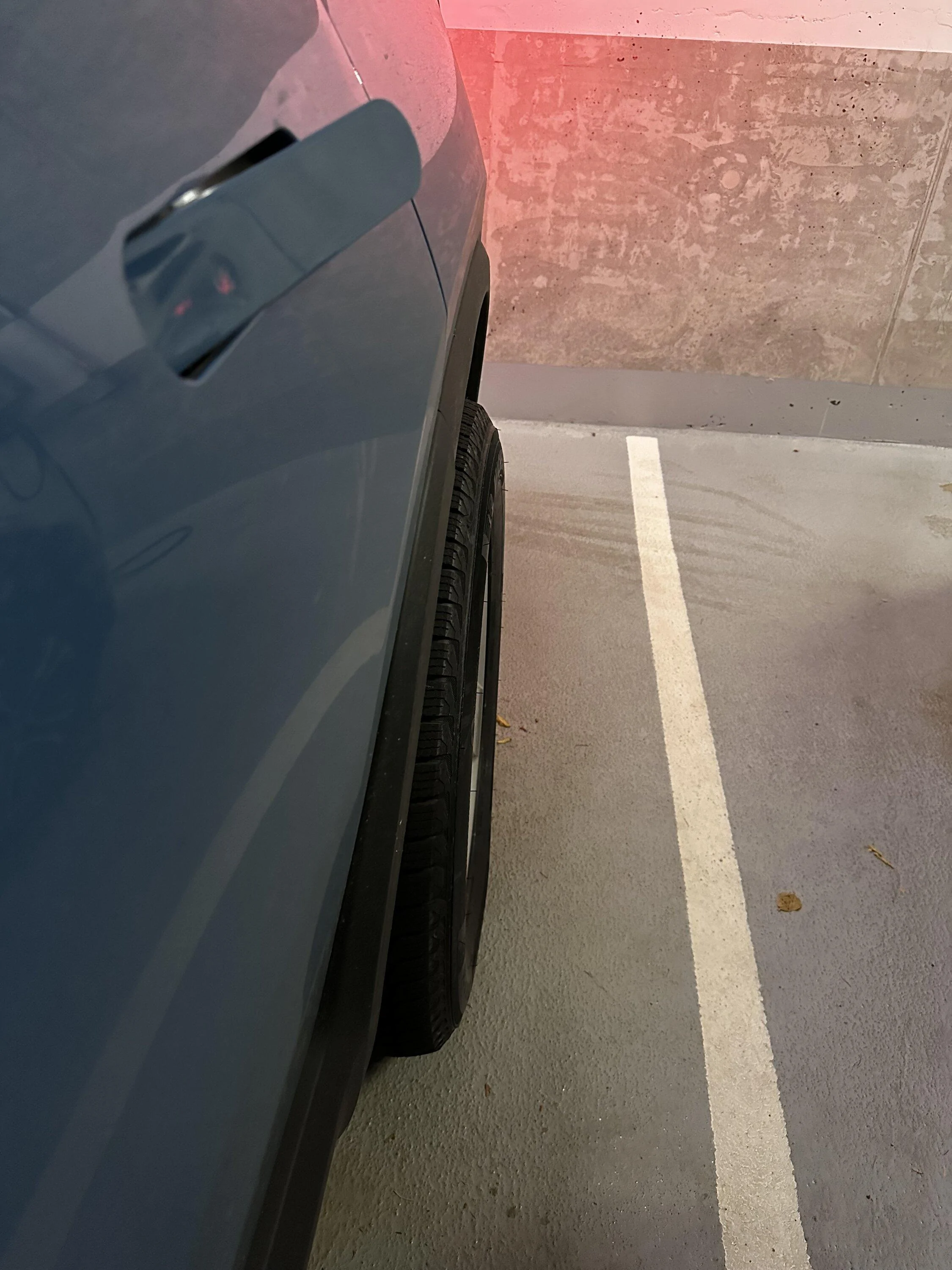

I don’t have any pics on me at the moment but I just put on 275/60/20 Michelin Xice Snow SUVS and they seriously poke out!
Are these particular winters known for having very chubby sidewalls? Cuz I can clearly see them rolling in the side mirrors when I’m driving (which is a cool sight anyways)

On the 2363s? If so, it's the endless not your tires, they sit wider. Power squat

What size tires? That's so odd, I have zero rubbing with 275/60/20 ATs even in low. I forgot I had different tires/wheels on the other day and had to pull a fast one on a jerk, so I threw it in sport and zipped out.
I have the ATs, so obviously went with 275/65/20. They're 34s rather than the 33s for the folks with 21s and 22s.

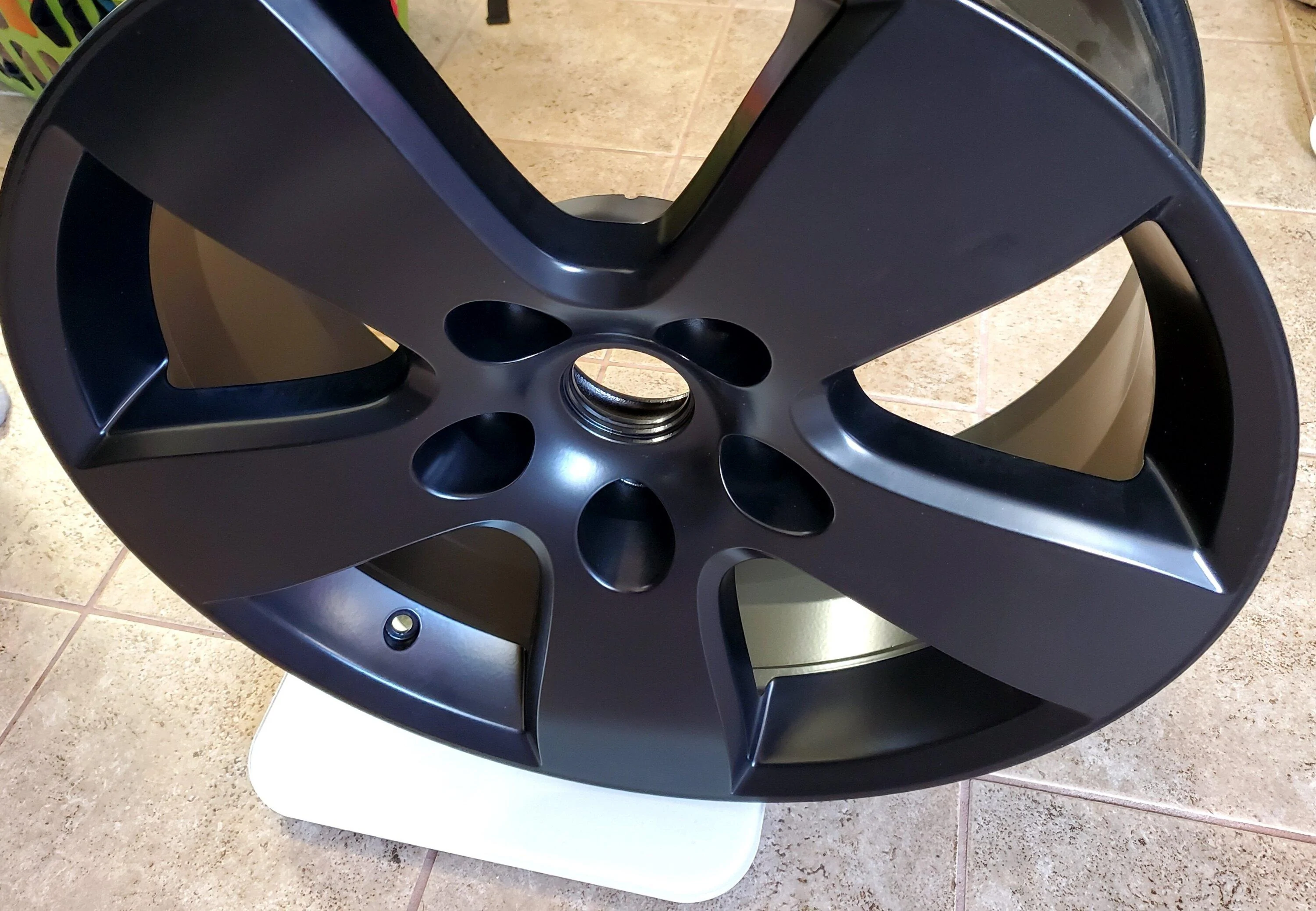

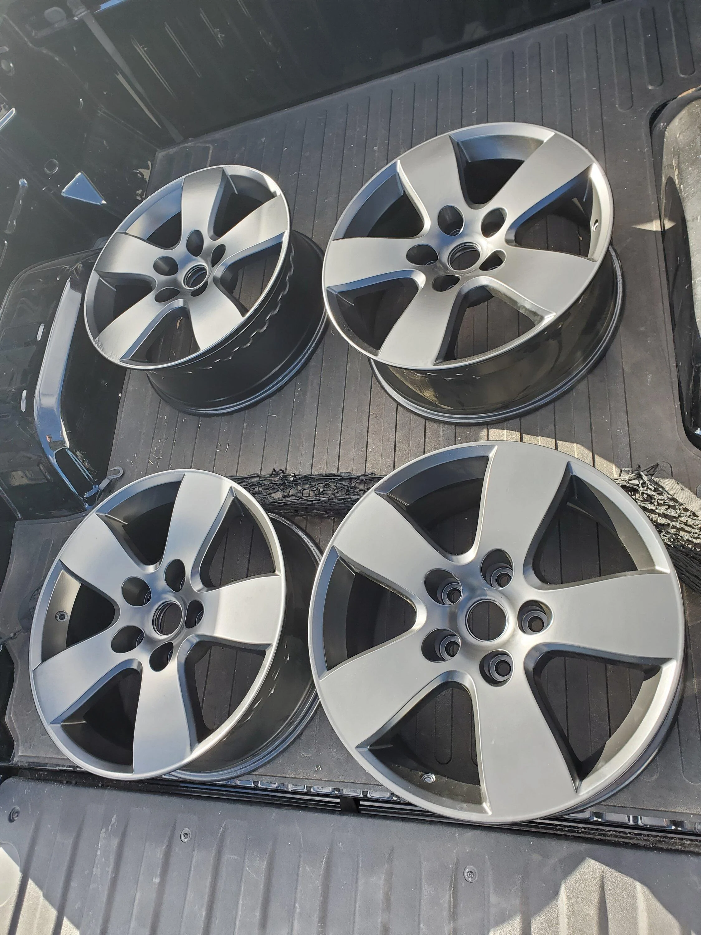

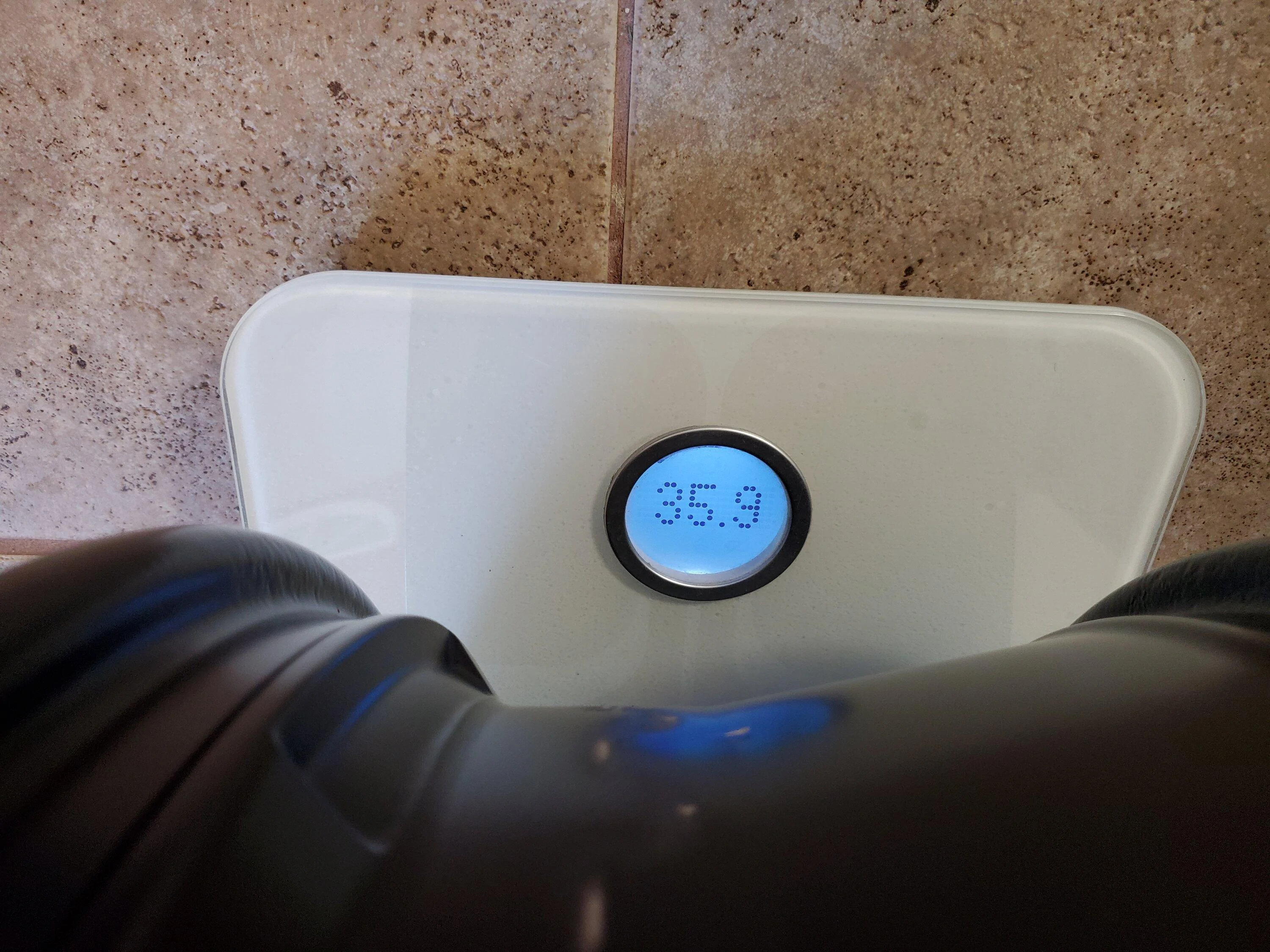

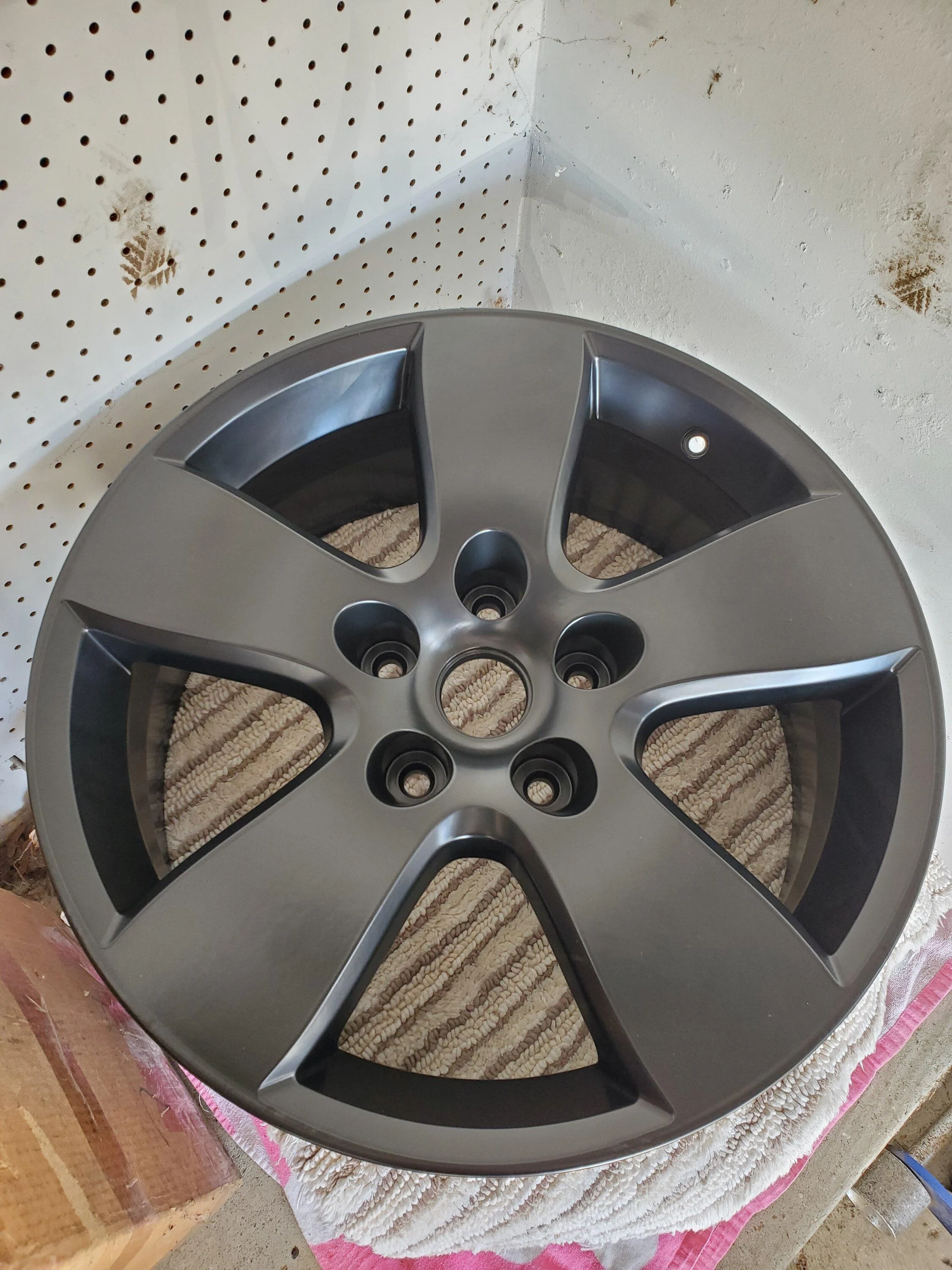

Update following powder coating. Color is satin black but looks pretty light on direct sunlight. Coating didn't add too much weight.
Rivian R1T R1S Affordable Winter Wheels Setup: Ram 2363 20231124_134102
Rivian R1T R1S Affordable Winter Wheels Setup: Ram 2363 20231124_134800
Rivian R1T R1S Affordable Winter Wheels Setup: Ram 2363 20231124_135356
Rivian R1T R1S Affordable Winter Wheels Setup: Ram 2363 20231124_145904

But it's the same size as the OEM 20s...
Exactly. I'd thought some folks with the 20s from the factory had done the RAM wheels, but maybe I thought wrong. The wheels do poke out more, so I suspect they're rubbing on the plastics at the top of the wheel well. I'll probably run them this season and then get one of the aftermarket options that have the stock +48 offset next year.

Exactly, offset may cause it. Works great with 33" though.

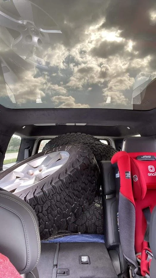

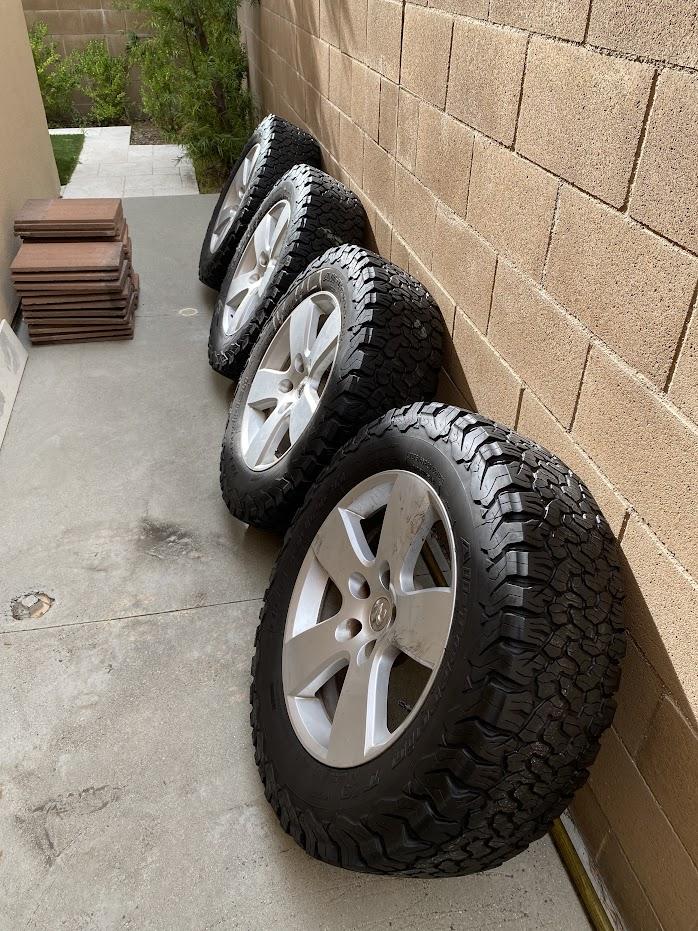

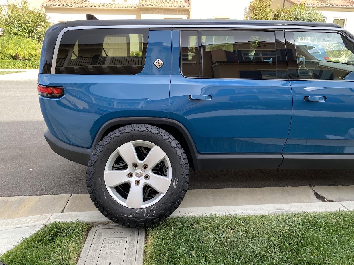

Got a set of moderately used BFGoodrich KO2s for $250 mounted and balanced. Advertised for $350, but guy said $250 so I didn't complain. They were 2019 and 2020 dated tires. Will be fine for my uses, which is probably less than 4-5 times a year.
With a child seat behind the front passenger, it was pretty tough getting things in while being careful not to damage anything. Had to really force that bottom tailgate closed.
I bought some cheap graphite/gunmetal wheel paint and some Sharpie branded white tire lettering markers. :p Will play around over the next few weeks. Also picked up some jack pucks to go with my 3 ton so I can start using them.
Rivian R1T R1S Affordable Winter Wheels Setup: Ram 2363 75CB16C0-0E9B-4EC5-8F3B-8EF2755D90DA
These might be chunky bois. :p
Rivian R1T R1S Affordable Winter Wheels Setup: Ram 2363 B333F577-4465-4D85-A8EA-C95F44EC1E93
Rivian R1T R1S Affordable Winter Wheels Setup: Ram 2363 C95932C5-8A29-48E4-80EC-8641946FB8FC (1)
