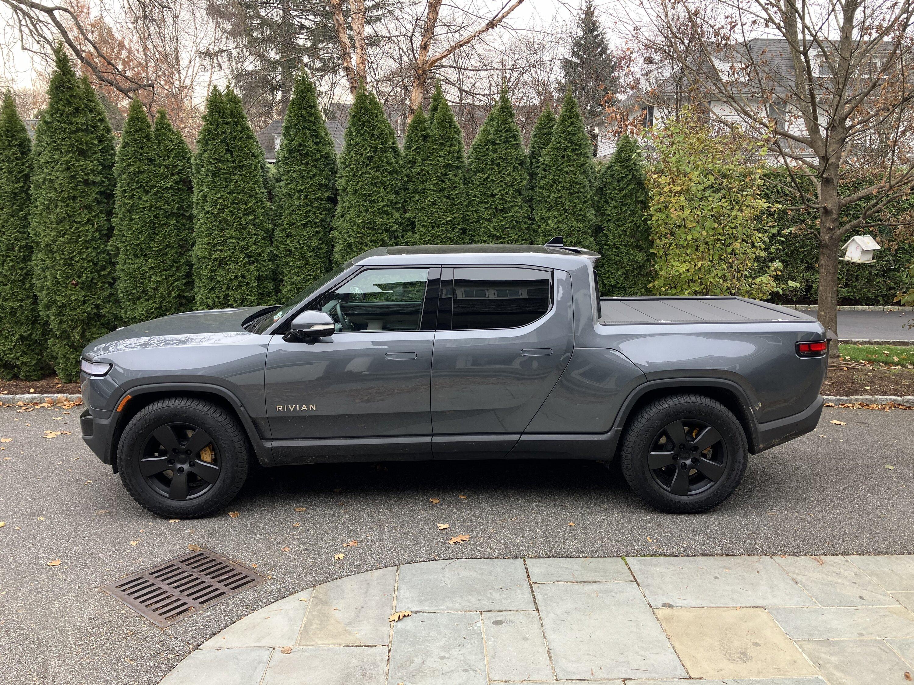

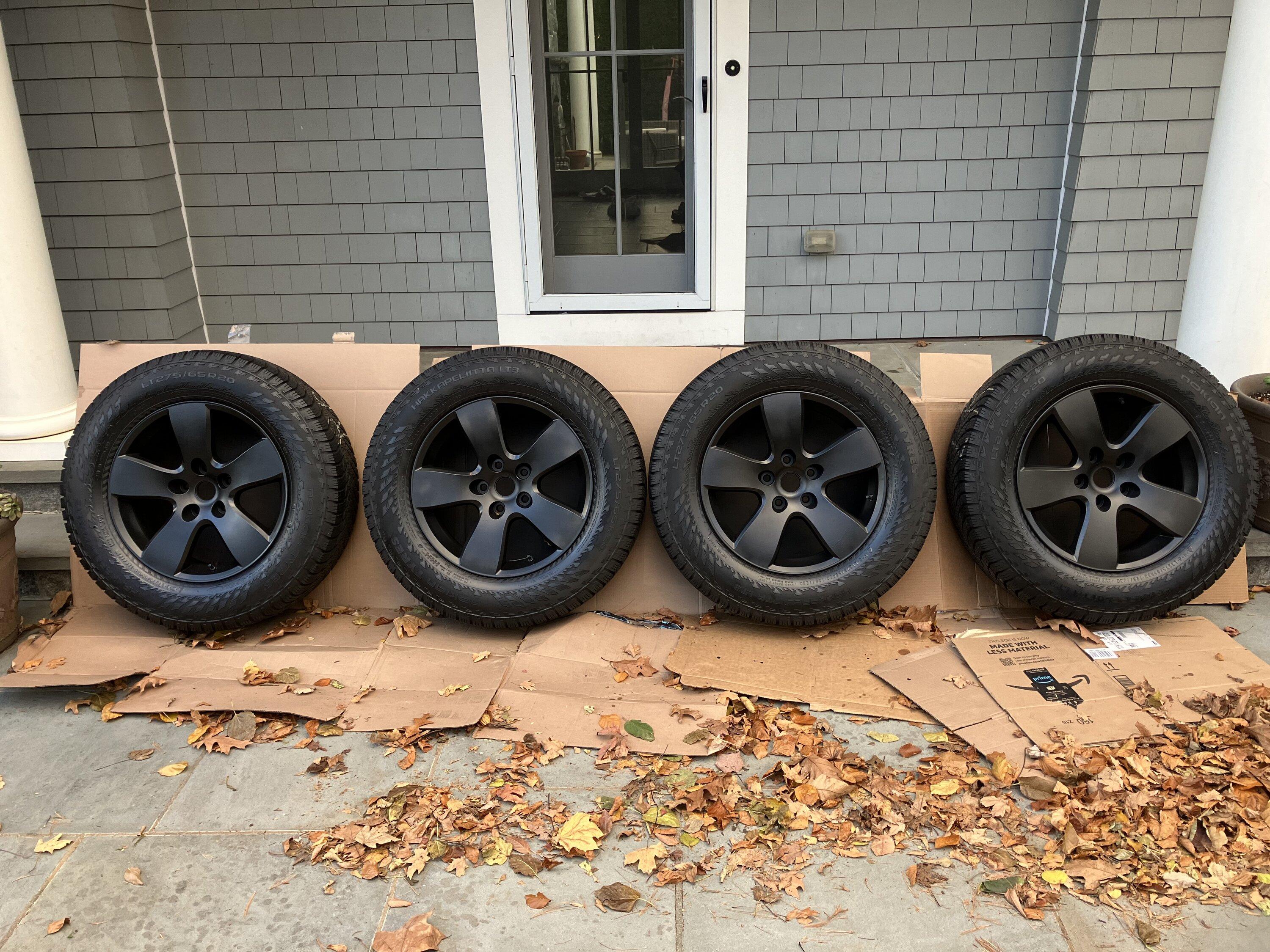

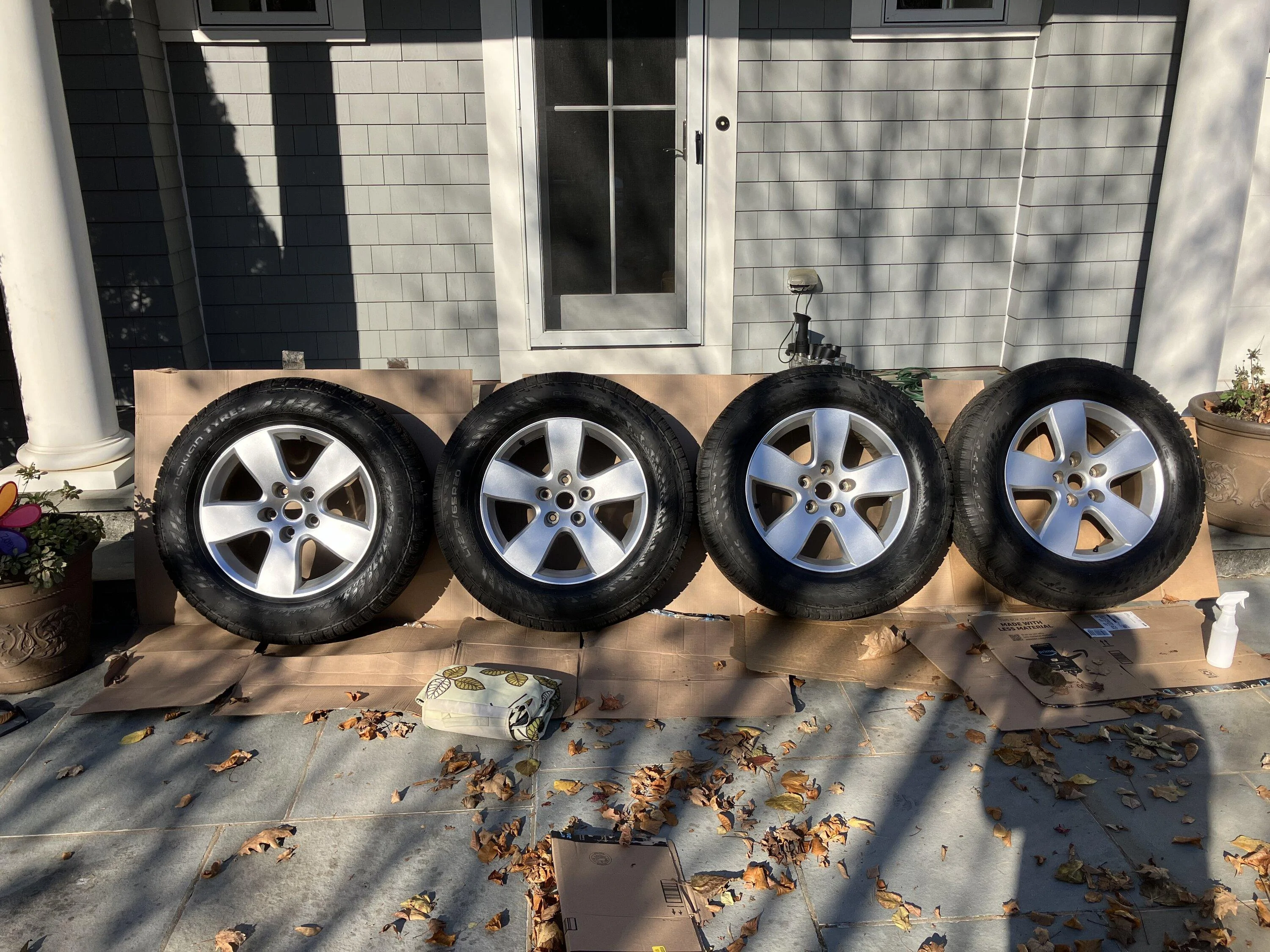

Hi all! After following this and other threads for about a year, I finally mounted my winter set up yesterday. I found Hakka LT3’s that were used by a Rivian owner for one season before selling his truck. Otherwise, I used all of the items that are commonly listed. The Amazon preprogrammed Rivian TPMS sensors were picked up by the truck after a couple minutes of driving. The hub rings were a little snug going into the wheels but tapped in easily with a mallet. I did buy and use Permatex 80078 Anti-Seize on the rings with the hope that they will come off of the truck easily after the winter. Thanks to Riviot for the stickers for the new center caps. I was debating powdercoating but felt it was too expensive around where I live for wheels that I am uncertain I will use forever. So I used Hyperdip, I could have done a better job but I’m happy with the results for now. The only issue that I ran into was that the front suspension was too low after changing the wheels. I don’t see how the issue would be related to the wheels. I followed tire change guidance of off road high and tire change setting before swapping out my 20 brights. It seems to have eventually resolved itself after some changes back and forth between heights, a hard reset, and a highway drive.

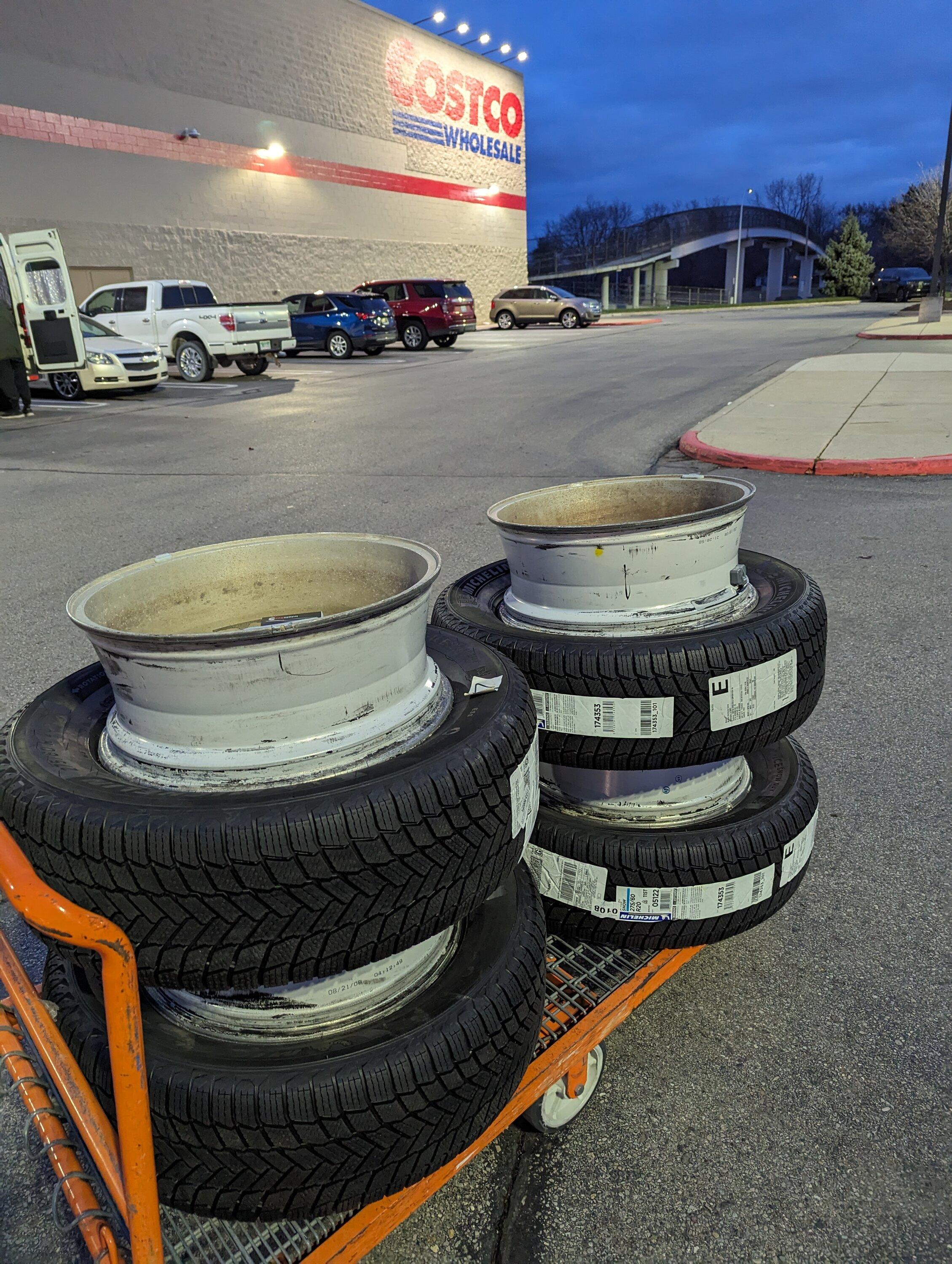

Sigh, Costco let me down again.
I have all the parts, now I need a tire shop that'll install my TPMS. Apparently 4 years ago Costco made it policy to only install TPMS they sell you.
Love Costco, but that's pretty annoying when I asked the same tire center specifically if it would be okay while holding my TPMS in front of them last week.
At this point my backordered other wheels are getting closer and closer, maybe I'll just wait it out.
(And the tires are backordered everywhere else now so can't even price match with Tire rack/discount so I did buy the tires anyways)
