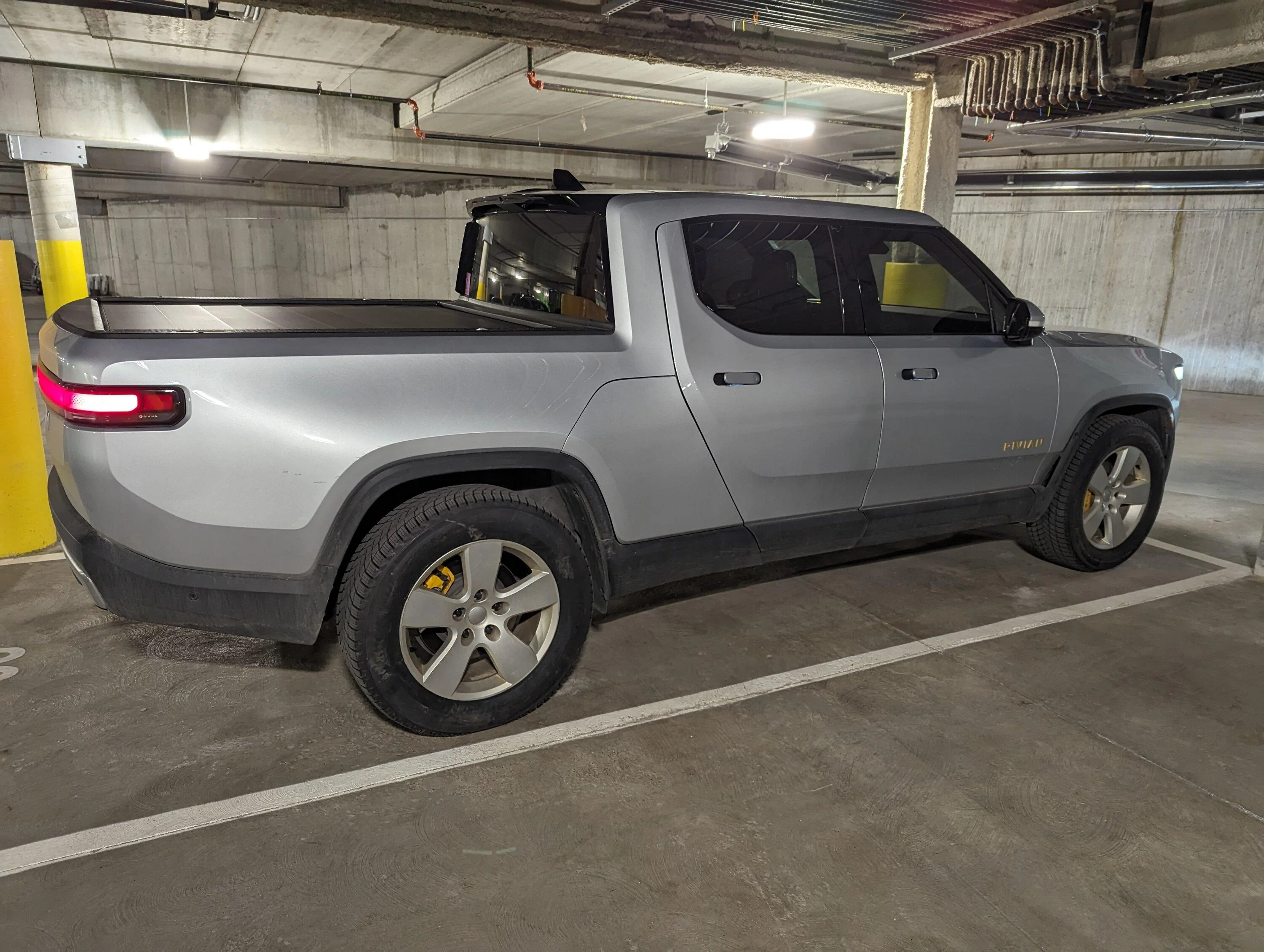

Finally on! Thanks everyone for putting this together. Now I just need to sweet talk service into programming the smaller diameter.
Also, anyone have suggestions how to get the hub centric rings off if/when I need to? I realized while lightly tapping them on (with anti-seize coating) that my stock spare now won't fit if needed.
My plan was PB Blaster with some more tapping and prying with non marring tool.
If I got caught roadside and needed to use my Rivian 20" spare... I've an array of knives, multi tools, and other handheld random items in the gear tunnel and under the backseats that I'd try.
Hmm mine seemed pretty tight on the axel but figured I'd do the same in a pinch. And yet rather loose on the wheel. Not sure they are doing much for me, the wheels had been ground down pretty well in there.
I just used a screwdriver when I switched back in the spring.
We were on an offroading trip with NERC, and a couple of us with these wheels got flats and had to change tires. One had the ring stick in the wheel and needed to pop it out to put back on the hub, and mine stuck to the hub so it was easier for me to change. Either scenario could be fixed by gently prying with a screwdriver.
Did you put a similar size tire on your OE spare? Not sure how the software will like the mismatched sizes if not.
Mine is the same 33" OD, just the original +48 offset so sits in more.
With any different diameter, I'd probably put the spare on the rear axle after seeing all the force and Regen defaulting to the front motors. Is that wrong?
The compact spare is significantly smaller than any of the OE Rivian sizes. It's a T195/70/20, which is 30.7" in diameter vs the 20s at 34" and 21/22s at 33". So it really shouldn't matter since there is no mechanical connection between any of the wheels/motors.
Right. As with any diameter different spare, just gotta do what the wife always says...
I'm keeping my AT as my spare, thought process is similar to above that the doughnuts are usually different diameters so would use it to limp somewhere.
For offroading then it'll match, and for on road it's a lot easier to find a 275/60/20 if I'm on a long trip. Hopefully won't have to use it.
My old 330ci has a full size spare but the only time I've needed it I was stuck with a seized wheel and couldn't get it off anyways. Everything else has no spare or a folding one so I'm not overly particular/reliant on them.
I have an old 1/2 inch wide wood chisel I used and now keep with the jack in the truck. The thin edge can be tapped under the edge of the centering ring so it can be pried off. Break it loose and slowly work your way around the ring until it comes off. The anti seize is important.
