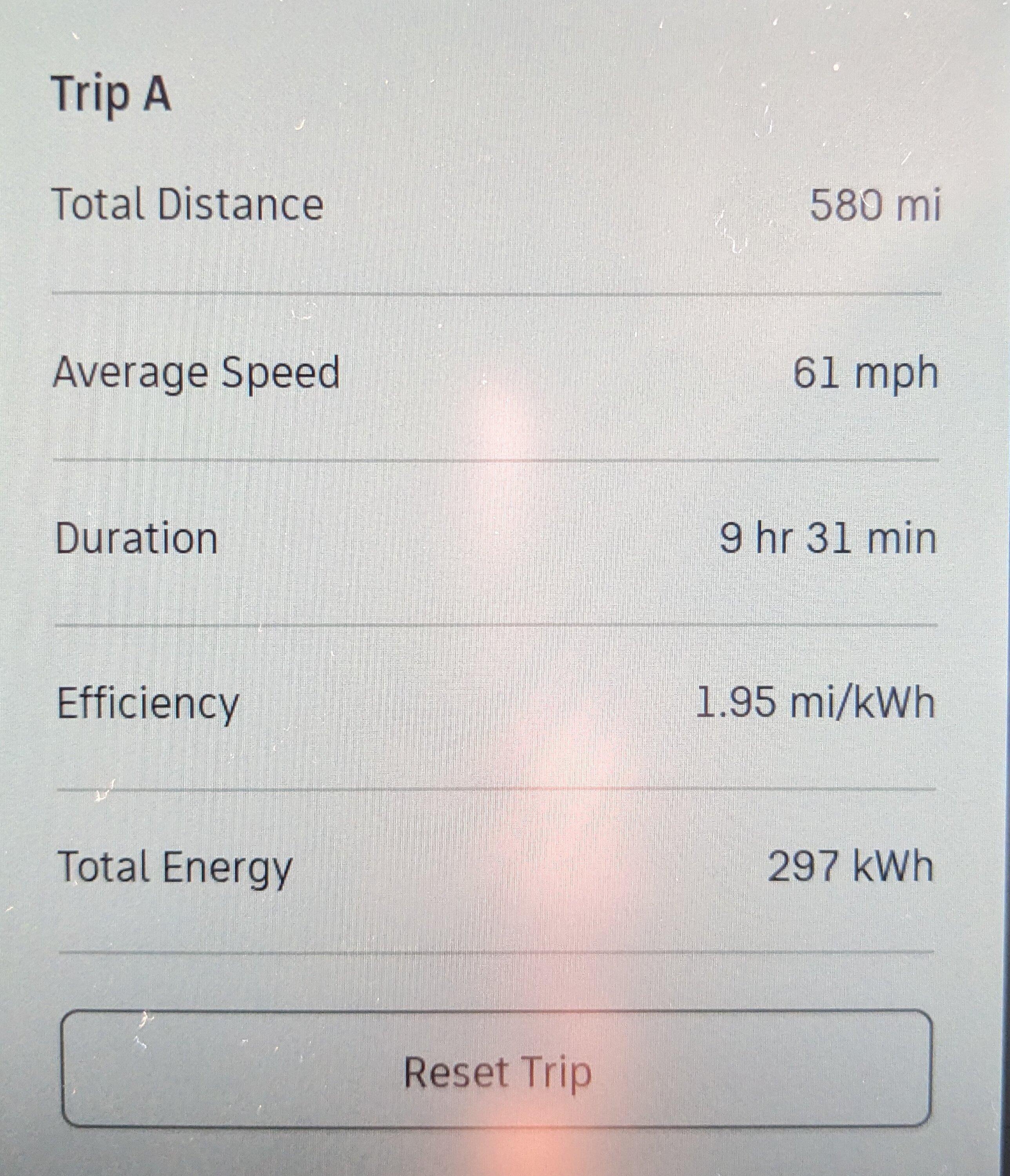

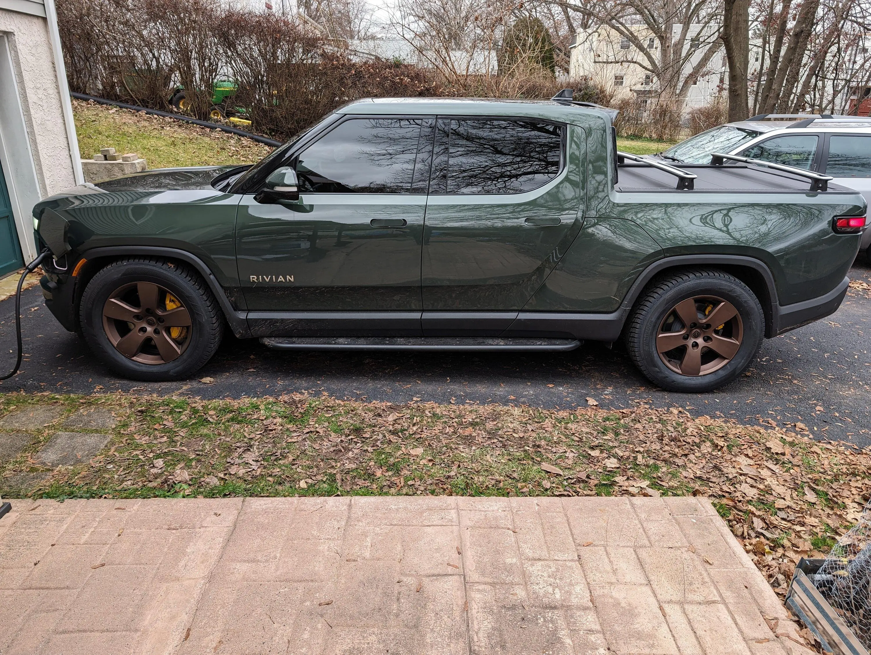

We finished our holiday drive from Seattle area to Montana on the 2363s with 275/60R20 Wildpeaks, and I'm thoroughly impressed with the efficiency! My ABRP number ended at 2.4 for the whole trip, compared to 2.2 with stock ATs on the same trip. We ran the usual conserve/low to compare.
It could've been the mild and dry weather (20s-40s) or a lack of headwind, but it wasn't worse than stock tires and wheels, so that's a win. I've also been paying attention to battery temps more and really credit an 85°F+ battery with good numbers.
I'm excited to see the drive back!

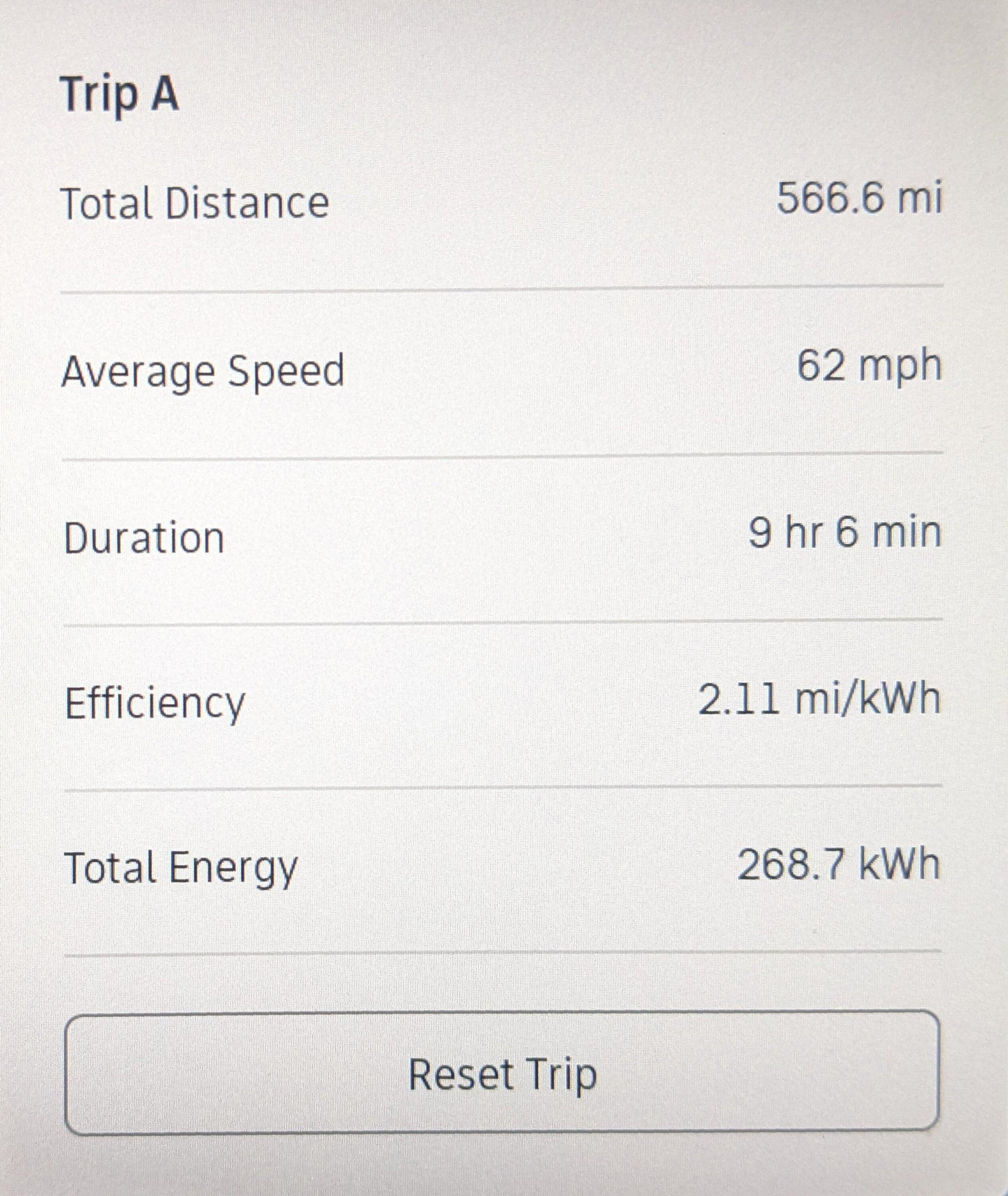

Return trip data below, net downhill with conserve/low on the highways yielded 2.11 mi/kWh. My ABRP number was 2.5 for the return, very impressive! I'm completely sold on 275/60R20 but might switch to Michelin Defenders and run them year-round. Pirelli AS+3 would've done just fine, roads were warm and dry.

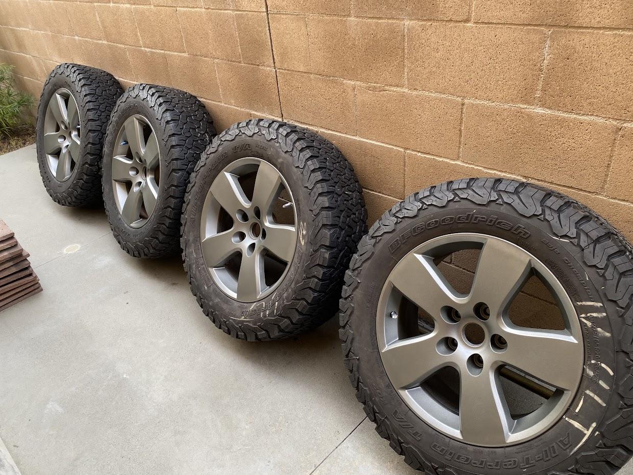

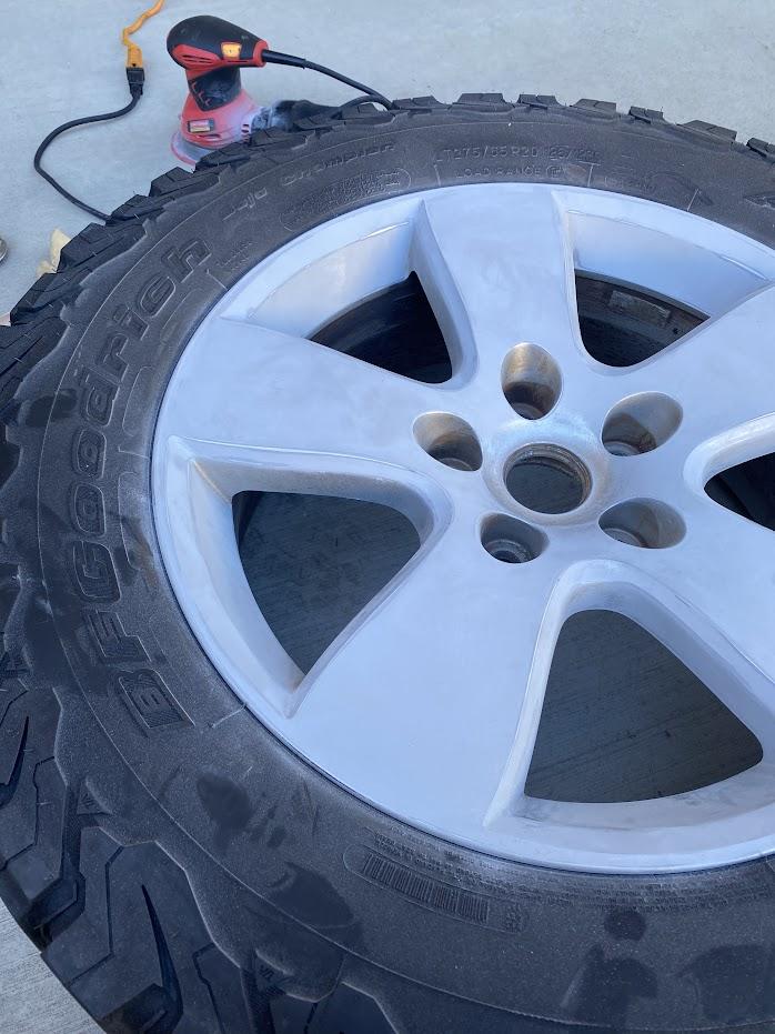

Well I finally took the time this holiday break to get my Ram 2363 wheels ready.

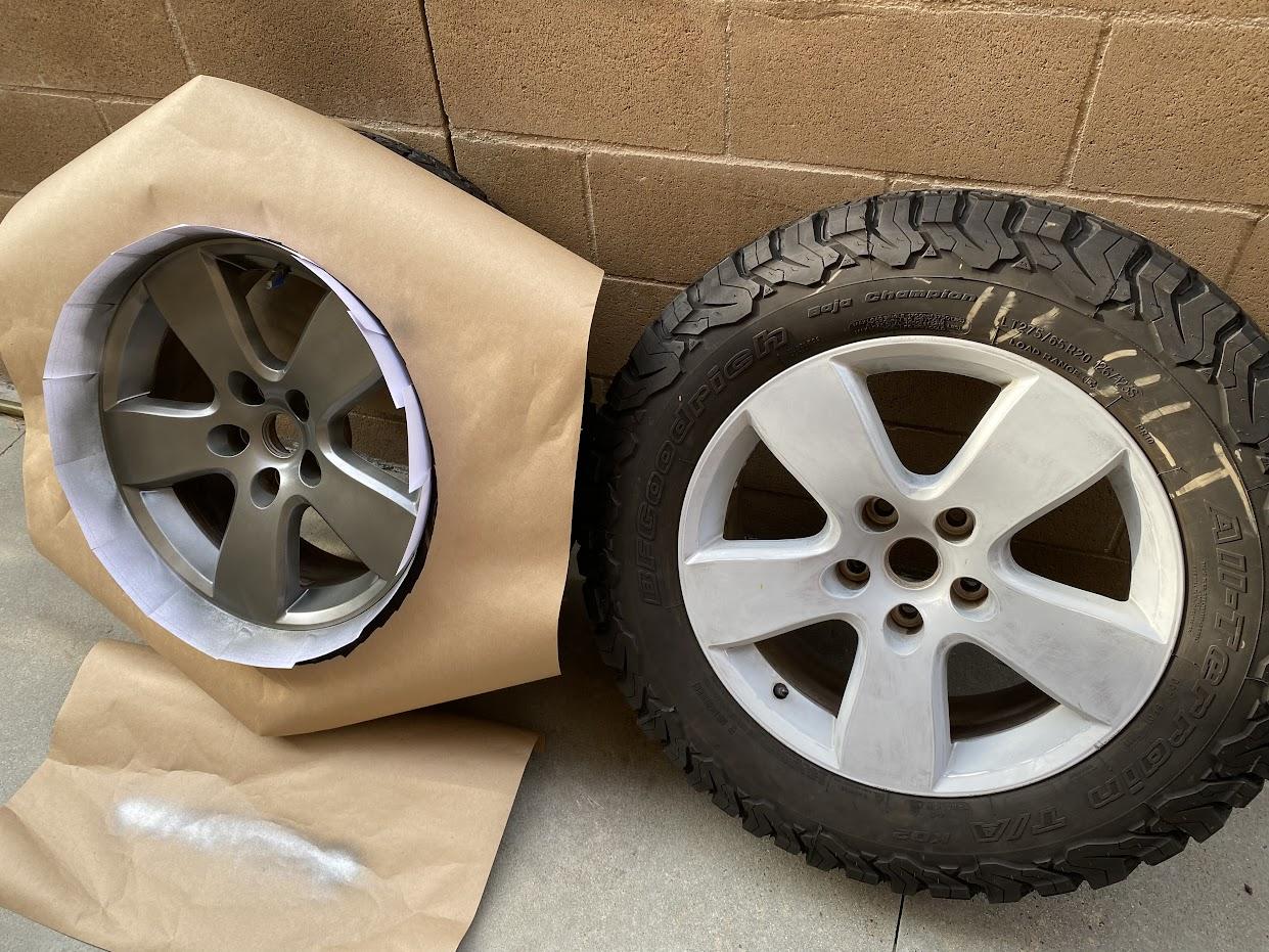

Sanded them at first by hand, got very sore quick haha. Then realized my hand sander worked for 95% of the wheel. The rest went rather quickly.
Picked up a "graphite" wheel spray paint from Amazon which turned out quite nice. I didn't prime or clearcoat since I didn't have the time/want to be bothered for wheels I'll use <5 times a year for a few days at a time.
Rivian R1T R1S Affordable Winter Wheels Setup: Ram 2363 B7834BDD-72EB-4884-AF3A-6F0CCDCC8C97
Painted vs. sanded. Left one has about 2 coats. I did 3-4 at the end.
Rivian R1T R1S Affordable Winter Wheels Setup: Ram 2363 C638217B-892E-41A0-BF64-B17A72955A77
Came out quite nice. After driving a few hundred miles, they held up nicely even through some sandy areas. I'm still missing center caps. Need to figure out which ones fit. Anyone know?

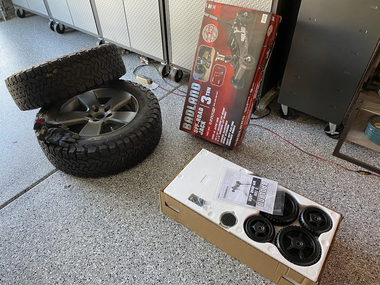

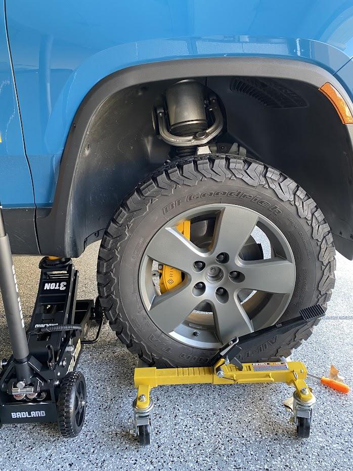

I did splurge a bit and picked up the Badland jack from Harbor Freight. I had a 1.5 ton aluminum and a Pittsburg 2.5 ton that was slowly leaking fluid. So why not treat myself. :)
Rivian R1T R1S Affordable Winter Wheels Setup: Ram 2363 4D9D2F96-048F-4694-9500-E1F3D4F5AF1B
It was easy to see how out-of-shape I was since these wheels/tires are sooooo heavy. Luckily I had one of these wheel jack/dolly things to lift and line up the lugs. They're noticeably heavier than the OEM 22" setup.

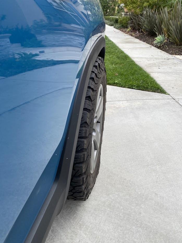

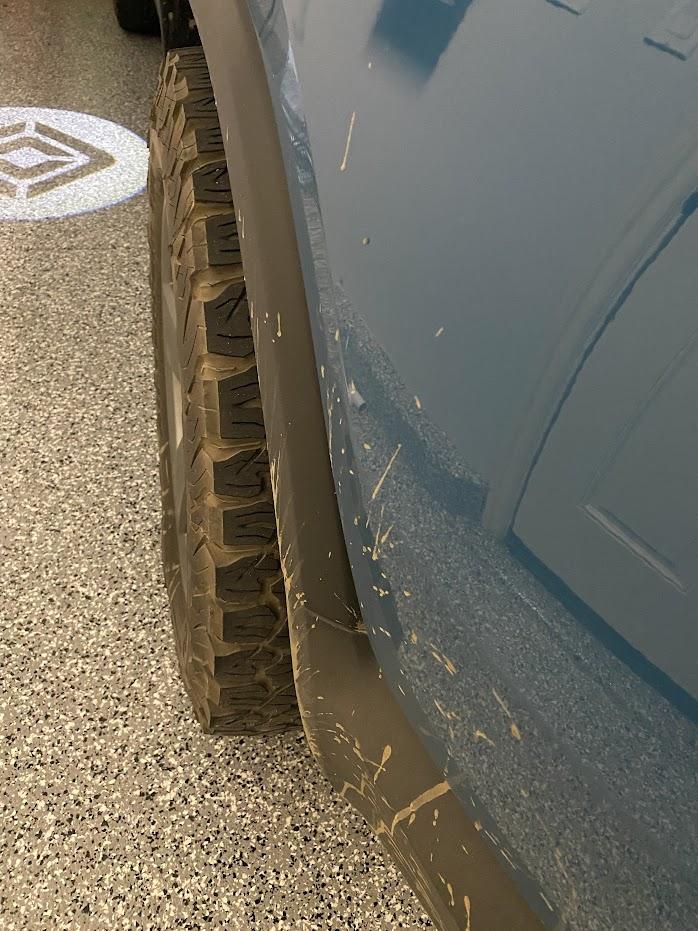

One minor (maybe not so minor?) thing I noticed. Driver's side tires poke out a tiny bit more than the passenger side. I double checked and offsets for all wheels are the same (not staggered on the Ram). I wonder what it is.
Rivian R1T R1S Affordable Winter Wheels Setup: Ram 2363 D90C63E6-8055-4F87-AF9A-295036A3FDDA
This is same side (I wish I got a pic of the other side) but lifted up a bit since I was on an incline.
Anyone know why the tire would seem to poke out a bit more on one side?
Rivian R1T R1S Affordable Winter Wheels Setup: Ram 2363 38FC41D2-C2B4-46BF-B6FA-C039742C4F47
