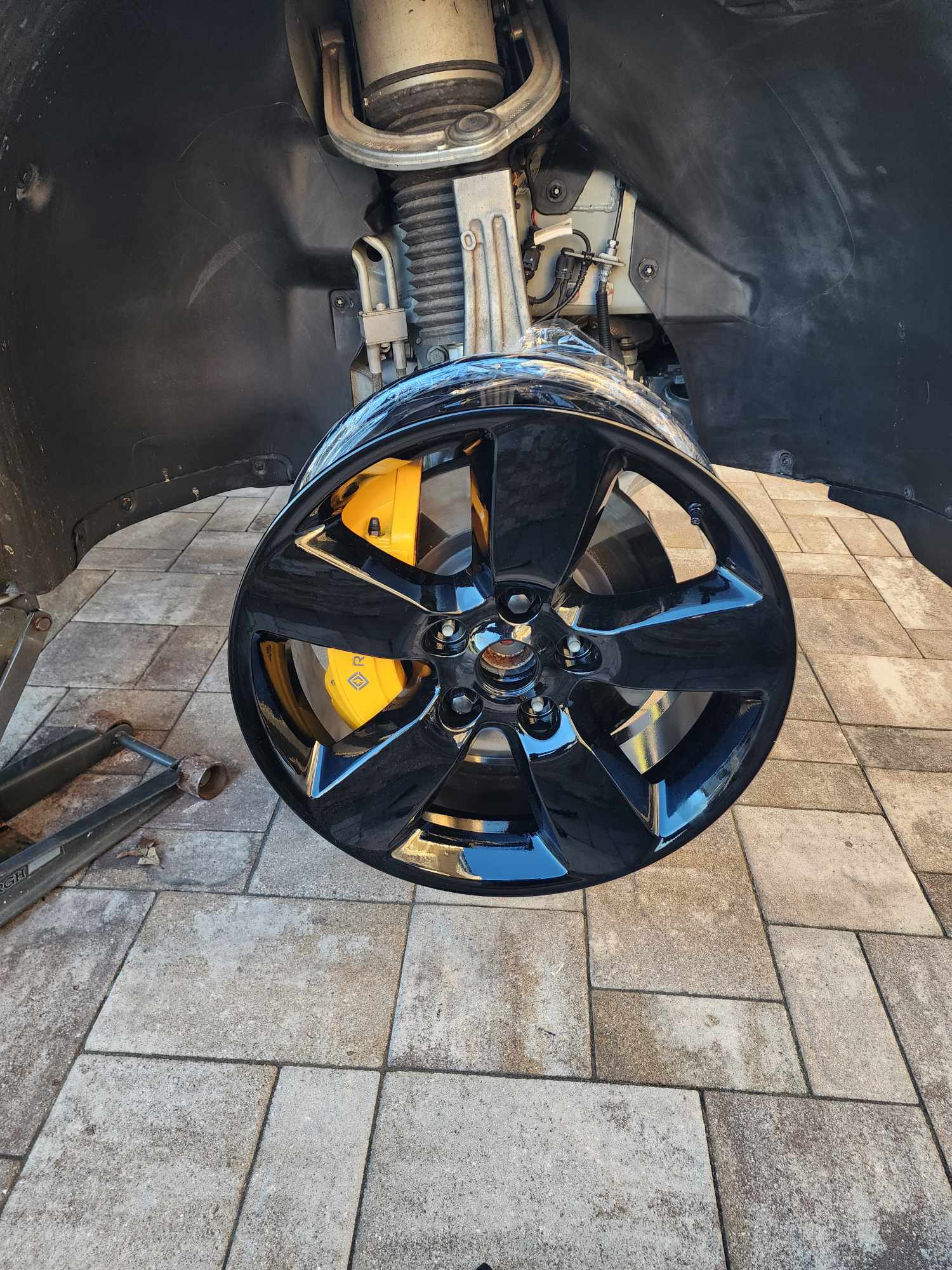

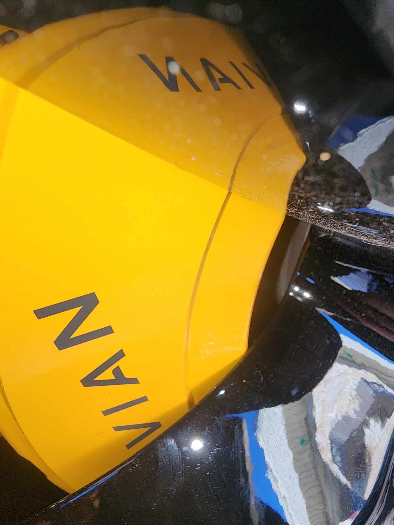

FYI, on the Facebook Rivian group, someone tried these 20" Dodge Ram models. They appear very similar to the "correct" 2363 wheels so take note. A lot of folks on the FB groups are thinking they scored when they find these.
They contact the front caliper, but clear with only a 1/4" spacer. I didn't have too much interaction with him (he sent me some photos and a short video), but I indicated my concern to him that he would still need a hub centric ring so the weight of the wheel/vehicle rests on the hub. I don't know how that works along with a 1/4" spacer plus with slightly less lug tightening rotations on a heavy Rivian.
Anyway, thought I'd share.
Rivian R1T R1S Affordable Winter Wheels Setup: Ram 2363 2451u45-black-dodge-ram-1500-replica-wheels-rims-2451-1ub17gsaaa__80513
Some pics he sent me:
Rivian R1T R1S Affordable Winter Wheels Setup: Ram 2363 404052917_378484004865369_1935342182871498650_n
You can see the contact here in the front.
Rivian R1T R1S Affordable Winter Wheels Setup: Ram 2363 404646295_1035230631100754_6355220006569589612_n
These are definitely the WRONG ones and do not work. I'm okay with hub centric ring, I'm not okay with spacers. I highly suggest not trying these wheels.

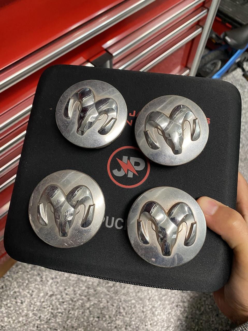

In a funny coincidence, I purchased a 08 ram 1500 (with a rare manual trans!) to be my winter vehicle, and I just picked up yet another set of 2363 wheels to throw on this truck, but keeping it in the back of my mind that I can use on my Rivian someday.
if anyone going down this route has the dodge center caps, I’d take them off your hands.
I got them for ya! They're obviously older and need a wipe down, but they're yours.
PM me and we can figure out shipping. My wife has a corp FedEx account and I can probably get it to you for just a few bucks.
