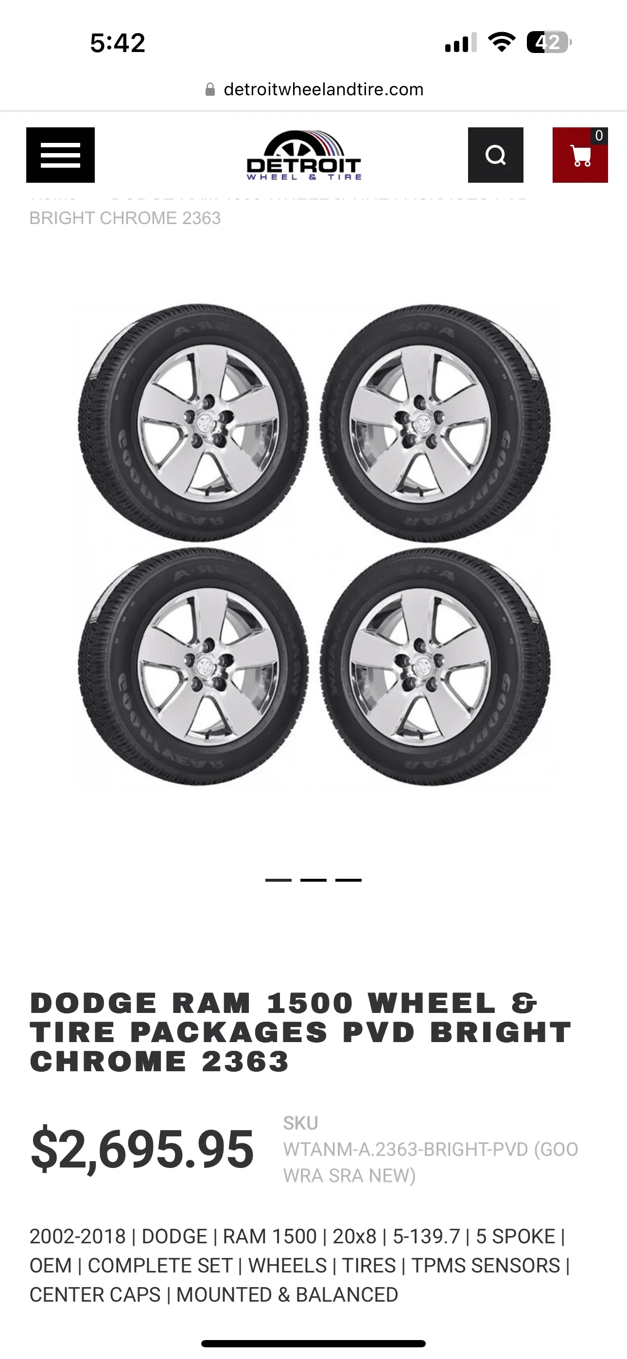

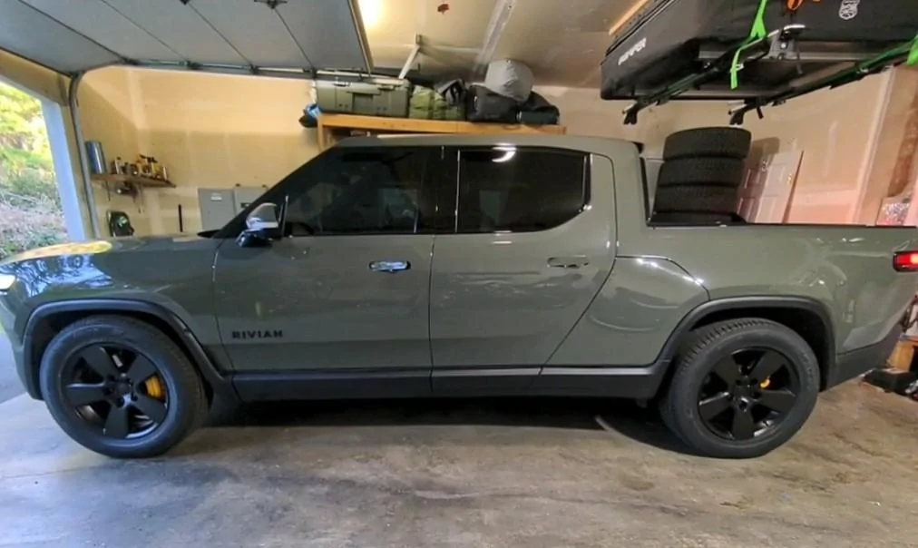

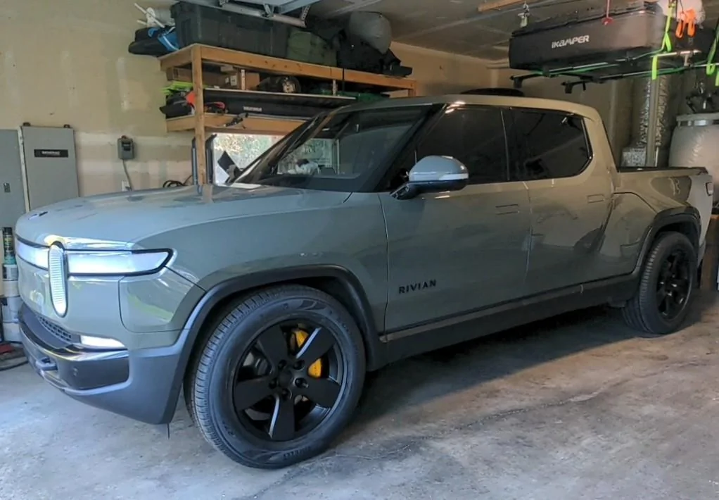

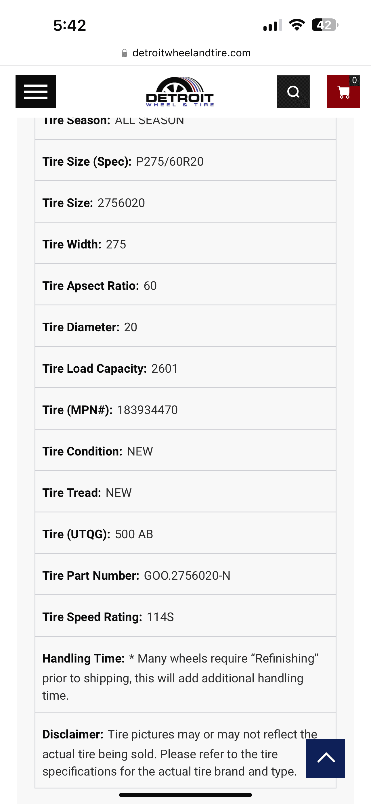

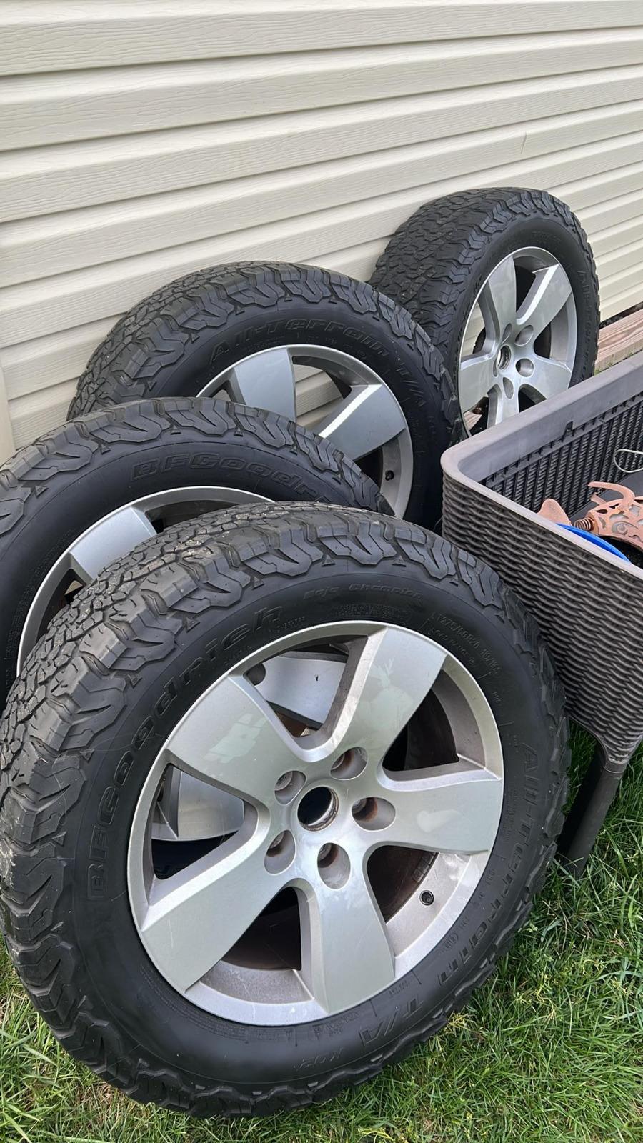

I just switched to my 2363 AS build with 275/60R20 Pirelli AS+3 and love the look! Despite the smaller size and AS looking dinky on stock 20s, the offset and style make them look great on the truck with 2363 wheels.

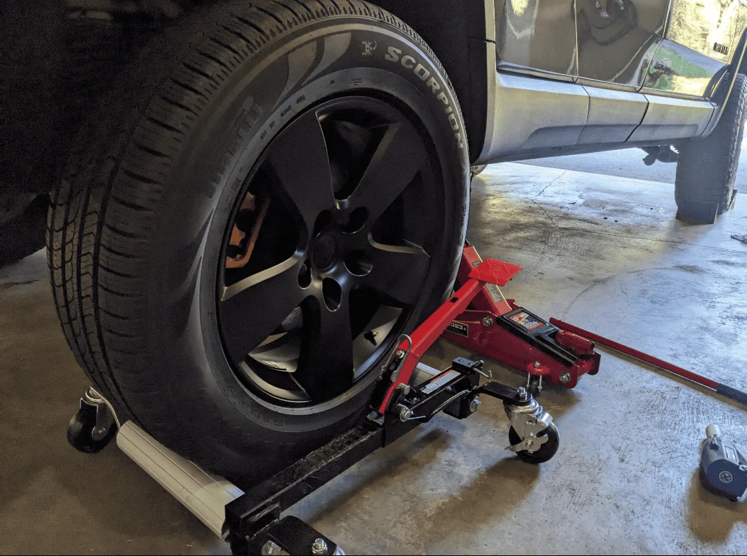

It was so much easier with the tire dolly and proper floor jack I got for Christmas!
Rivian R1T R1S Affordable Winter Wheels Setup: Ram 2363 1000009217
Rivian R1T R1S Affordable Winter Wheels Setup: Ram 2363 1000009214
Rivian R1T R1S Affordable Winter Wheels Setup: Ram 2363 1000009215

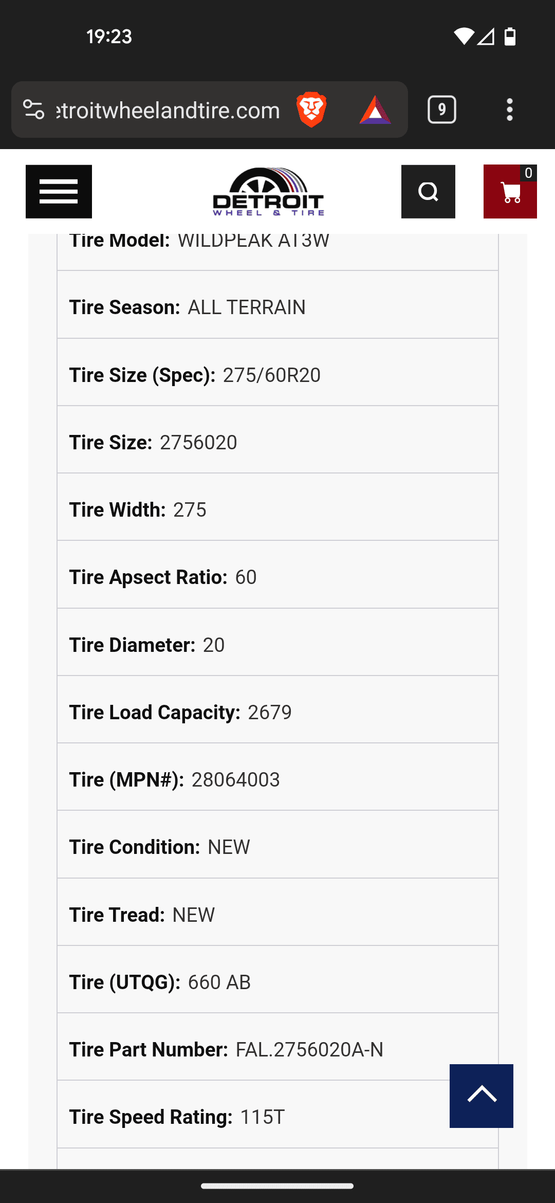

The Wildpeak AT3W got 7k miles at 1.96mi/kWh through winter, not too bad! Started with 13/32" and ended average 11/32", wearing surprisingly evenly, making for a 35k tire if you're willing to push it.
I ran my first efficiency test today with ATs before swapping and will watch the AS for a while before conducting that under identical conditions, then the same for AS on stock 20s. Standby to standby!

@Riviot , you’re comfortable running the 2363 wheels all year despite the difference in offset? I’m getting ready to swap out my snows on the 2363 wheels (overdue at this point). My options are to put my 21s back on that are nearly to the wear bars, it look for 275/60R20s to put on my 2363s, and find another set of 2363s for the snows next year.
I like to look of the wheels, but a little concerned about running that wheel all year…

No concerns so far! I have 1300ish miles on my AS setup, they're wearing evenly and do well on my 100-mile each way work trips. I'm overdue for a testing of 2363 AT vs 2363 AS vs OEM 20s AS.
What concerns are you considering?

Primarily the difference in offset from OEM.

I wouldn't worry about running them year round. I have considered a second set for all-season tires as well. Still have some life in my 21s though.

Just don't use anything lower than Standard ride height. Low rubbed on bumpy roads for me...I wound up getting another set of stock offset wheels and got rid of the 2363s. That assumes you had the 20s from the factory (34" tires). Supposedly the folks running 33s don't necessarily have issues.
