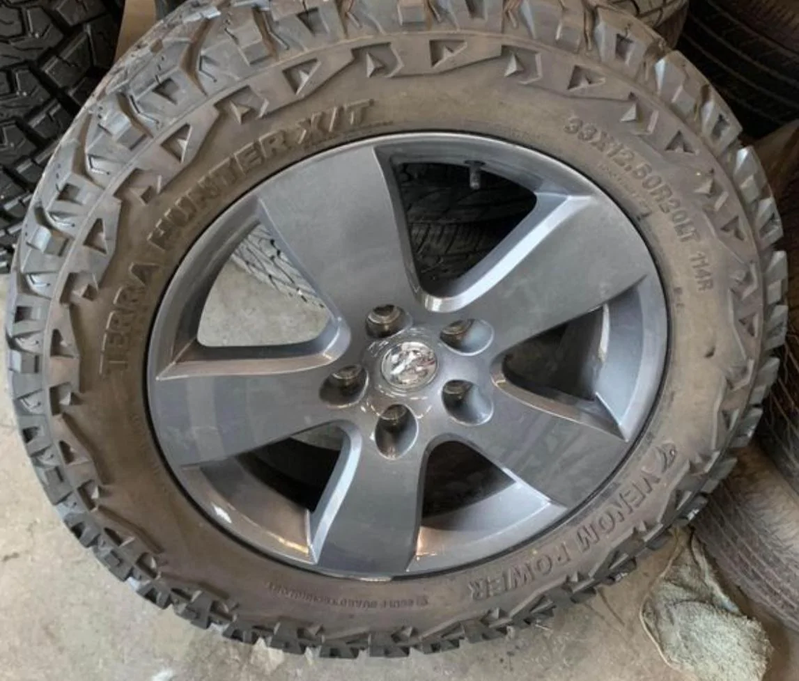

What did you get? I'm confused by "stock" and offset.
Riviot - Any idea if these are the right Ram rims?

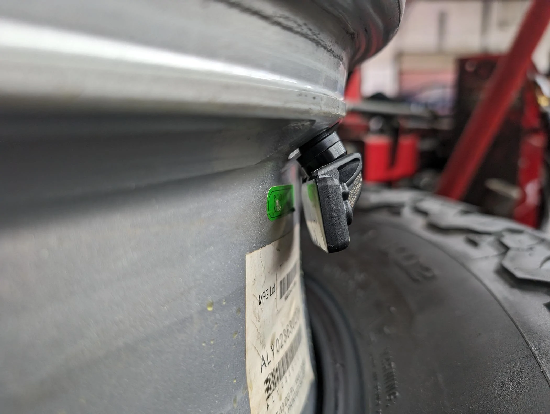

Anyone have any issues mounting TPMS? The tire shop I'm going to says the rivian TPMS sensors don't work.
He is saying they don't have enough thread or something along those lines to line up. It's the same sensors that EV sportline sells.

That doesn't look right at all.
I used these for both of my 2363s and my wife's recent Rav4 Prime Hellions
https://a.co/d/9pvyIqN
If you still have problems and order those instead, DM me and I'll send you my programmer.

Have those exact model from Amazon. Zero issues last fall when I built the set. Just buy them and attach yourself?
Someone told me also check actual instructions because it requires a torque amount and I'm betting the tire shop didn't know that....

Yes, very easy to over-torque from personal experience.

They didn't even try torquing and the the guy is like we may not have a small enough wrench to torque. I'm here thinking aren't you a tire shop?

Tire shop did confirm it worked it after I told them to read the instructions and torque to spec.
FFS ? I guess they didn't wanna break the TPMS and being extra careful
