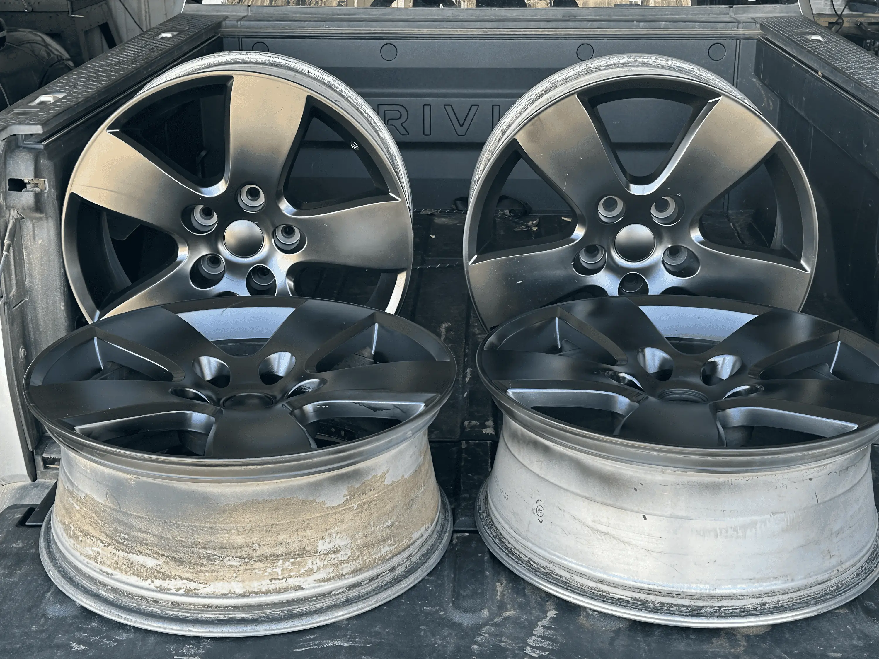

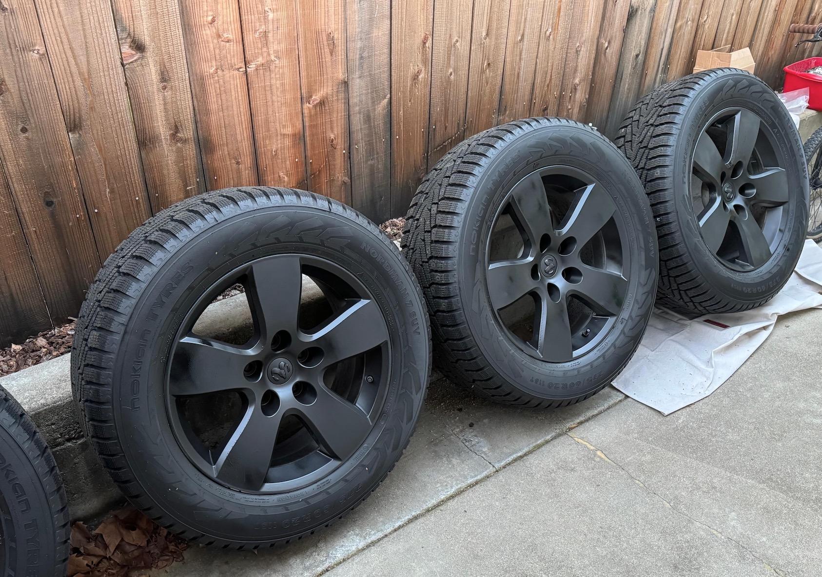

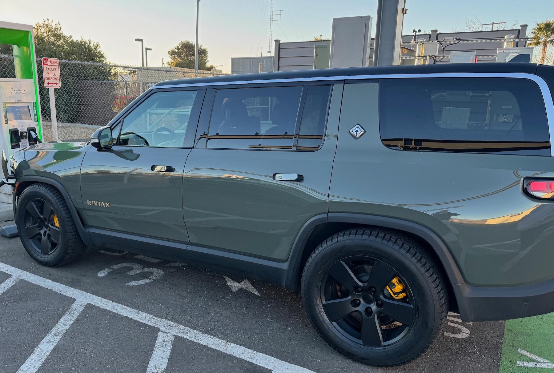

I finally got around to painting and installing my winter set for a trip to Mammoth this past weekend. The traction on snow and ice was incredible. I didn't notice any meaningful change to range vs the 22" wheels either. Will post efficiency metrics next time.

What are these tires? And where does your rig normally reside?

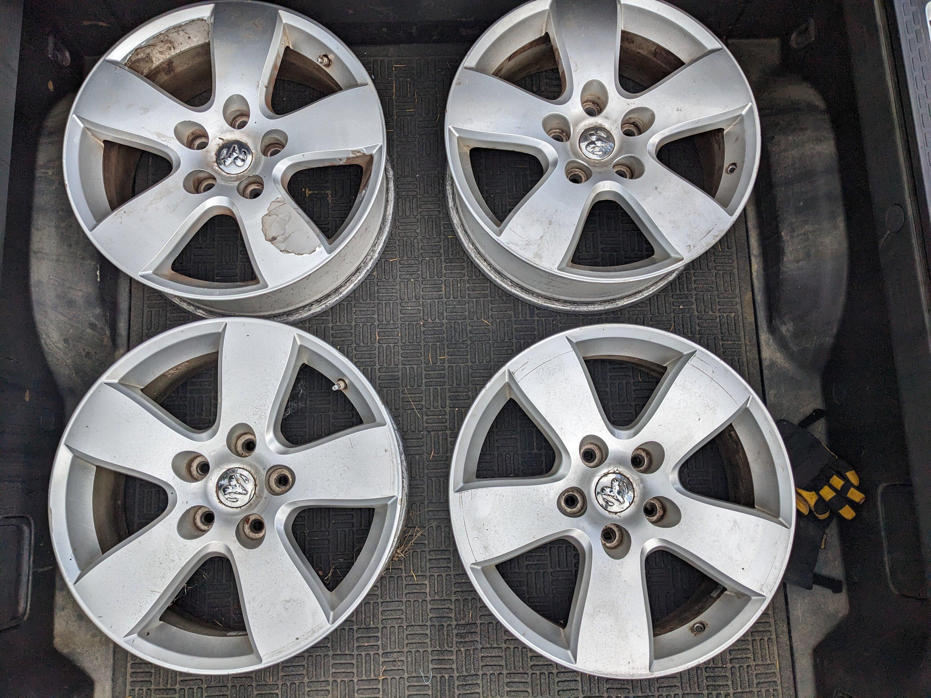

I found this set locally for $400. Is this the right one? Owner said it came off his 2016 ram 1500 rebel. worth it?
I don't think those will fit. The spoke design is just different enough.

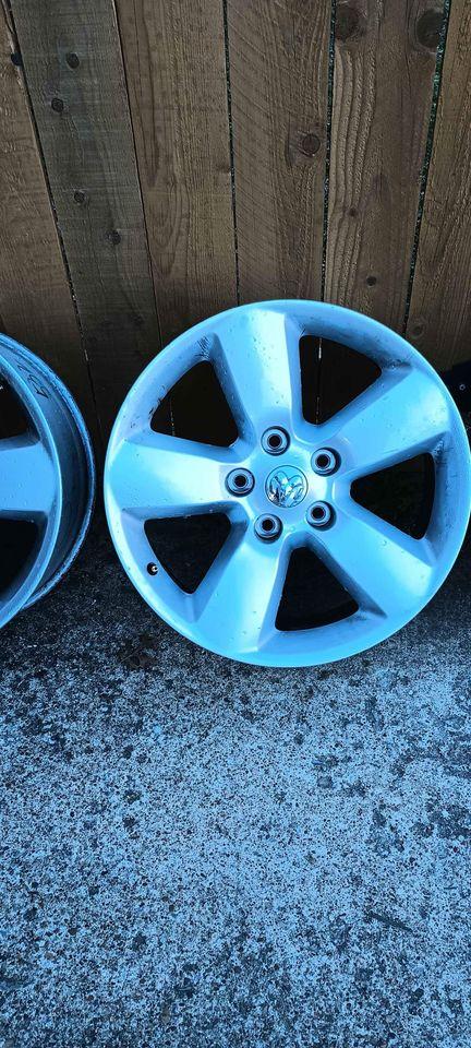

Rivian R1T R1S Affordable Winter Wheels Setup: Ram 2363 IMG_20240117_082630
These are the deceptive round ones, you want the spoke meeting the wheel to be even and flat.
Thanks. Yea. That picture doesn't look flat at that area. Any of these come in black originally?

Nokian Nordman 7 SUV 275/60R20. We commute to Mammoth every other week from Santa Barbara.
How do you feel about running these winter tires in the mild coastal climate? How many months a year would you say you keep them on?
I contemplated straight winter tires but feared degradation by warmer temps down low before they reached end of tread life. The way our rigs chew through tires, might not be an issue though.
I think I'll leave them on when I'm heading up on back-to-back weekends. I can swap them in ~30 mins, so I might get into that habit, too.

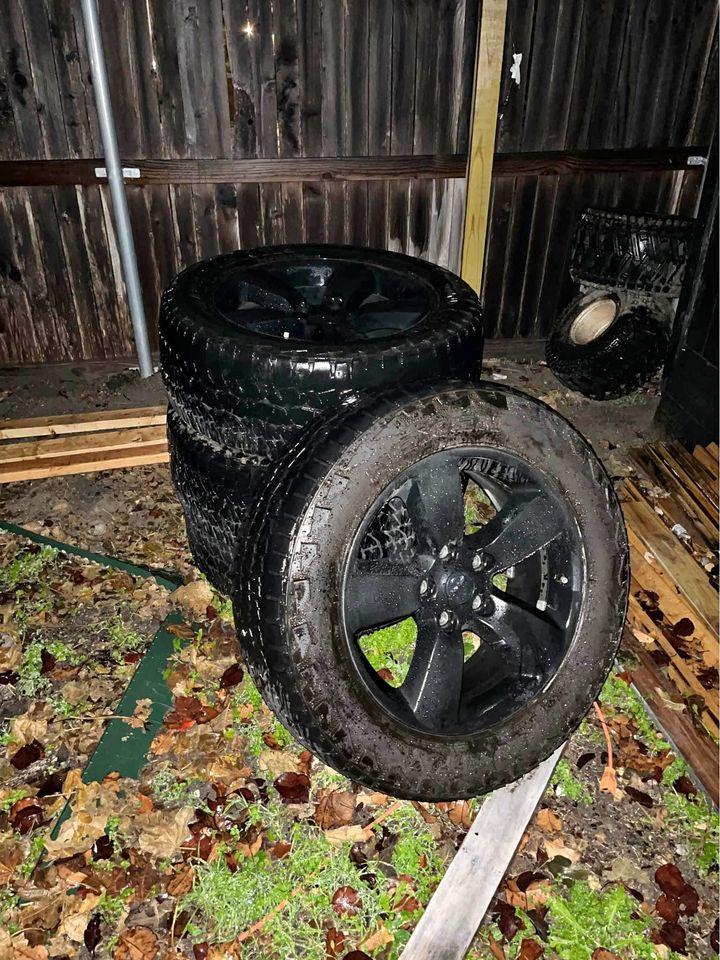

I'm pretty sure no, could be wrong. I think most black ones are sprayed aftermarket.
selling for $350. coming off 2013 Ram 1500. Is this it? So hard to tell from the pic.
