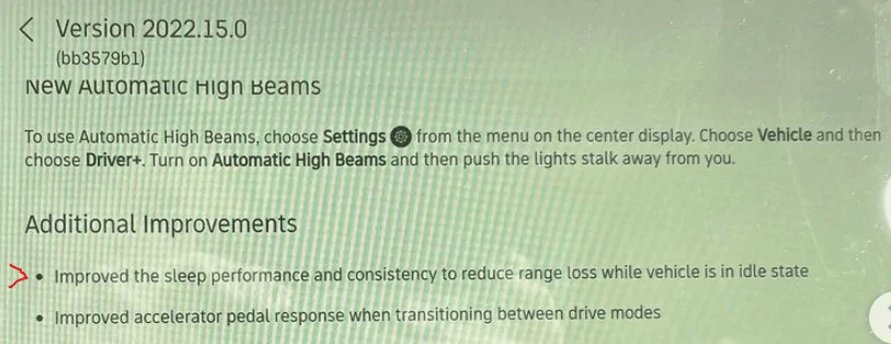

I'd love for something like this screen to be added OTA in one of the menus. I don't think the level of drain reported in this thread is supposed to be "normal", the latest OTA still makes reference to fixing vehicle sleep. It's at least the second OTA to mention sleep performance, that's a lot of attention to a specific system if its working as intended.

Looking forward to owner's report to see how much of a difference this update made:

What's become a bit frustrating for me is a lack of communication from Rivian on this issue (surprise!). Things like the proximity key they'll get working eventually vehicles have been doing it successfully for years. The fit and finish issues reported here I'll give a pass on for now, they've only produced so many vehicles for a short period of time. If its all the same issues in a couple years I'll pile on. But the phantom drain is a pretty big issue.
With only the update notes as evidence they're clearly working on something having to do with vehicle sleep. But the bare minimum would be to send out a note, even if its to owners only, that says they're aware of this issue as a result of something that's not working as intended and should have a fix soon. I have no issue giving them time to address it and with my Q42022 but most likely 1H2023 delivery I'd imagine things will improve by then. But not saying anything is strange when I'd think the reports in this thread would only grow with more deliveries.

While I am sure there are places where background drain can be reduced by improvement to software coding, for example, I don't think we can really say that things are not working in general. Rivian, when they designed the truck, designed it for urban cowboys who will be the majority of purchasers despite the way the truck is marketed. Rivian gave them what it thought they wanted (i.e. bells and whistles and a vehicle that is ready to go as soon as the owner steps into it). It takes power to maintain the vehicle in this operational state. A few owners plan to take their vehicles out into the boonies and park it for 10 days while they commune with nature and Rivian's marketing really supports the notion that you can do this but 4kWh/da drain uses 30% of an already too small battery (135 kWh) and 2 kWh/da is 15%. So give up the top and bottom 10% of the battery to prudent battery use and another 15-30% to phantom and you find you have but 50 - 65% available for traction and that may well be on substrate that requires appreciably more than the nominal 450 Wh/mi.
So Rivian is now aware that phantom drain is a big deal to a vocal portion of their user base and has announced that they are attacking it with methods for doing this mentioned in other posts. Fixing anything which is indeed broken is, of course, part of this but the rest involves cutting back on some of the bells and whistles stuff. We'll see how this sits with the majority use case (daily driver) owners. There is a way to satisfy both groups to some extent and that is to give the driver the option to turn off some of the functions that consume lots of power during sleep, to control how often the vehicle sleeps, to have various levels of sleep etc.

Got my truck back from Rivian last night, they didn't apply the update while it was in service. A little annoyed but hopefully it'll be waiting for me to install after work.
