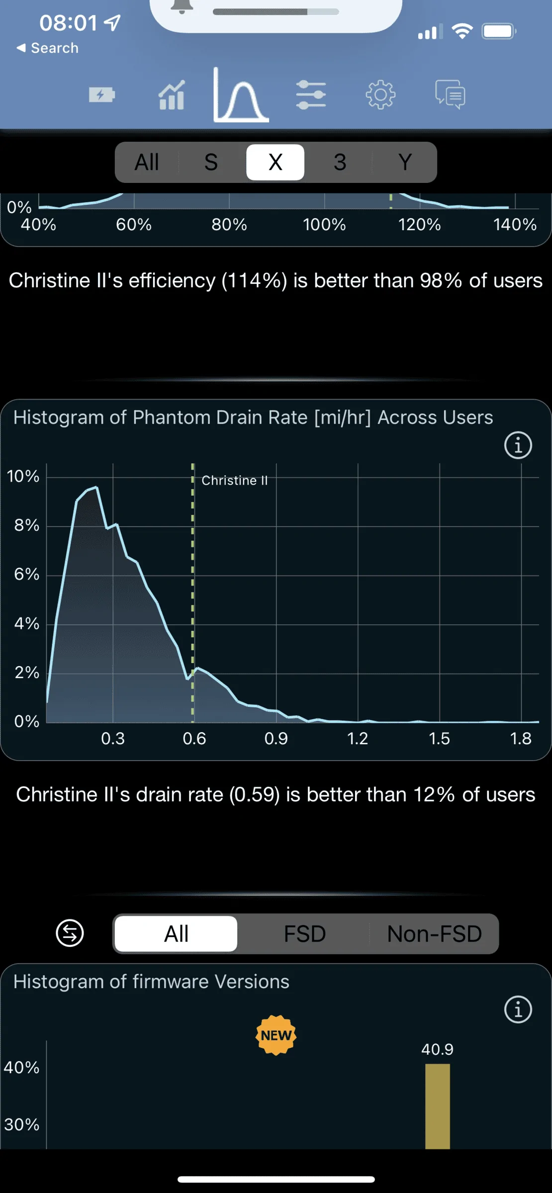

BS. Teslas have never swallowed as much juice (kwh) as these Rivians are. You would need to have Sentry on and Cabin temp protection on in the sun on a sweltering summer day to come anywhere close. Rivian needs to fix it.
Posts like this again reinforce my conclusion that many people do not understand what phantom drain is nor, therefore, what causes it nor how to mitigate it.
Earlier this morning I went into the gqrage and heard a fan running on the car. Why it was running I don't know (suspect it was because I had the fob in my pocket and it was preparing for me to get in) but the juice used to run that fan is counted as phantom drain because the gear selector was not in D or R. As several posters here have noted hearing fans or pumps run on their R1T when they are not in the truck I suspect that proximity sense may have something to do with high Rivian phantom drain rates.
As for no Tesla ever drawing that much I offer the following:
Rivian R1T R1S Any tests done on Vampire battery drain? IMG_1784
As the histgram shows my car (Christine II) has a phantom drain rate of 0.59 miles per hour. That's 14.16 miles per day which, as my rated consumption is 282 Wh/mi is 3.99 kWh/da. Note that the histogram is for model X. Also note that most X drivers have less than I do.
Stop making excuses for them.
Stop making a fool of yourself. When people have real data it's hard to argue that it's wrong. You clearly don't understand what causes this and therefore don't understand that to "fix" it Rivian has to curtail functionality which people want.
