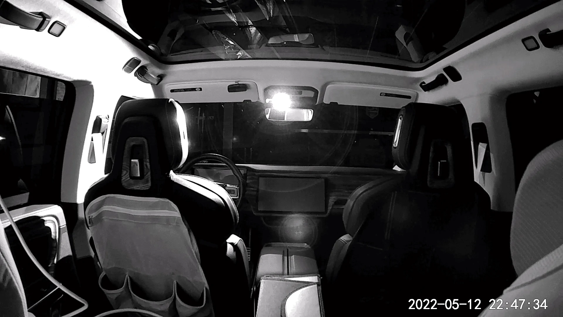

FIrst, I've been on the latest update for about two weeks now.
I usually lose about 1% sometimes 2% per night. I checked my camera in the garage last night cause i saw someone else mention the interior lights come on. Sure enough, mine come on about 3 to 4 times a night for about 30 - 45 minutes. Mirrors stay folded and door handles stay in. The exterior cooling are running at this same time.
(Lights on)
Rivian R1T R1S Any tests done on Vampire battery drain? 1652376099320
(Lights off)
Rivian R1T R1S Any tests done on Vampire battery drain? 1652376120664
I usually turn off the AC when i get home but now I'm curious if that runs and the music plays during the same time the lights are one.
One other thing i noticed is the truck does a LOT of data uploading during that time. My guess is it's the nightly gear guard backup.
Rivian R1T R1S Any tests done on Vampire battery drain? 1652376086981
I have a wyze cam that will run off a battery so I'm going to hook that up tonight and see what happens inside the truck.

First fun find of the night... It seems like it's not actually the dome lights coming on but the IR sensor on the interior camera. I'm guessing it's for the alarm.
This same pic the truck interior is completely dark.
I'll see if anything else turns on in the morning.
Of course! That's a cool effect how the black headliner reflects almost pure "white" in IR, while all other surfaces up there reflect "black".
