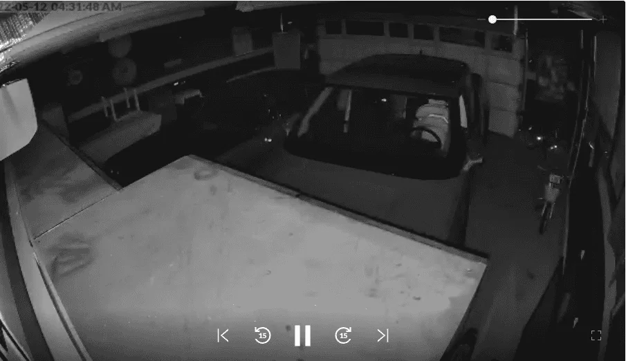

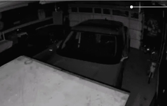

FIrst, I've been on the latest update for about two weeks now.
I usually lose about 1% sometimes 2% per night. I checked my camera in the garage last night cause i saw someone else mention the interior lights come on. Sure enough, mine come on about 3 to 4 times a night for about 30 - 45 minutes. Mirrors stay folded and door handles stay in. The exterior cooling are running at this same time.
(Lights on)
(Lights off)
I usually turn off the AC when i get home but now I'm curious if that runs and the music plays during the same time the lights are one.

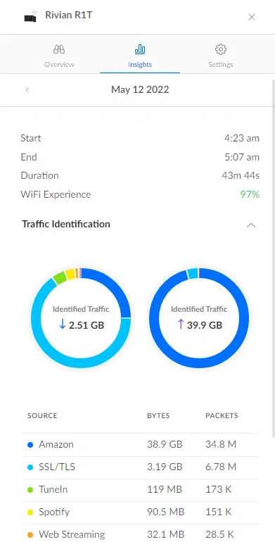

One other thing i noticed is the truck does a LOT of data uploading during that time. My guess is it's the nightly gear guard backup.
I have a wyze cam that will run off a battery so I'm going to hook that up tonight and see what happens inside the truck.
40GB is a bit much to not have a option to disable it, although I know a lot of people will like this feature. Mostly for those on data limited connections.

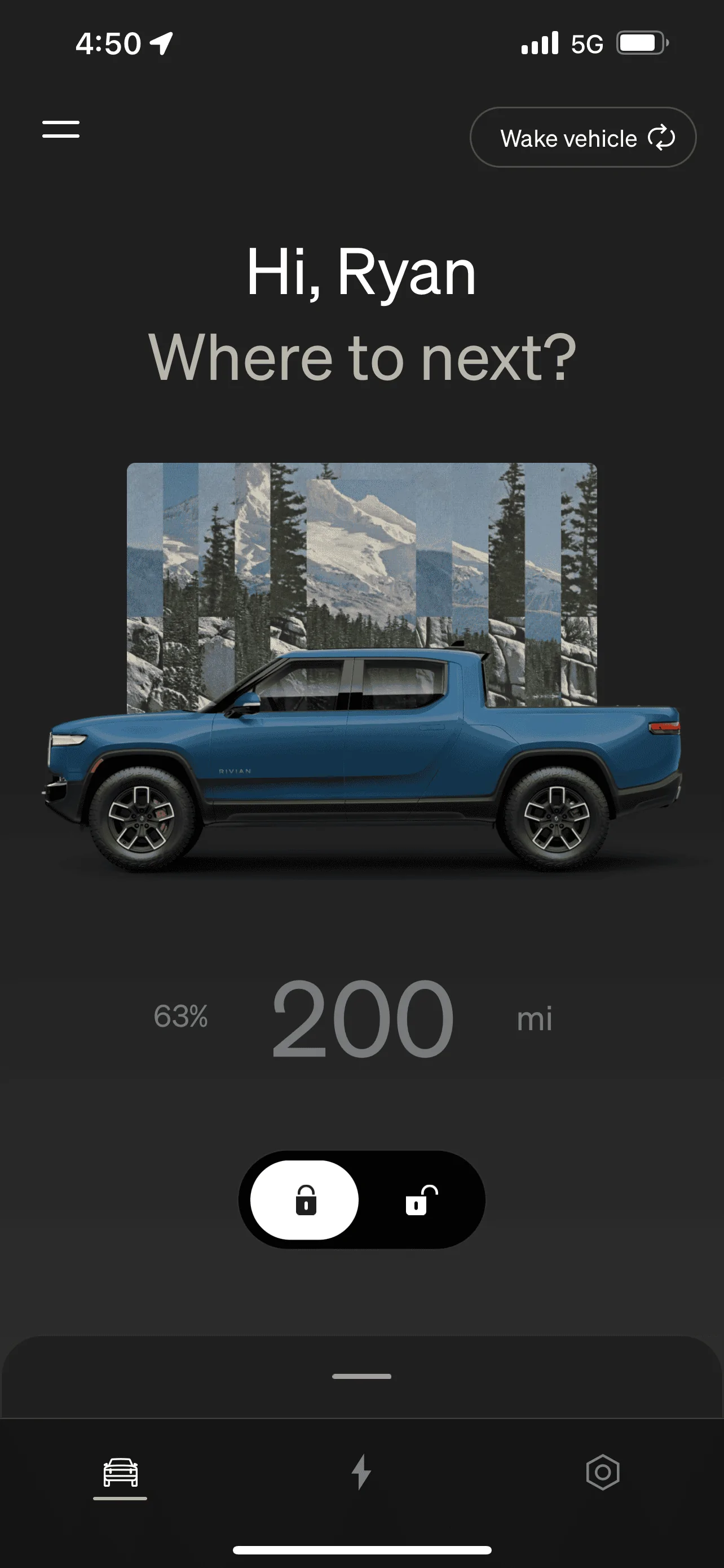

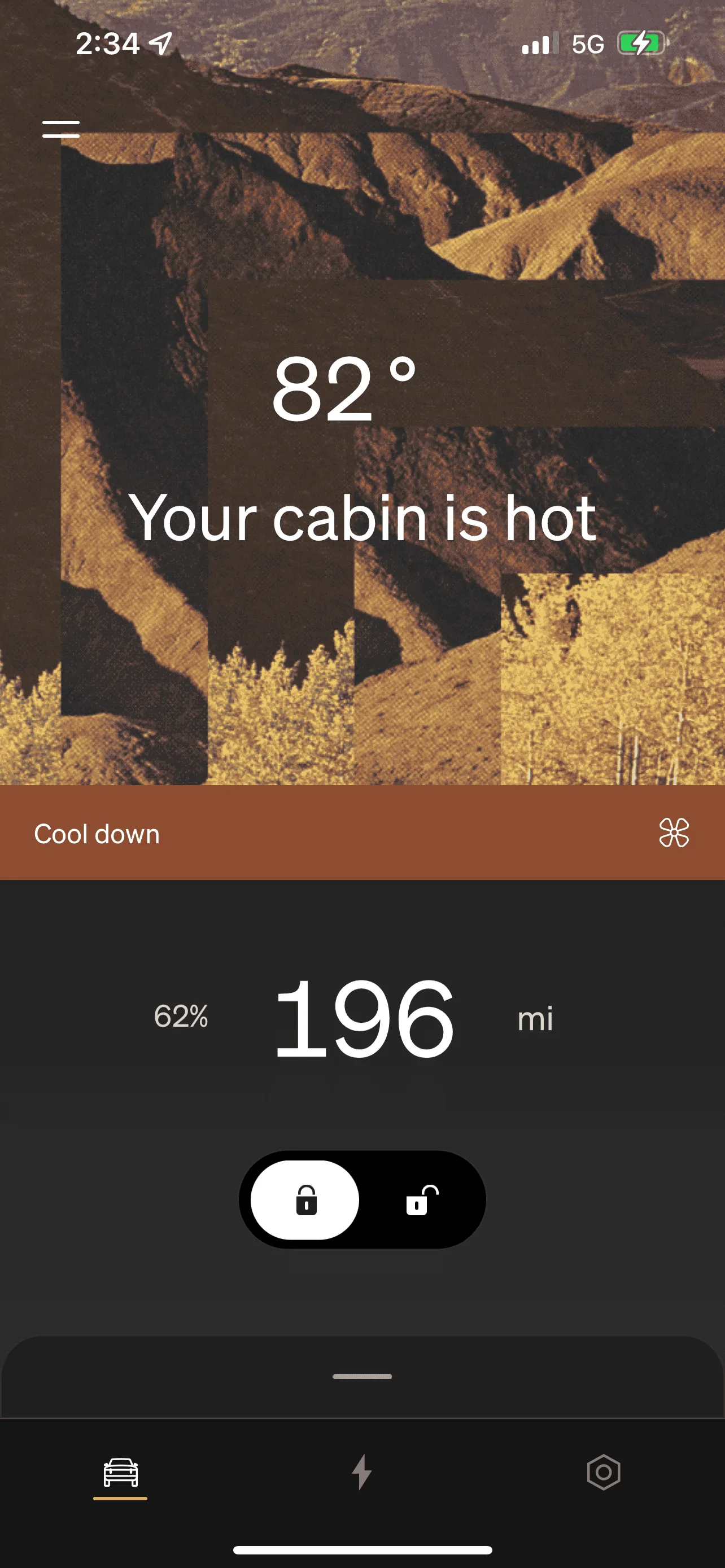

I took delivery on 5/11 and had to fly to San Francisco yesterday until Monday. Sad to be without my baby for several days. However, it's a great opportunity to test vampire drain as it's not going to be used for several days. I'm not quite to 24 hours yet between screen shots, but here's my unscientific test for 1 day. Basically 1% or 4 miles loss for 1 day.
Rivian R1T R1S Any tests done on Vampire battery drain? IMG_4151
Rivian R1T R1S Any tests done on Vampire battery drain? IMG_4159
Gear Guard is turned on, but is set to not be active while at home (and home location is set). This feature appears to work as I don't get any more Gear Guard videos while walking around it in my garage. Also, I have all doors locked and no one is home. Only one key card is still in my house (my phone key, other key card, and fob are all with me out of town), so no chance of a key randomly waking up the truck. I did notice when I was home that walking around my house (some parts of which are really close to my truck) causes it to wake up as the truck thinks I've walked up to it. This could be some of the cause for battery drain as well.
