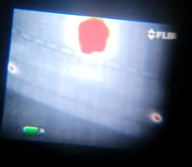

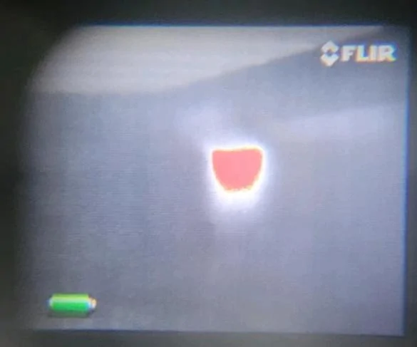

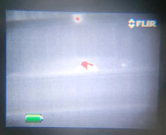

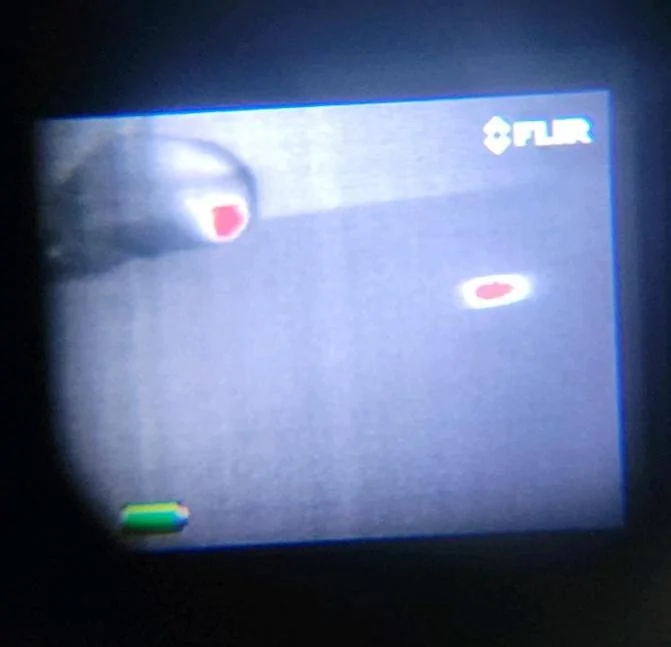

I was disappointed in the daily loss I was seeing and was curious where heat loss was occurring so I used a FLIR scope after the vehicle had been sitting unplugged for about 15 hours with nothing operated in that duration. Gear Guard was set to not be active at home which is the location where I checked it and external temperatures were about 45 degrees. The pictures aren't great because I don't have a phone mountable FLIR device.
Camera area on the mirror and drivers side door handle. All the cameras were showing "warm" to varying degrees.

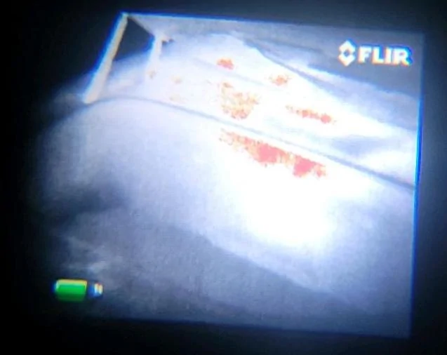

This is the front windshield which is showing heat coming off the rear view mirror "cluster" and the back of the hood by the windshield.
Rivian R1T R1S Any tests done on Vampire battery drain? Image20220419124315

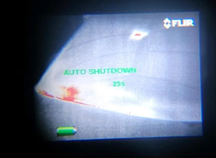

The rear facing camera above the bed and an area in the lower middle back of the cab exterior.
Rivian R1T R1S Any tests done on Vampire battery drain? Image20220419124323
Back area under the hood.
Rivian R1T R1S Any tests done on Vampire battery drain? Image20220419124344

Seems like gear guard isn’t truly turning off. In the first photo I clipped, I suspect the heat is just the 12v batteries discharging due to the power draw of the various other sensors and cameras.
The last one I wonder if might be one of the power outlets in the gear tunnel. There is a 12v on the driver side and 120v on the passenger side, correct?

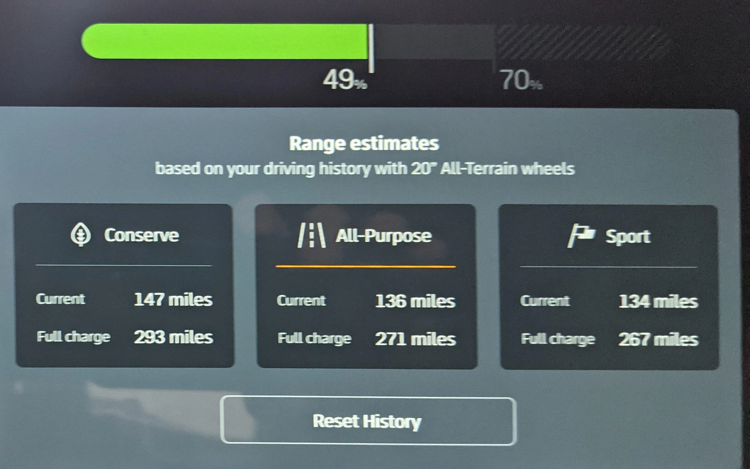

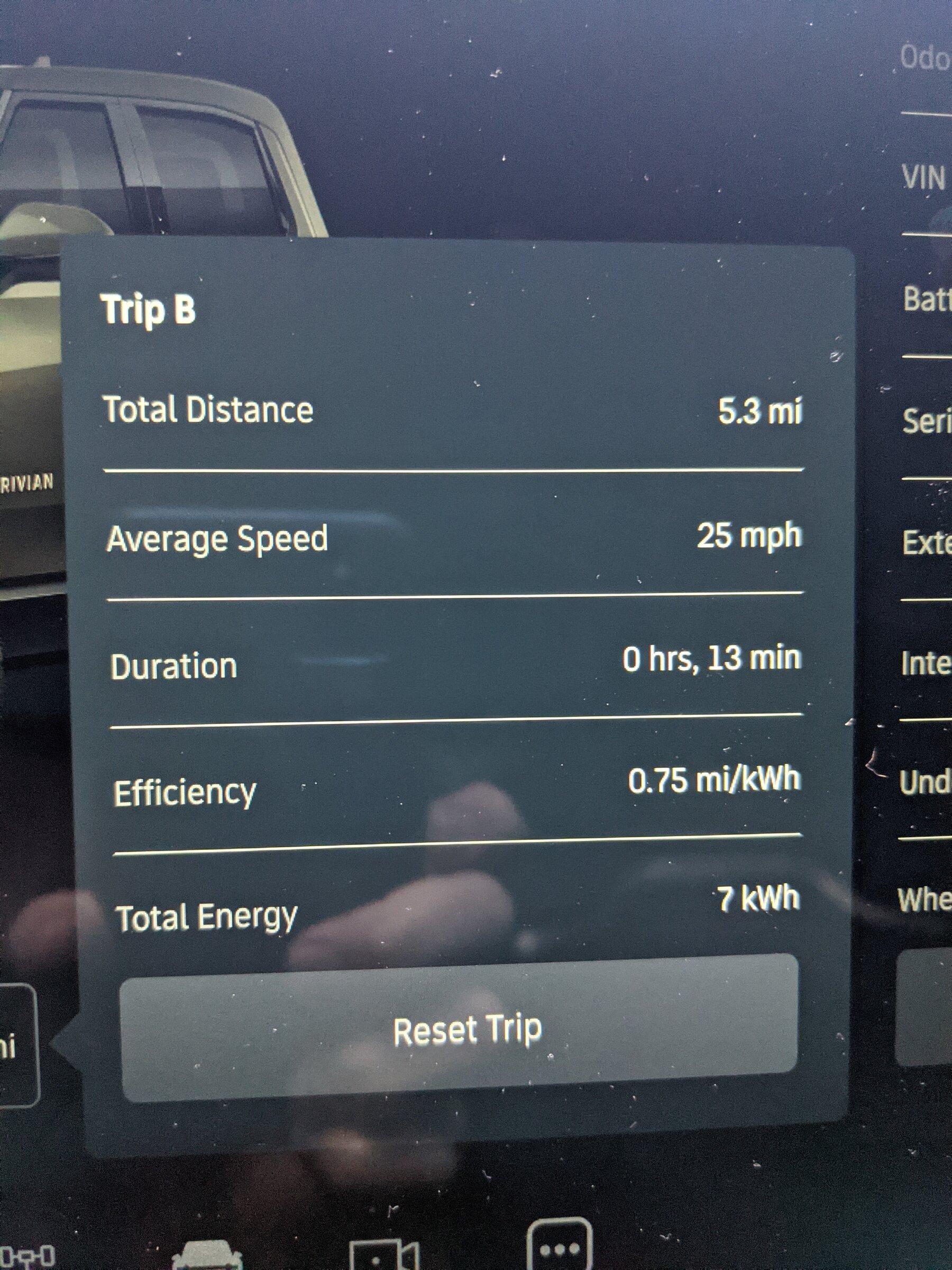

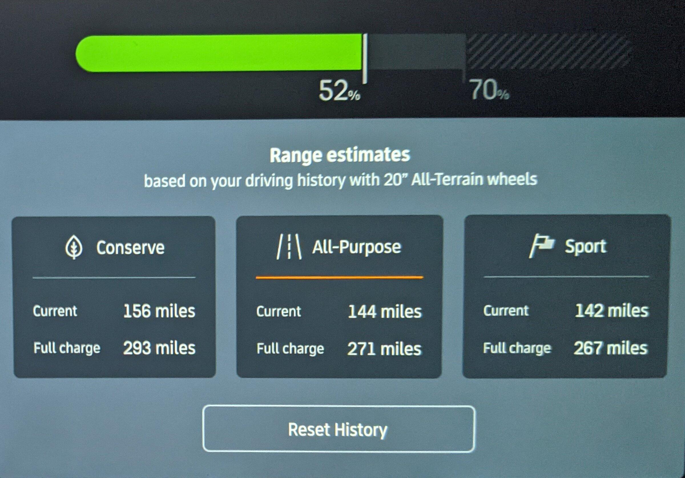

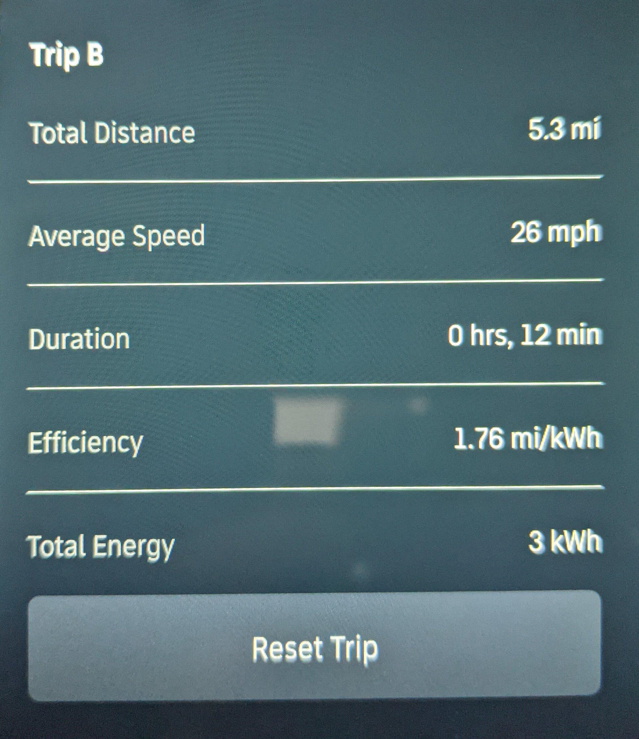

I wondered why my "trip" was so inefficient and suspected vampire drain was affecting my trip meter, and I was right! Now I'm pretty annoyed. I personally think the parked undriven power use shouldn't be incorporated in trips.
Total Energy loss rounds and was 4kWh, 9 Conserve miles loss.
[EDIT] Gear guard is on but "not at home", garage is 50°F, it wasn't plugged in, and WiFi is off. We also noticed it using 5-8Gb/day and have a monthly data cap so turned off WiFi.
Beginning after my short drive from the ferry yesterday:

24 hours later. I had to put it in drive and move a few feet for it to register and update the trip though:
Rivian R1T R1S Any tests done on Vampire battery drain? PXL_20220419_231903837
Rivian R1T R1S Any tests done on Vampire battery drain? PXL_20220419_231833675~2
I'll turn gear guard full off and see if the cameras are still actively powered. The 120 V system was off so that shouldn't be drawing any power. Curious if anybody knows what sits in that particular spot.
