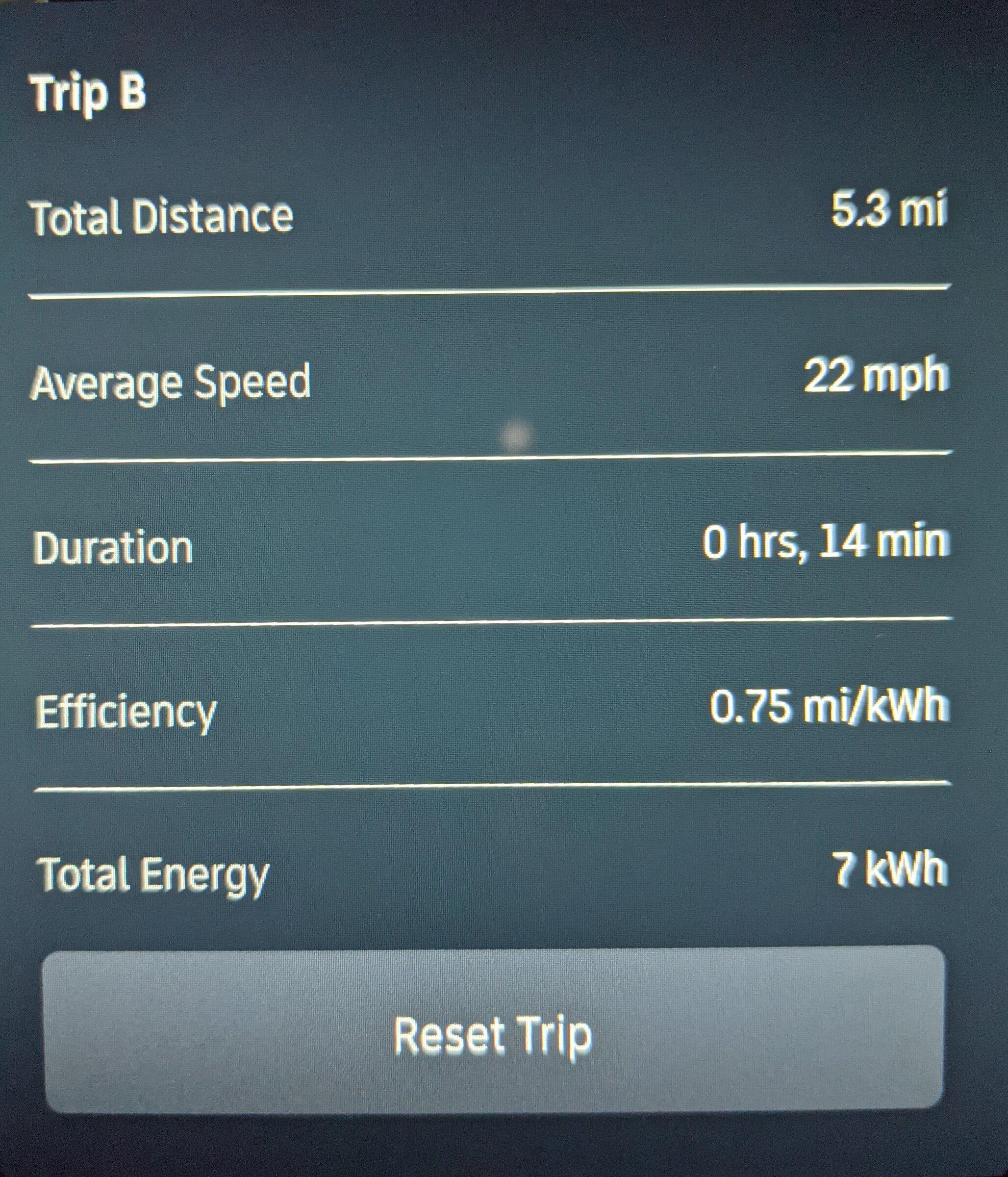

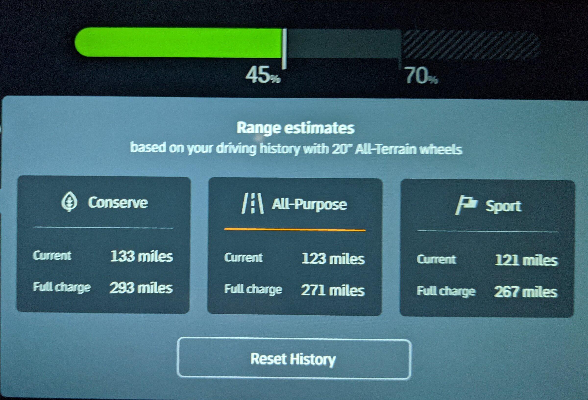

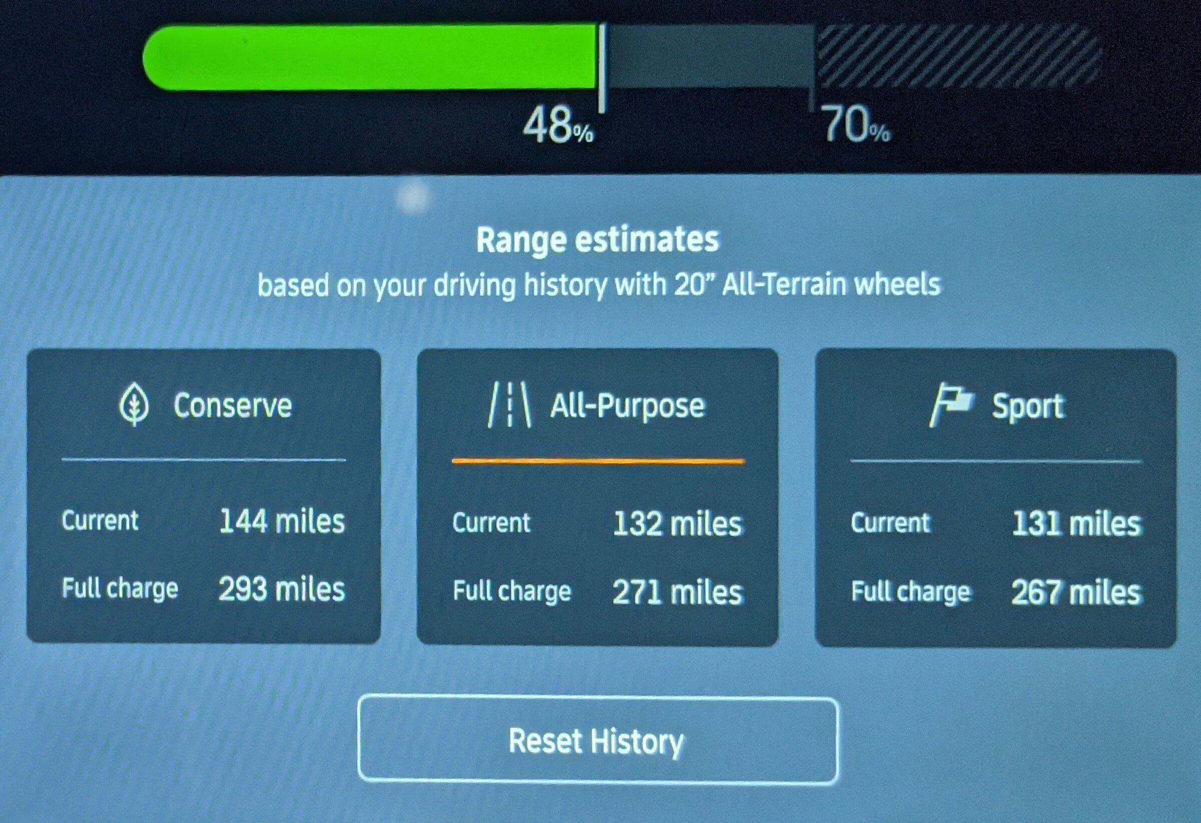

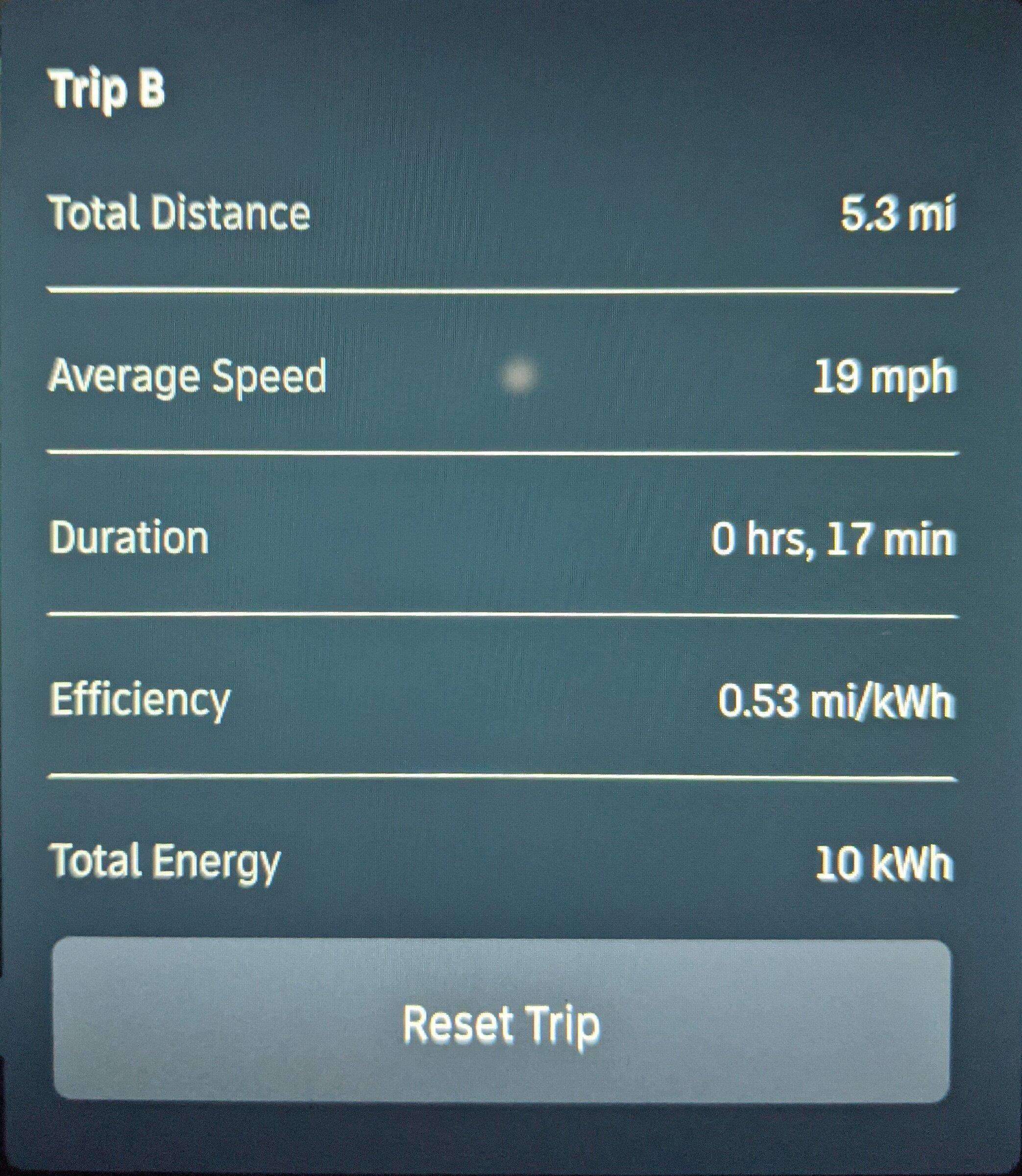

Alright I did your test with gear guard and WiFi off... And now I'm confused. I went through the same %, less kWh, more Conserve miles.
24 hour difference: 3%, 3kWh, 11 Conserve miles
Before
Rivian R1T R1S Any tests done on Vampire battery drain? PXL_20220420_024205508~2
Rivian R1T R1S Any tests done on Vampire battery drain? PXL_20220420_024821719~2
After
Rivian R1T R1S Any tests done on Vampire battery drain? PXL_20220421_032758564~2
Rivian R1T R1S Any tests done on Vampire battery drain? PXL_20220421_032836372~2
My kWh estimate was based on mileage lost so an estimate. So appears in the same ballpark. I didn’t realize the trip meter would capture this lost energy, so that is good to know.

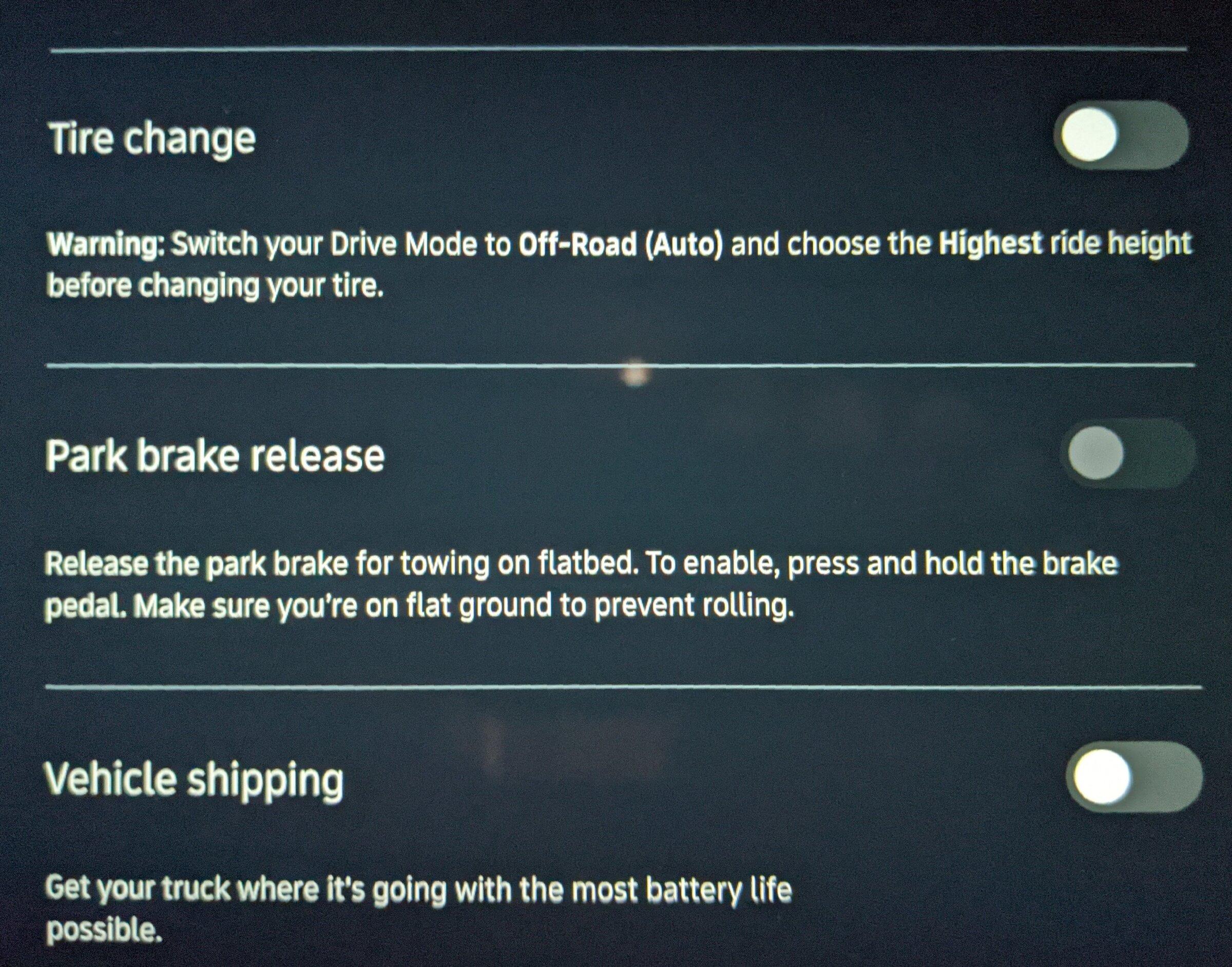

Starting Friday afternoon, I'll be testing the "Vehicle shipping" function over 24 hours. I could do it tonight, but would get less than 24 hours, and I think it's important to allow a full day cycle.
Certainly interesting, can't say I've seen this feature highlighted before. I'm genuinely curious, I just can't see some of the drain described here (with Gear Guard disabled) as working as intended.
Edit: Not to say that toggling this feature should in any way be required. It would only be a band aid until things are actually fixed.
