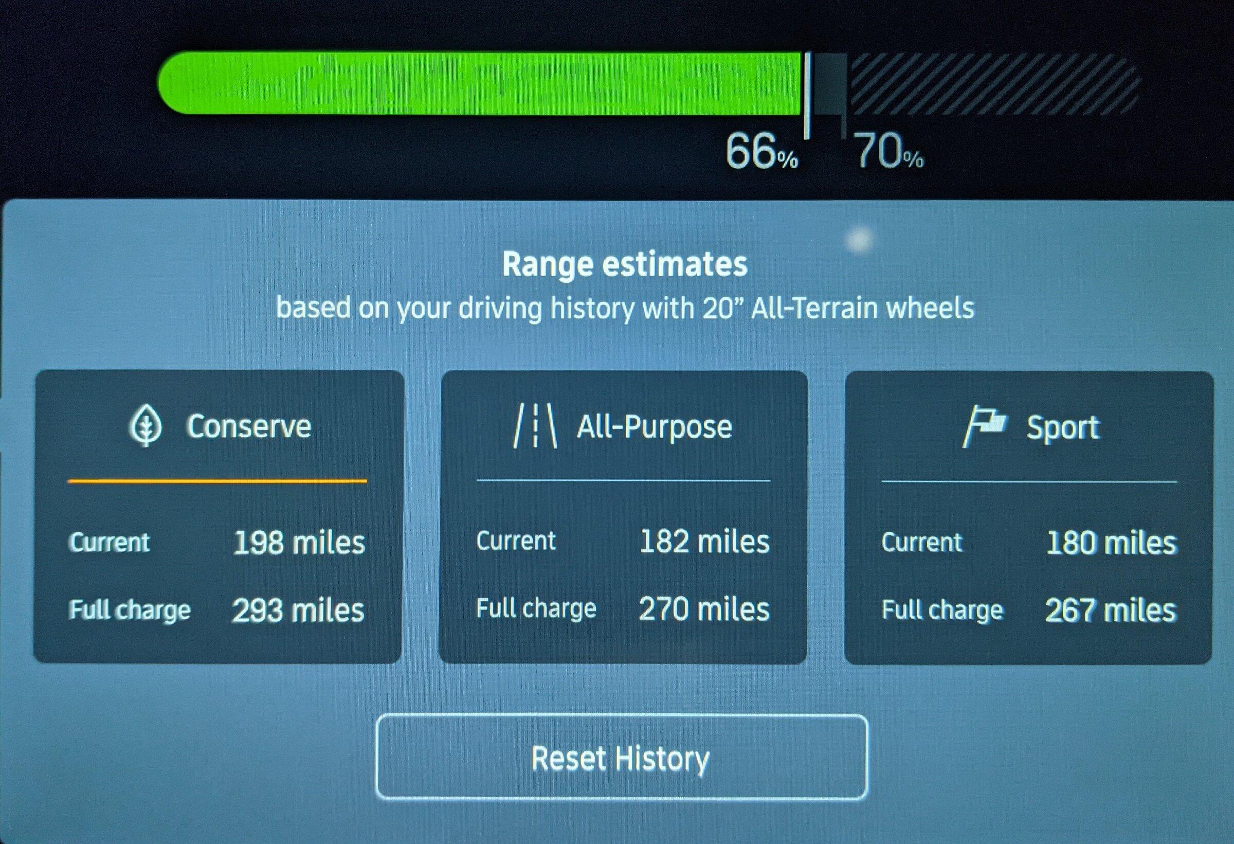

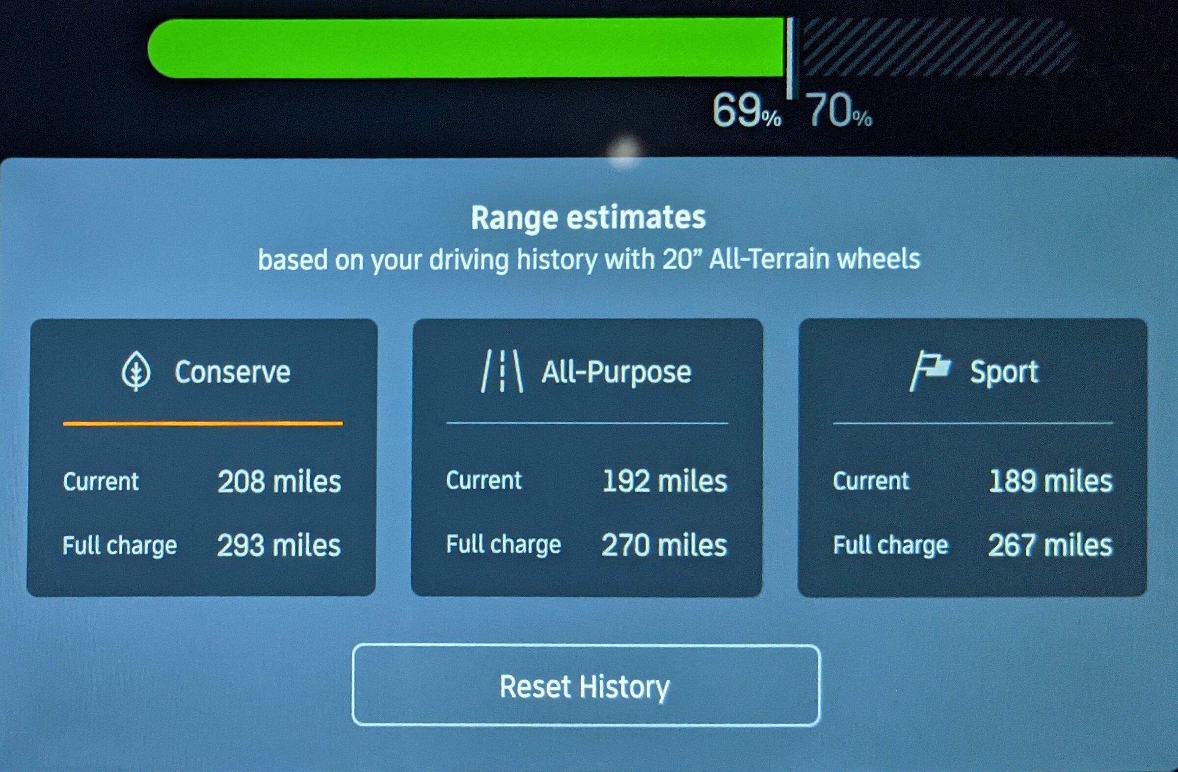

I tested vehicle shipping! Tldr; doesn't help.
I did notice the fan (BMS?) didn't randomly kick on as much, it was slower to unlock, and the screen didn't wake as quickly as normal. So maybe this would be better tested over a longer timeframe.
24 hour difference: 3%, 4kWh, 10 Conserve miles
