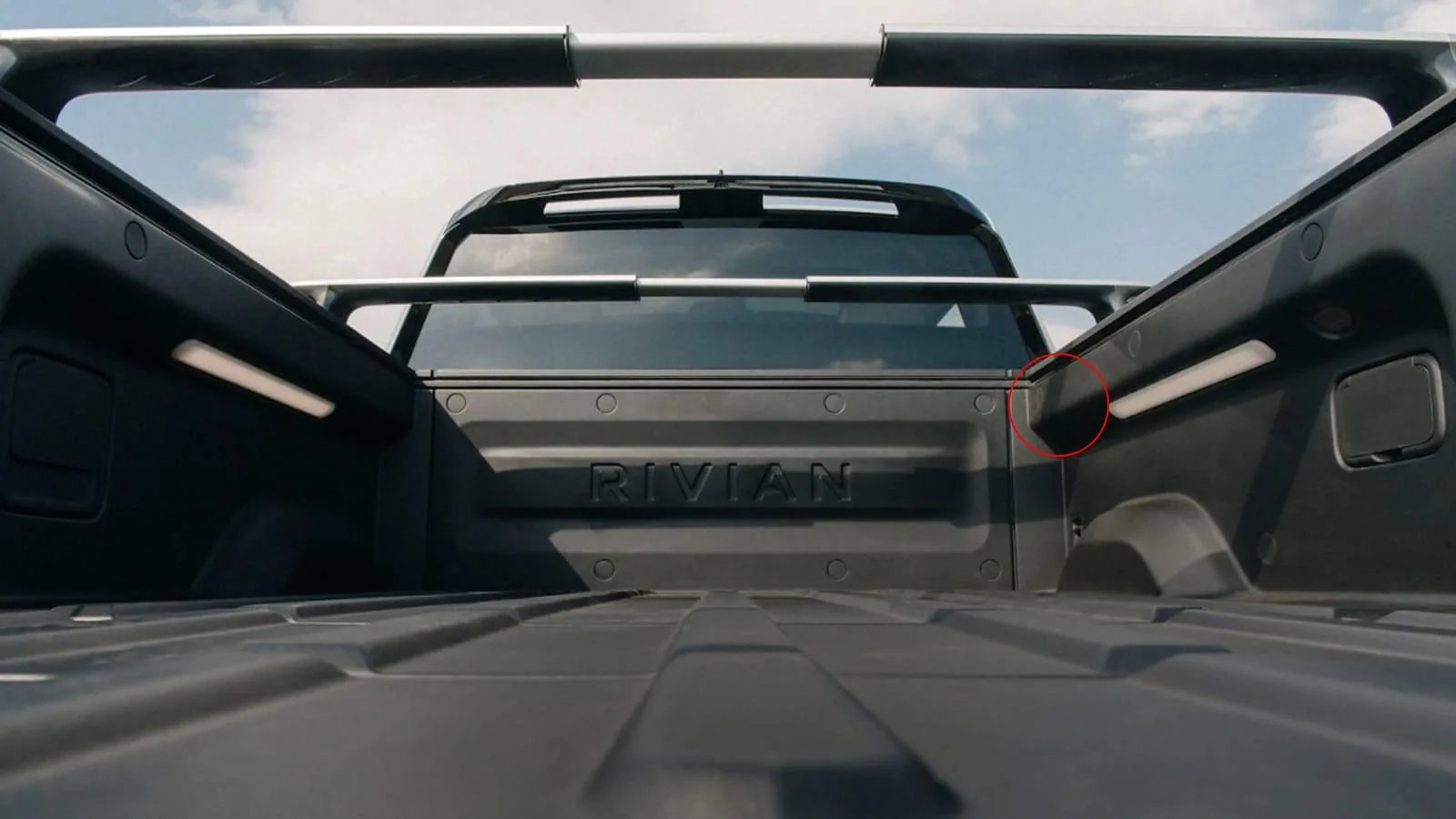

I'll turn gear guard full off and see if the cameras are still actively powered. The 120 V system was off so that shouldn't be drawing any power. Curious if anybody knows what sits in that particular spot.
My guess would be the motor and
hardware for the powered tonneau cover
