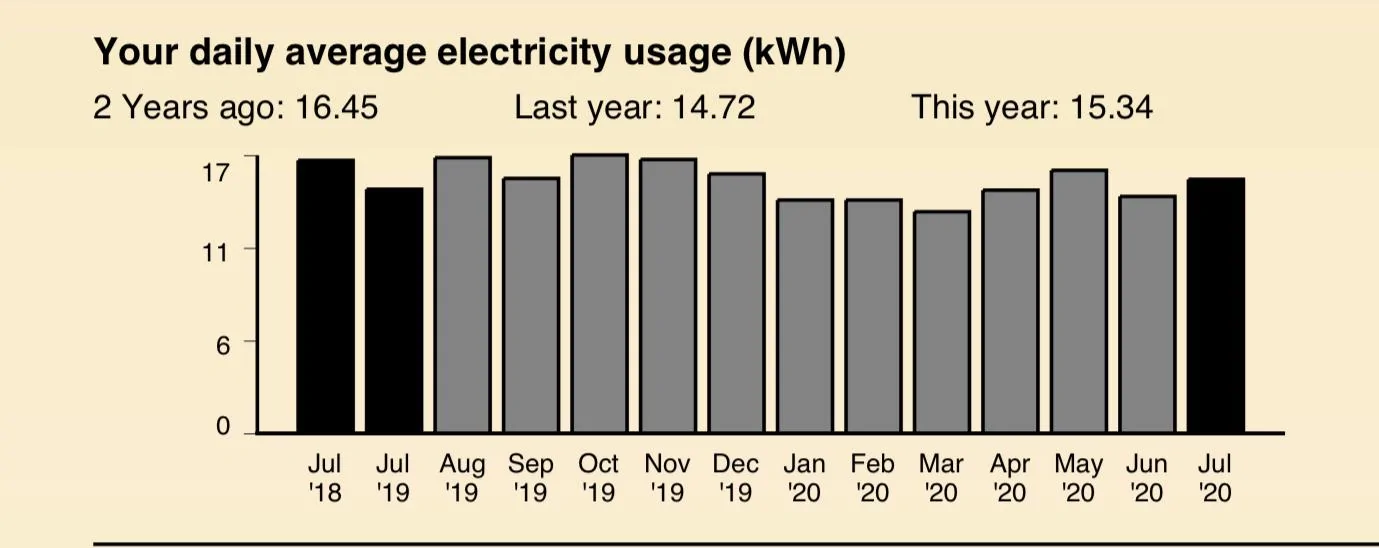

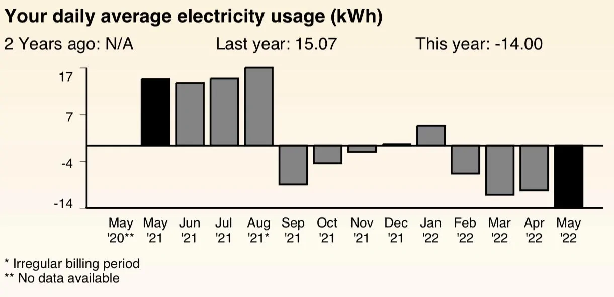

I live in SoCal not far from Beach, I never use heat rarely use AC gas dryer, all appliances are energy star rated and most lights are LEDs, TVs are led.
I put in a 6.29 kw solar system that currently generates more than twice what I use. I scoped it expecting to have the Rivian by the time it was installed, been installed for 10 month’s still no Rivian.
Here is the latest bill, they changed the system recently so there is nothing on the current bills past a year, second image is from before I added solar. I would not have been able to get an ROI on the solar if I was not getting the Rivian. Most of the charging for the Tesla is free. I am charging the Tesla more at the house now so I do not get kicked out of the NEM program.

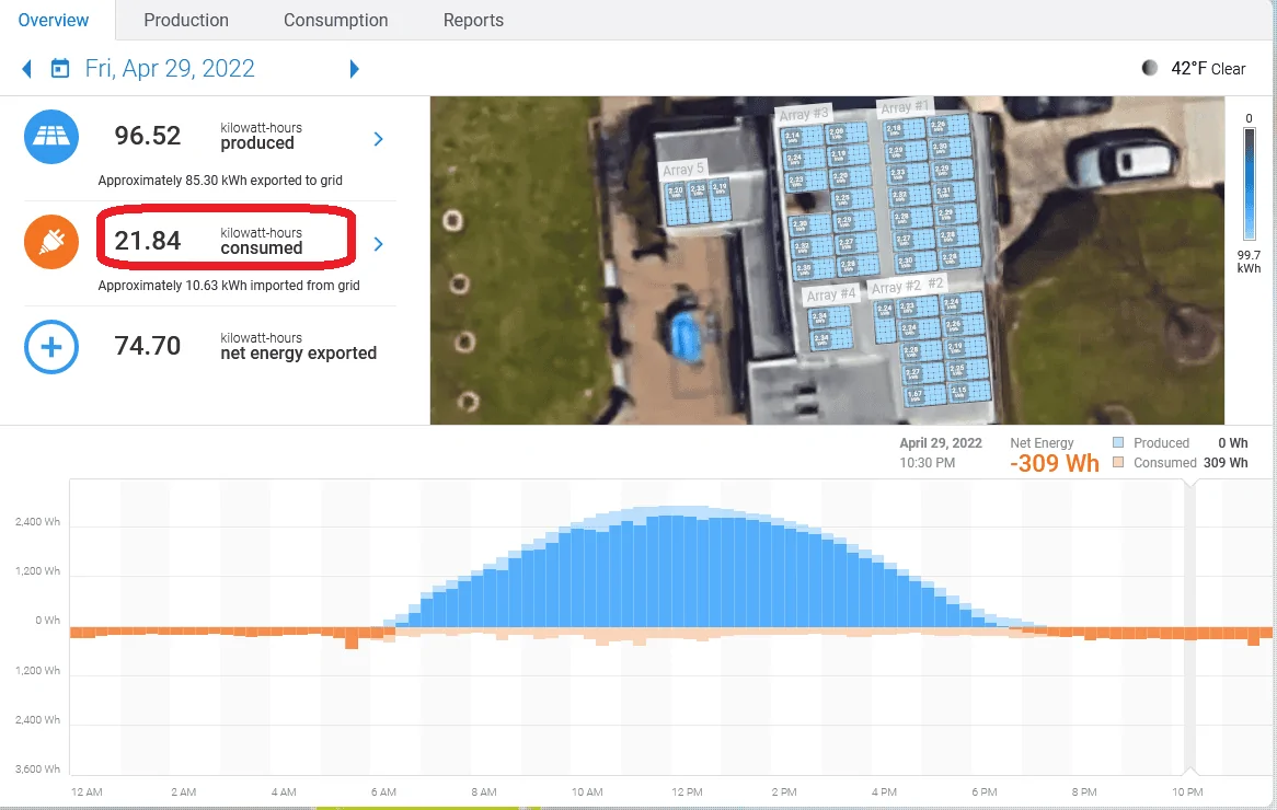

For reference... my 5 bedroom 2K sq/ft home consumes only 21kWh on days we don't plug in the Model 3 or i3...
10kWh of drain/day from an sitting EV is gigantic!
