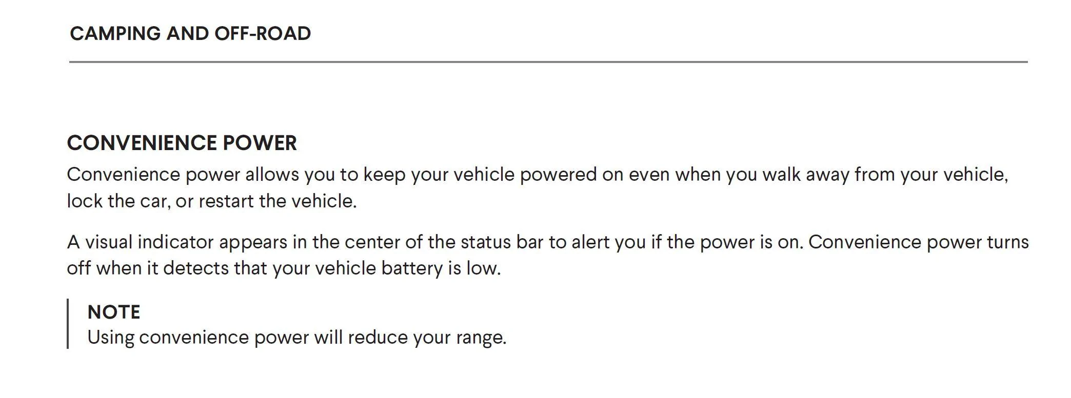

Has anyone talked about the "Convenience Power" mentioned in the manual? Is this contributing to the vampire drain??
Interesting find.
Can an owner please verify of this is an option to turn on or off and if it is on by default and comes back on every time you use your vehicle? or the other way around? If it has been on during most of these tests, we may need a redo with it off.

Interesting find.
The outlets stay off or on until you switch them. The default state is they are off.
Do you see a "convenience power" option you can turn on or off? it seems like it is different from outlets.
No place to turn off "convinence power"...
Also feels weird to get out of the truck woth a/c going and walk away waiting for it to shut down so i generally hit the "all off" button before disembarking.
One thing i noticed today was after turning on the cool down feature from the app while out of the car it will revert to keeping the car comfortable even if you turn off the a/c before leaving. Situation i was in today: came back from hike and truck 90 degrees inside so while making my way to parking lot started a/c from app. Drove home with a/c on. In garage turn all climate off and get out of car (no fans running). Inside house wondering what the truck temperature is a few hours later and open app to find it running a/c to keep climate comfortable. Thats the first time ive seen the a/c on while Ive been out of the truck.
See I find it strange that no one has mentioned this yet or knows what it is yet it's clearly in the manual. I wonder if this is the culprit for the truck staying on all the time when everything else is off or locked. I would love for anyone else who has to truck to chime in.
The manual also says when convenience power is on that “A visual indicator appears in the center of the status bar”. This is why I assume from context that convenience power = AC outlets
AC power off:
Rivian R1T R1S Any tests done on Vampire battery drain? EE272B77-AE6B-465F-8185-F3A871405FEF
AC power on:
Rivian R1T R1S Any tests done on Vampire battery drain? 091091C6-D8C7-42F9-B50C-E6212355407C
