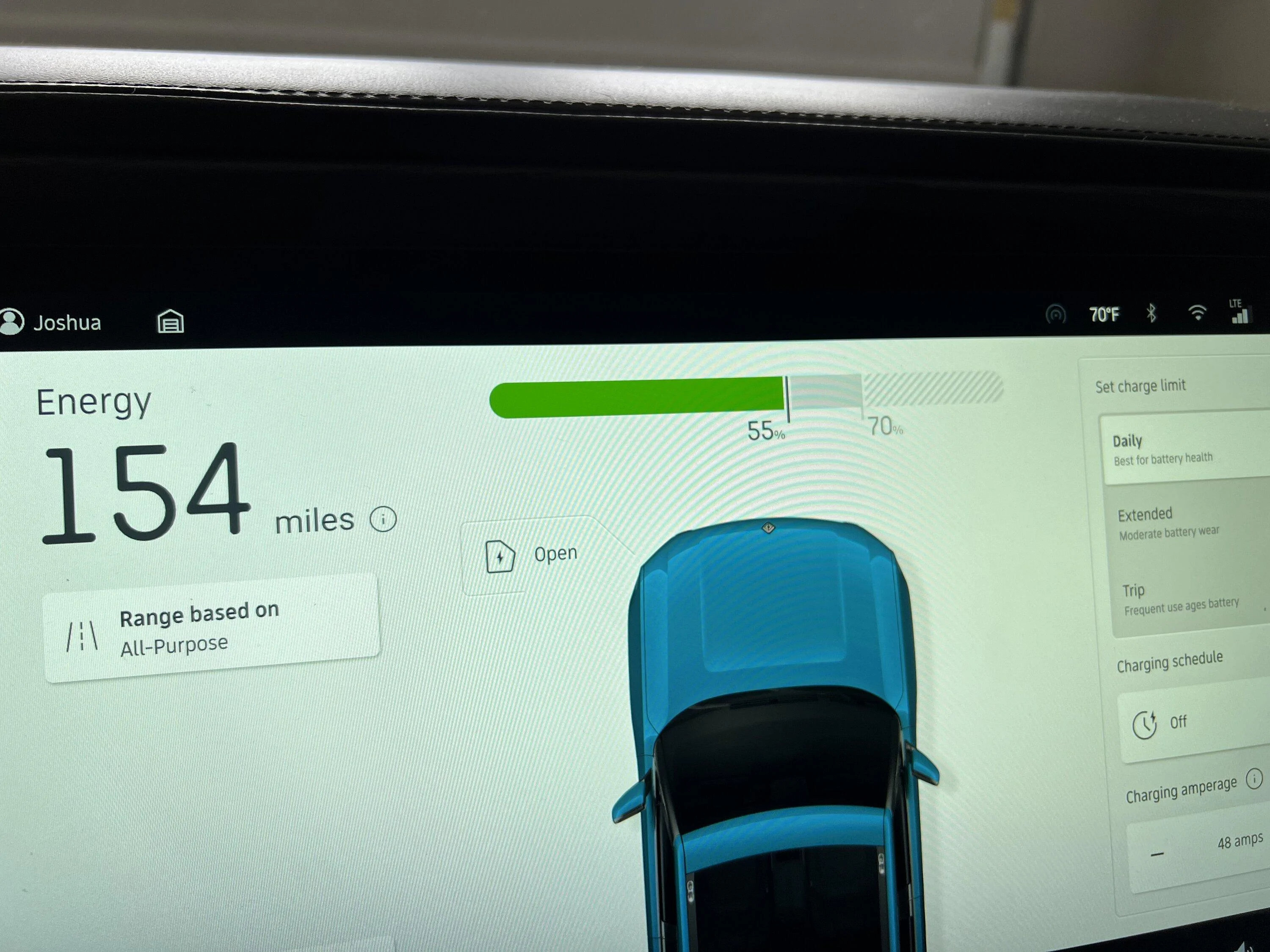

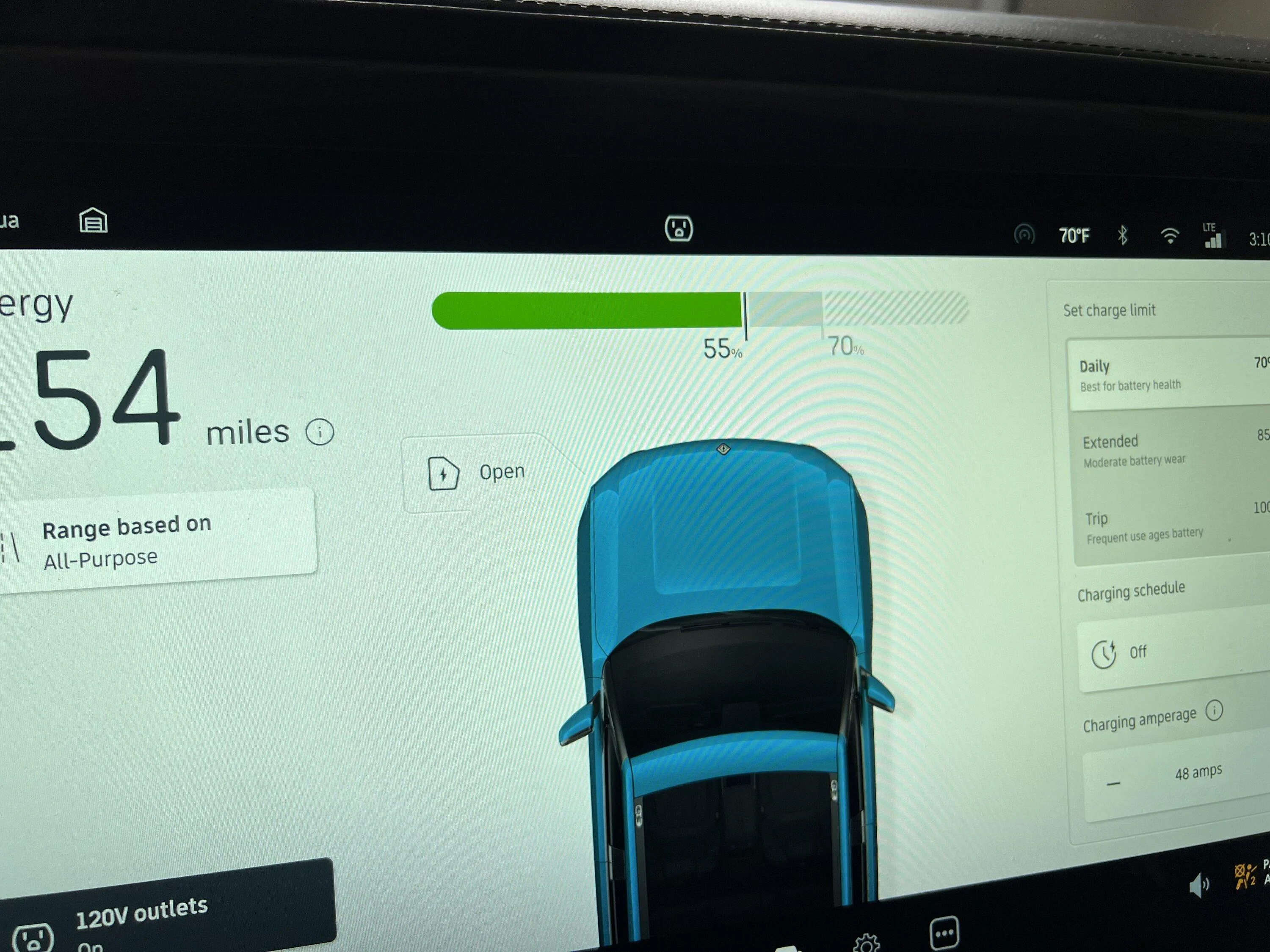

The manual also says when convenience power is on that “A visual indicator appears in the center of the status bar”. This is why I assume from context that convenience power = AC outlets
AC power off:
AC power on:
Interesting. Thanks for looking into this. Yeah, I think you might be right. I guess convenience power would indicate using the 120v power. I would say strange use of wording at best by Rivian there.

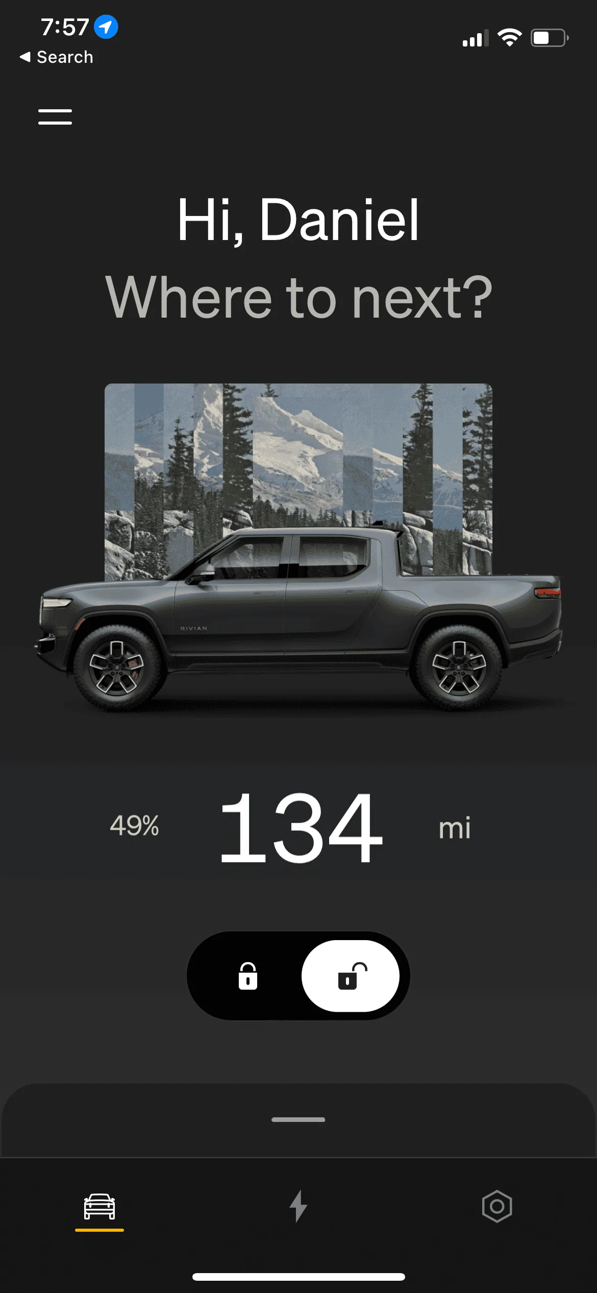

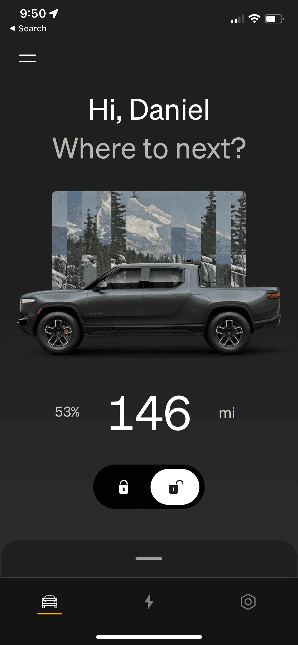

Did some testing last night. AC was off. Proximity unlock was off. Gear Guard was off. Lost 4% overnight sitting in my garage....
