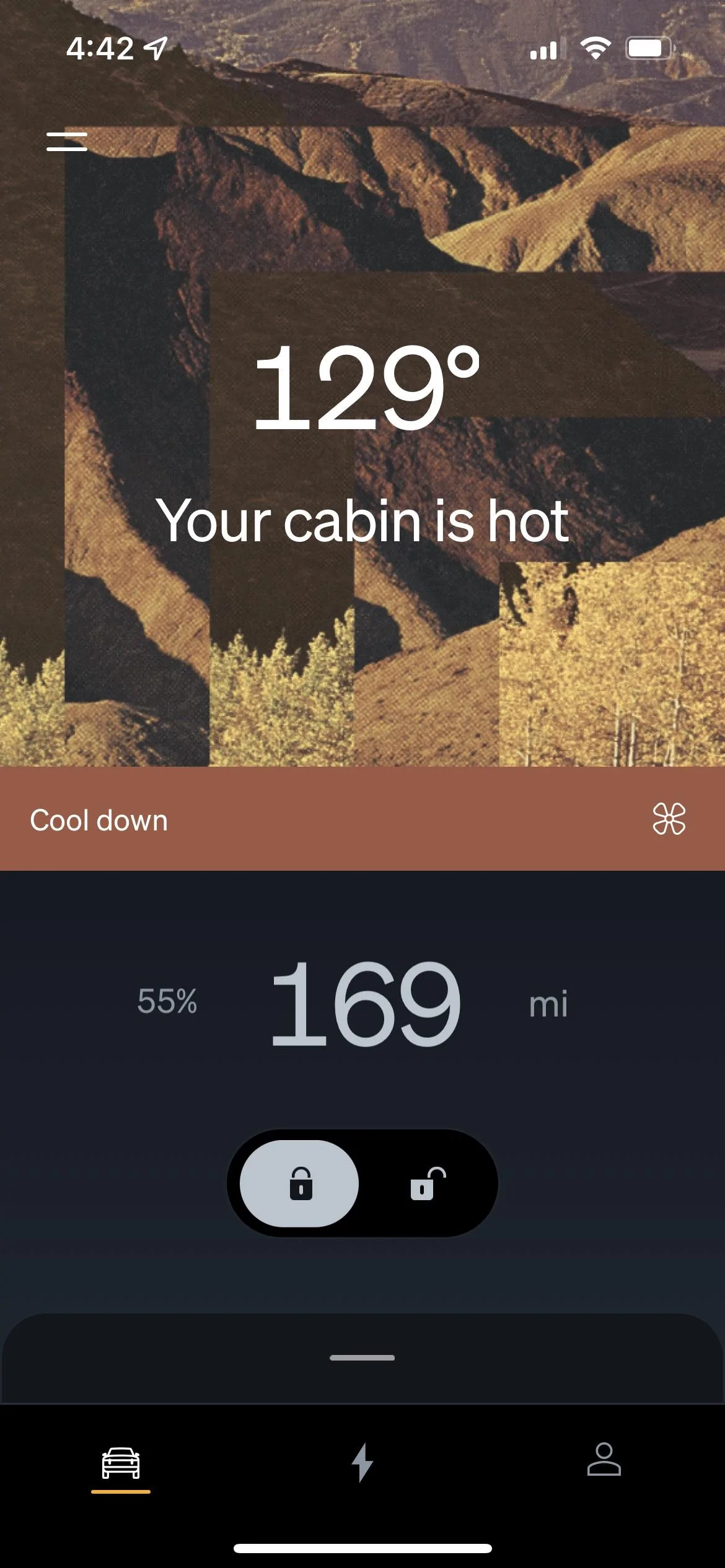

So my truck has been at the SC waiting for repairs and I was able to get the OTA update installed. It seem to have improved vampire drain from what I’ve seen over the course of a little over 24 hours.
Also if I remember correctly, I'm pretty sure I left Gear Guard on.
