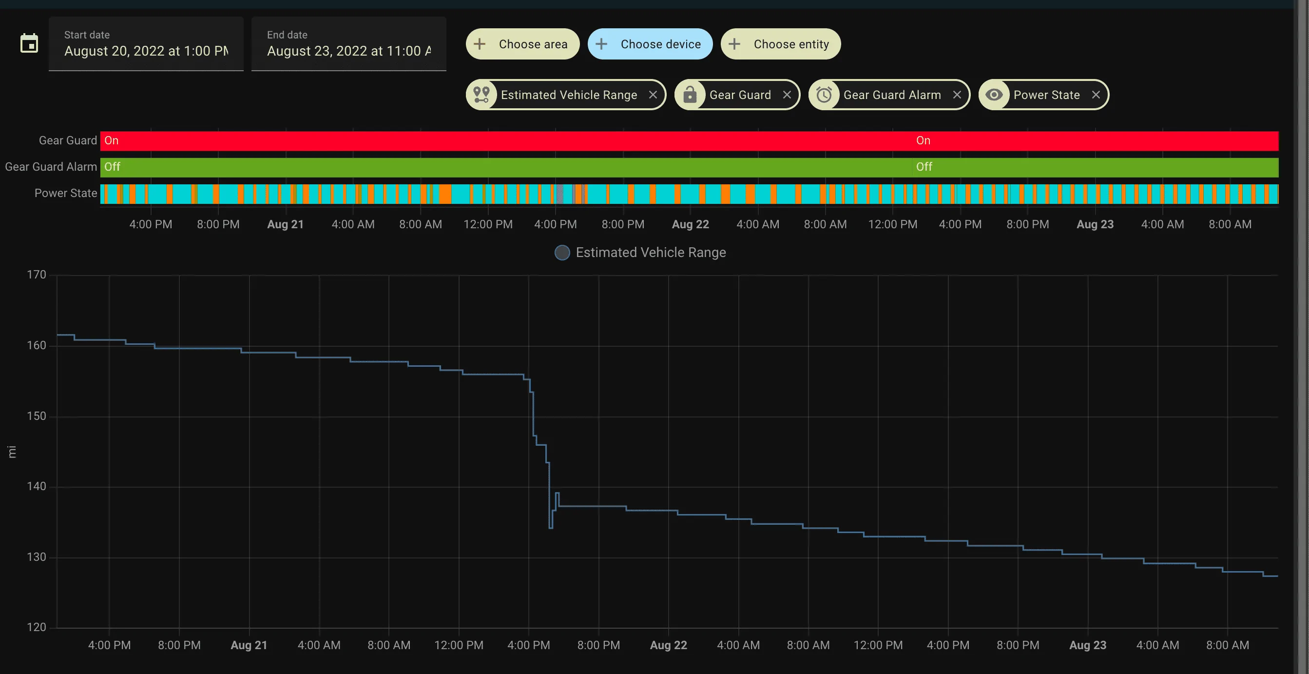

I've been monitoring my vampire drain with homeassistant. I see about 6mi/day (~3kwh or 2%) loss every day.
I see the truck switching from "sleep" to "ready" power state roughly every hour.
I think there may be a problem with Gear Guard. It should be obvious when it is on in terms of battery drain, and instead it is consistent whether it is on or off. This is very different than, say, Sentry Mode.
The graph below shows this data. The sharp drop is from a short drive and short charge at a grocery store. You can see that the slope of the vampire drain is fairly consistent all along. After the drive I turned off gear guard and proximity locking completely, and there is no change, and curiously no change in the state reported to the API. The only obvious change is in the cadence of the power state changes, which I think is due to my phone occasionally connecting via BT before I turned off proximity unlock.

^ extremely helpful!
If Rivian can keep the truck from needlessly waking every hour 24X per day that may provide huge savings.
It's very possible the loss isn't actually happening at the wakeup, but the metering of it to the API is.
