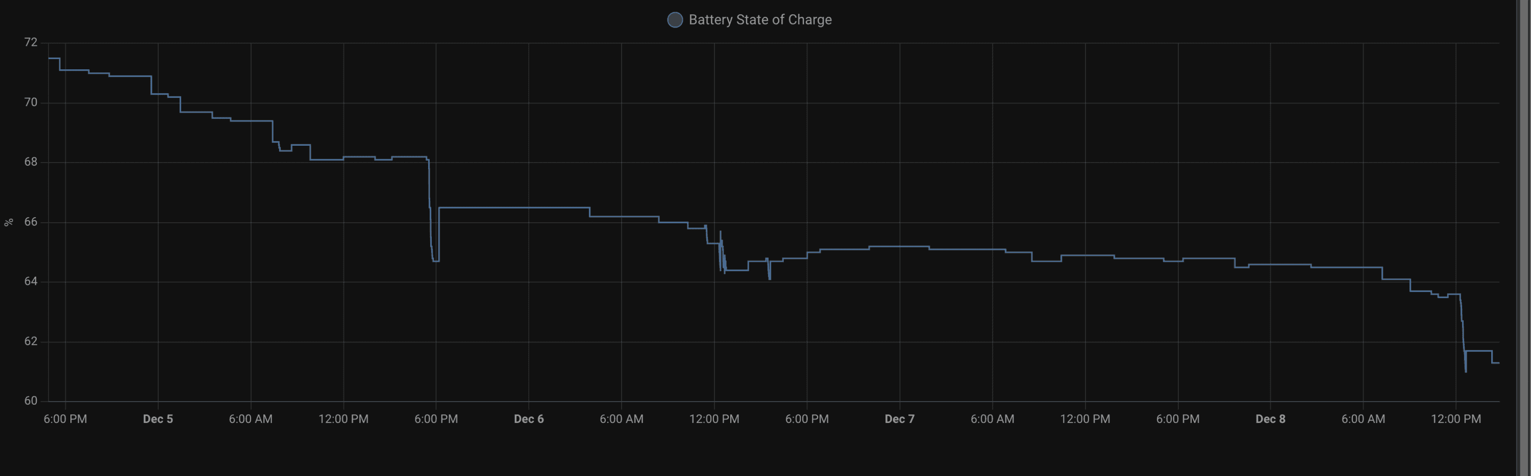

Seeing what appears to be improved battery drain since the 2022.43.02 update pushed to my truck. I am seeing a lot of rebounding (battery level goes up!) after drives but I seem to be losing less than 1%/day now, instead of 2-2.5% a day.
I installed the update the morning of Dec 5 about 7am.
Rivian R1T R1S Any tests done on Vampire battery drain? Screenshot 2022-12-08 at 2.48.17 PM

Thanks for reporting your measurements. What are the ambient temperatures?
