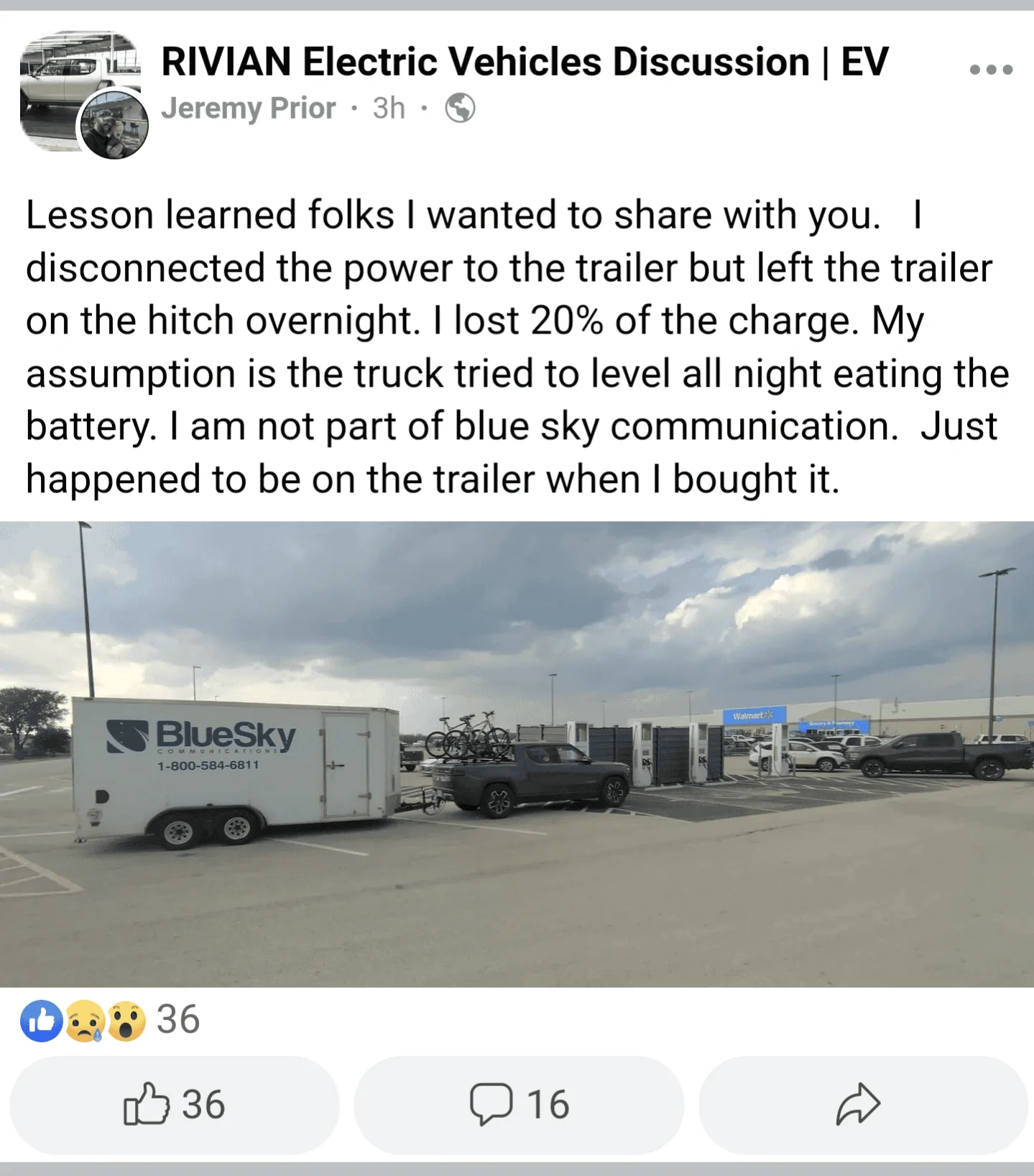

From FB group... speculation that air suspension leveling could contribute to vampire energy drain.
I wonder if this is why shipping mode requests that you put the vehicle in lowest suspension height.
