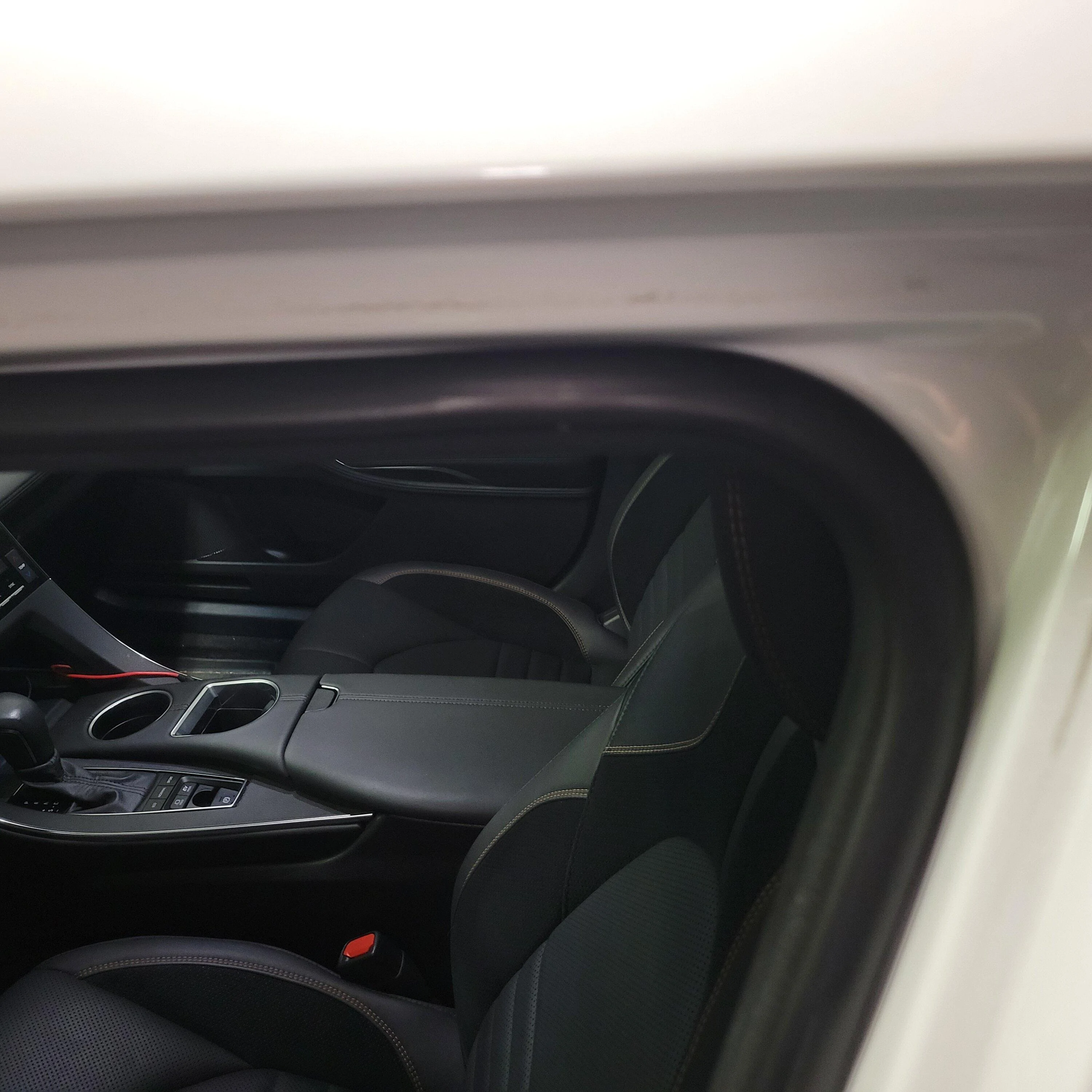

Anyone else have this window issue?
Redline
Redline
Jul 22, 2021
2,327
4,822
Edina, MN

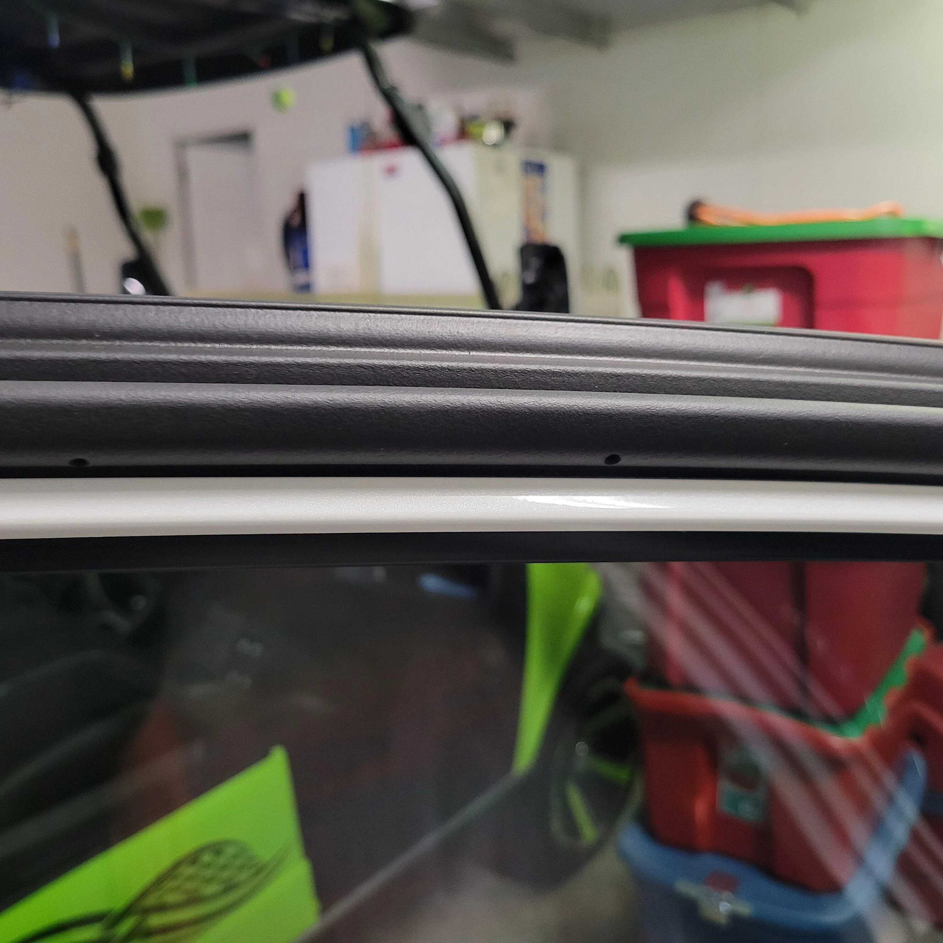

Interesting, my trim looks much tighter and as the window goes up seems like the channel pulls the top off the window inward around the last 3 inches.
The reason why mine is pulled away like that, is because if I don't manually put pressure on the window as it closes, it pinches it..pulling it away and over time, it will pull it further and further.
It's sitting properly right now, but when I picked it up from Rivian, it was pinched for probably the entire week they had it.
Redline
Redline
Jul 22, 2021
2,327
4,822
Edina, MN
I have an apt on the 16th...just spoke to scheduling and he thinks it won't be mobile because its a repeat issue.

The issue i see is that Rivian is using what we called "cat whisker" material usually used on inside and outside of the glass in the door channel and also they have 3 small break points in the material at the transitions around the window frame. These are areas for wind noise. They need to usr a rubber material seal one on the door widow frame and one on the body mating surface a la Toyota to reduce wind noise to an acceptable level for a vehicle of this price point
Rivian R1T R1S Anyone else have this window issue? 20240103_164014
Rivian R1T R1S Anyone else have this window issue? 20240103_164019
