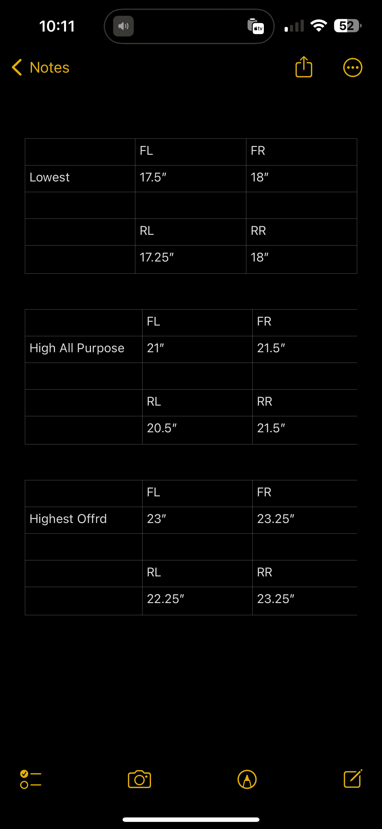

Different wheel heights (if extreme) is where I would start. Might also have an issue with the hydraulic sway control system creating unnecessary preload on one corner.
Yeah this a table from measurements I just took. Seems a bit much and side to side is consistently higher on one side.
Would you consider a difference of an inch side to side extreme?
Yes, that sounds like something is off. Might need the height recalibrated At each corner.
