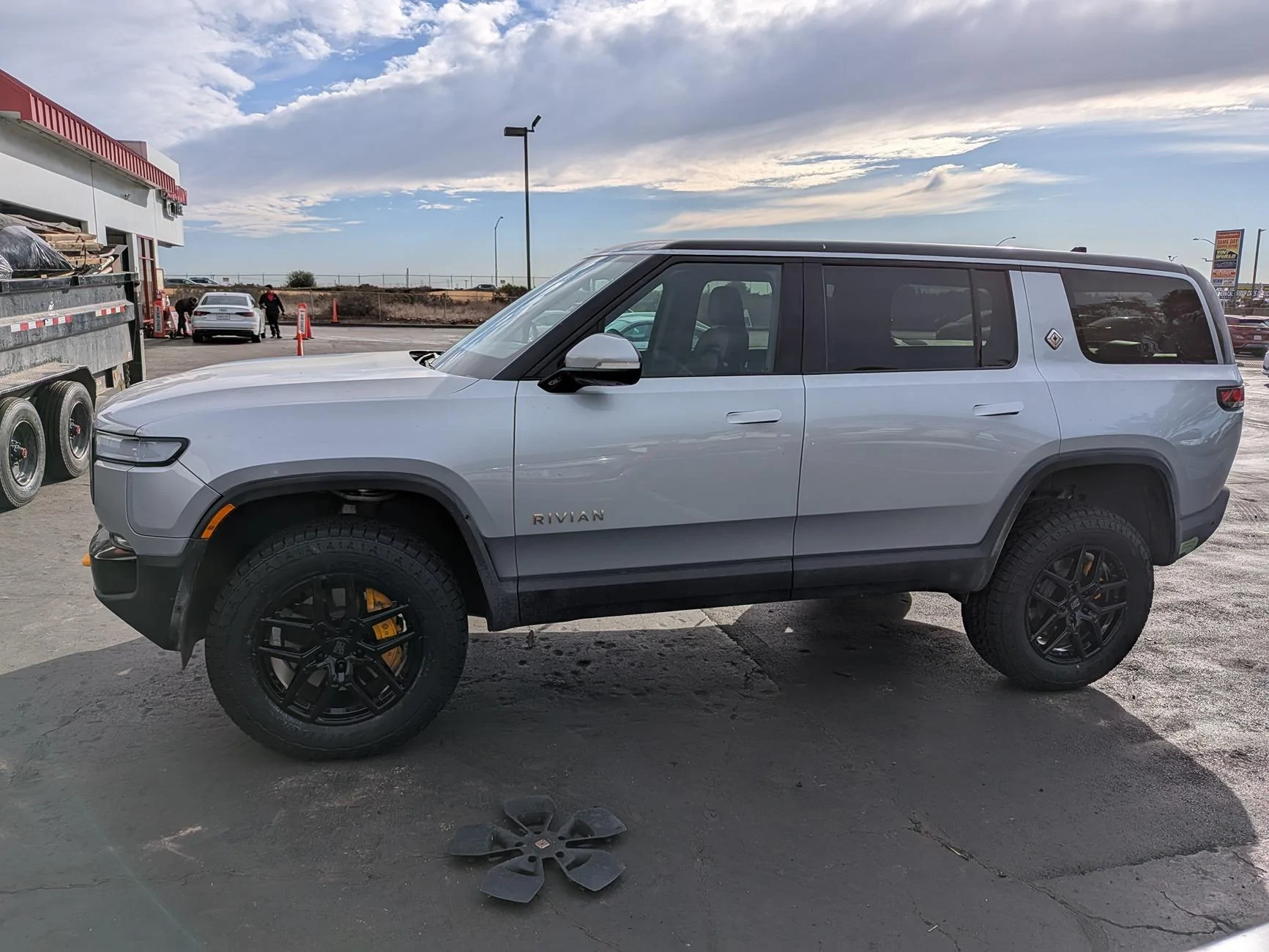

Update: I am very happy with the Dueler Ascents. I don't notice any noise, and so far I am seeing about 5% reduction in highway range from the 21" All Seasons, which is a good trade off for me. Efficiency might be worse when measured more accurately, but close enough. The truck sits a little taller too.
