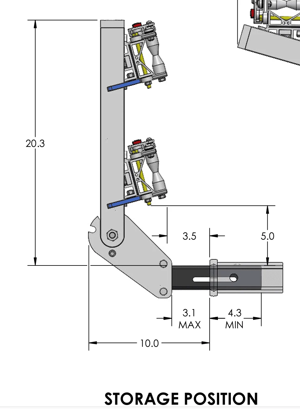

@Michaewh - can you fold up the rack when it's empty? I looked at 1up's drawing and i think it says that there's only 3 1/2" of clearance from the end of the hitch to the rack when stowed and my truck needs at LEAST 4 1/2".

How did you make this work? Did you use a hitch extender? I really like the 1up superduty but I think I couldn't fold it up while on the truck.
Thanks!

I just fold it up as close as possible (probably exceeding the spec, but when empty its not much of a risk). You also have the option of folding part way, so it up out of the way, but not fully verticle.

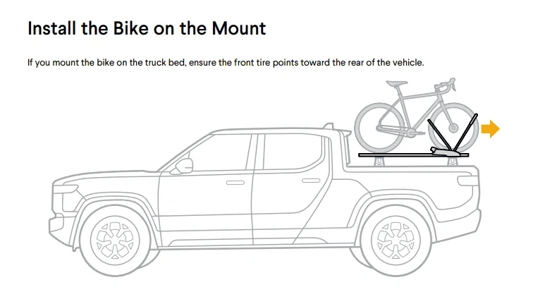

Rivian's guide shows mounting the bike facing backwards. I'm assuming because larger bikes would rub against the spoiler?
I believe that is correct.

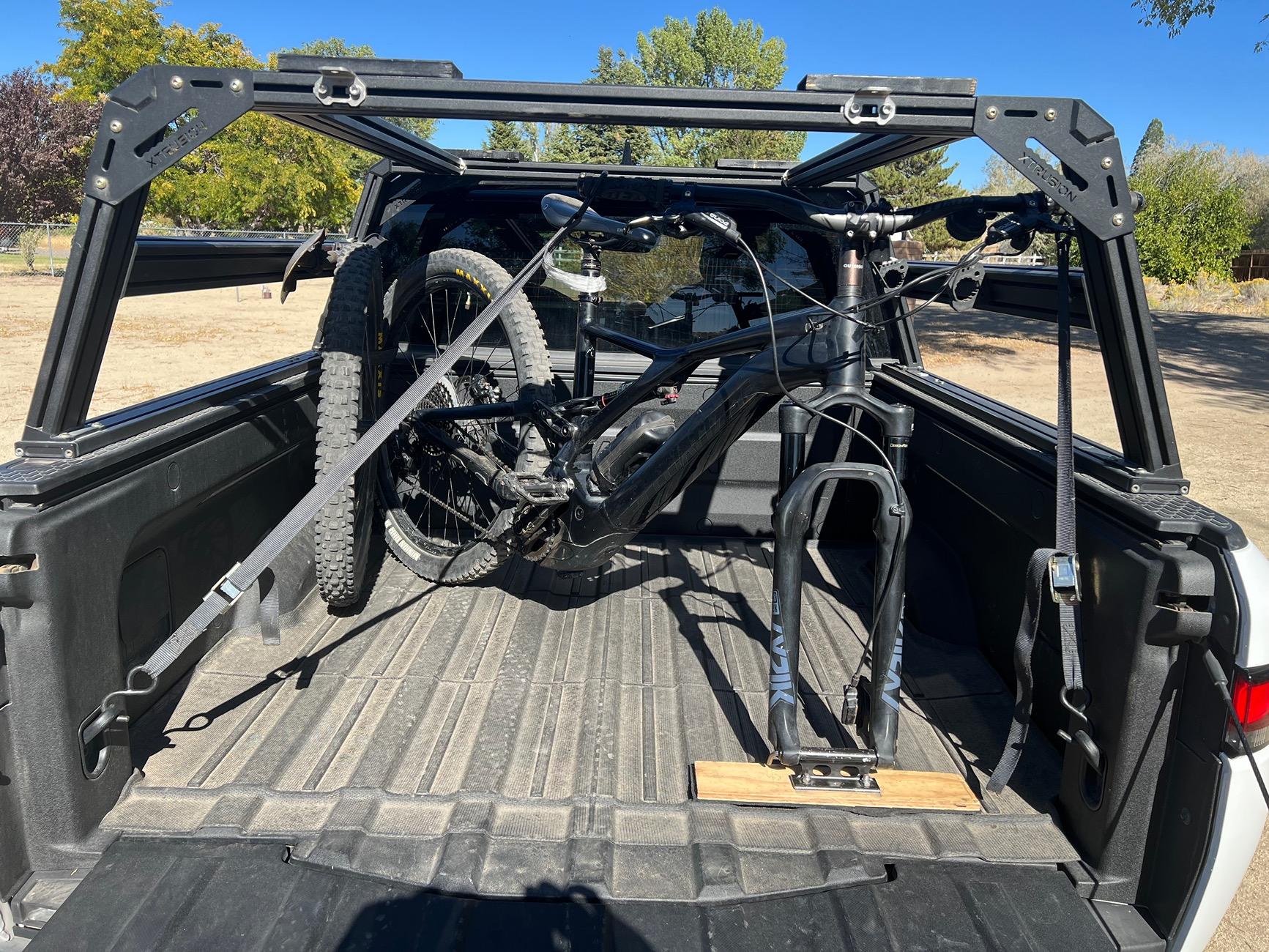

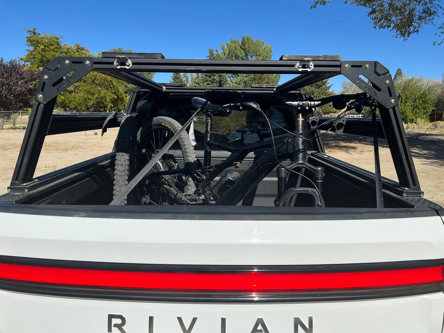

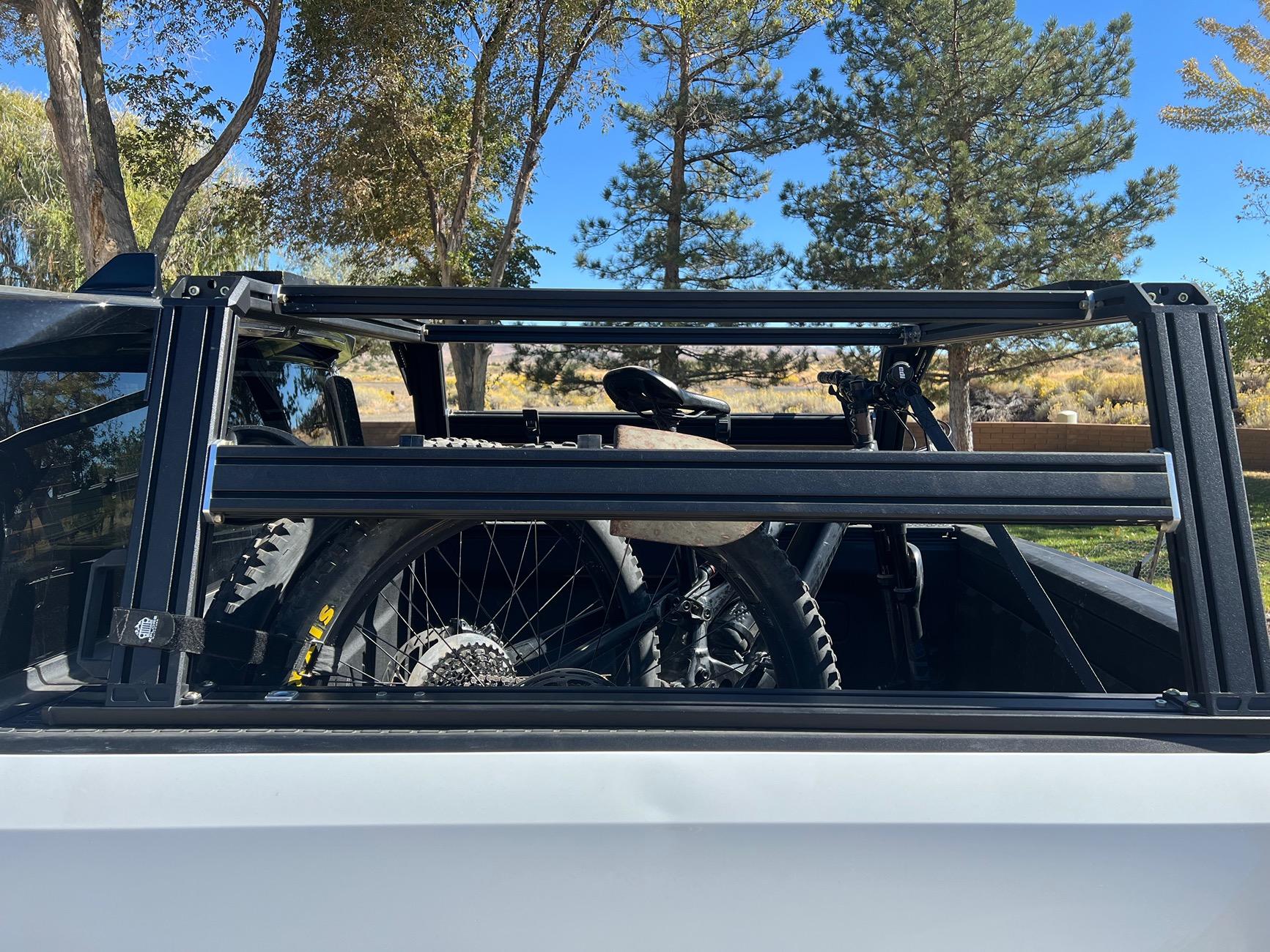

My solution for an in bed mount, mostly for one bike. I wanted something that would be secure and not permanent. The bike sits just underneath my bed rack. I have also disabled the entrapment button in the bed so that the tailgate can’t be opened when the truck is locked. This should make it more of a challenge for anybody to steal my 50 lbs. E-MTB. The axel mount is just bolted onto a small piece of plywood, which is NOT attached to the floor of the bed. I velcro strap the back wheel to the bed rack, to hold it in the front corner of the bed and secure the loose front wheel. The tie down straps just hook neatly over the grips and do not slip. When not in use, I just toss everything in with the spare tire. This setup is super solid, easy to use, cheap, and nothing moves, even with aggressive driving or on rough trails.
For reference, this bike is a large frame 29er. It might be possible to squeeze a second smaller bike in there, but I dunno. A smaller frame and 27.5” rear wheel might allow for sufficient room. Where there is a will there is a way ?

@Singletracker Nice set-up on your bike in the bed there. I think people who steal stuff see it as opportunity and simplicity...with your set up and the tailgate up, it's not that simple for them to get a bike out of the bed...they'd likely move on to another easier target.

My thoughts exactly! With the rack and the tailgate locked, there is not much room to work with. If they could extract the bike, they would still need to the proper Allen wrench to reattach the front wheel, unless they planned to drag it away.
