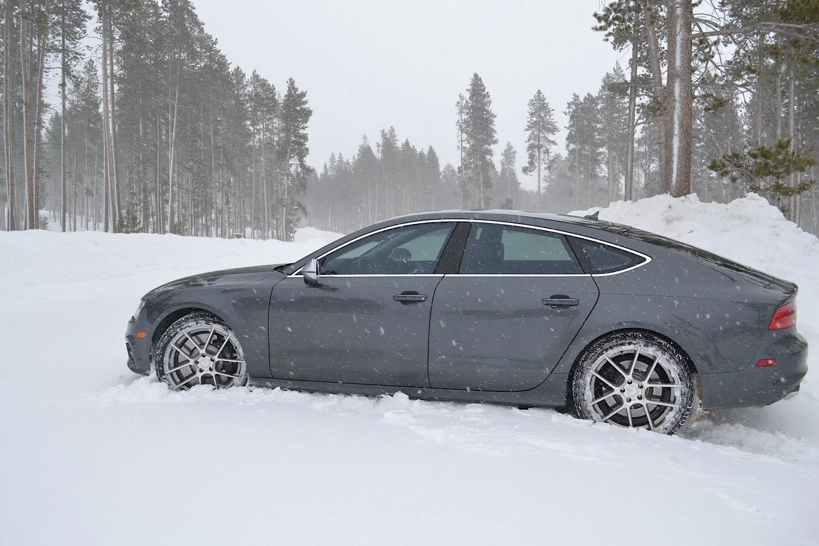

If you're regularly driving fast in snowy conditions you should consider another tire.
Or another vehicle. Unfortunately traded this sled in, which made many a first chair.
