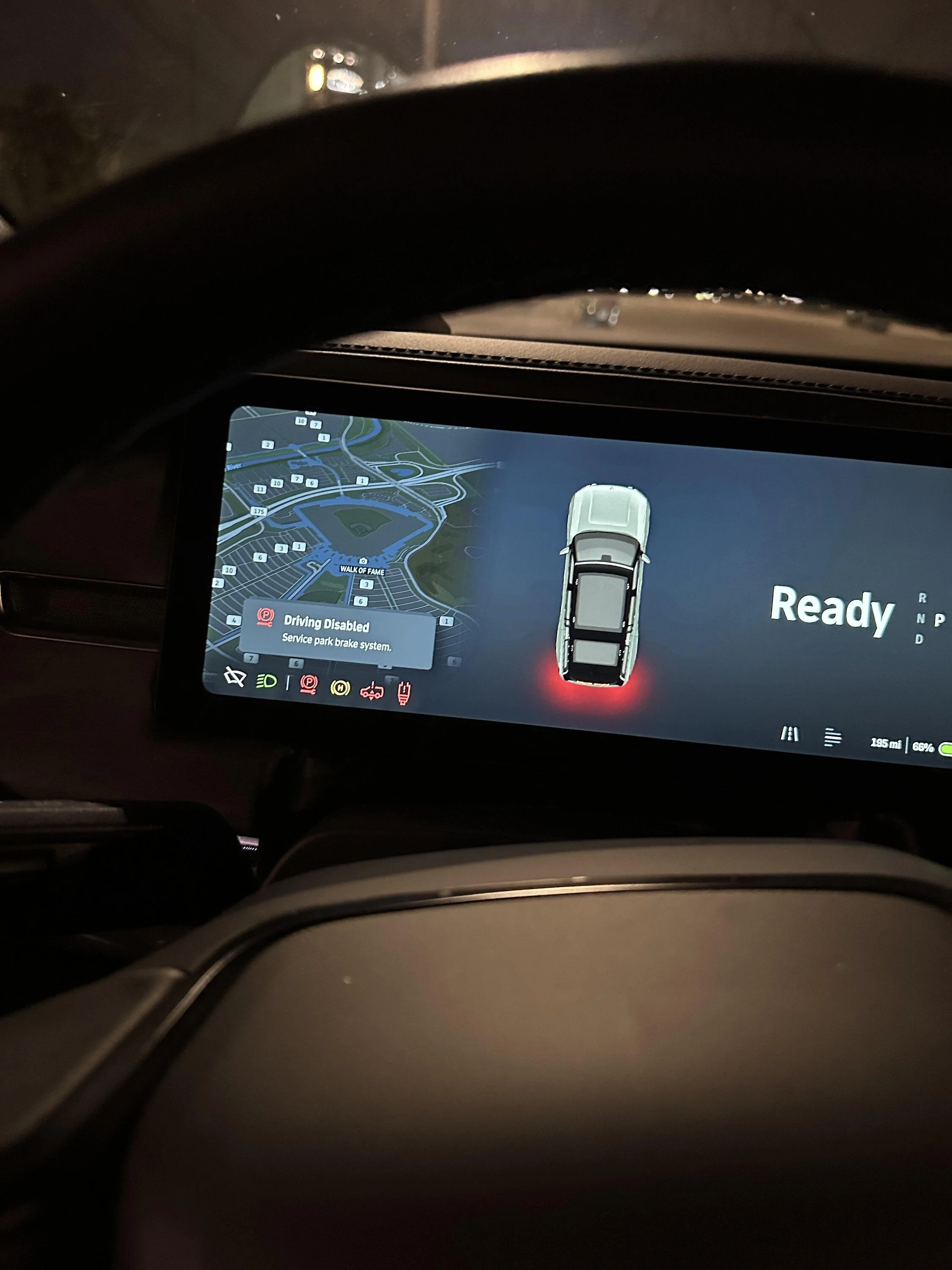

Same thing happened to me after one month of ownership. The problem was a “soft set connector”. Since they found that issue, hasn’t happened again in 22 months.
What was the cause in your situation? I’m in the middle of this fault at the moment and they don’t know why/cause.
they first thought it was a faulty brake caliper and replaced it, but the problem returned. Eventually they found a “soft set connector” in one of the modules. Once they fixed that over two years and 30,000 miles ago I have had no more problems.
They’re currently saying calipers are seized but don’t know what caused it. They don’t know how to replace them either because they’re clamped onto rotors and they’re unable to get them to release.
strange. When it happened to me the truck put itself in park when I stopped and then I couldn’t manually release the parking brake through the settings menu. Not sure if it’s related but I changed the ride height a few times and then was able to get it back in drive at least for a while. Nothing else worked including hard resets.
Oh interesting, it didn’t occur to me to change ride height. Resets didn’t work either. It did prevent drive or neutral “Driving Disabled Service Park Brake System Immediately”.
