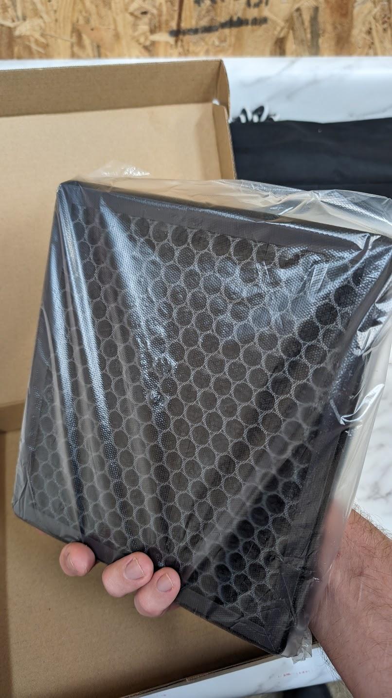

I ordered one. That's not how it looks. It's got the little black charcoal pellets all in it. Will try to post a pic at some point whenever I get around to changing it. ?
The ones I got were identical the photo, the back side however does have a honeycomb pattern filled with charcoal pellets. It gave off a slight chemical smell for the first day or so, but quickly went away. So far, works fine but does slightly reduce airflow as RivianTrackr pointed out in his video.

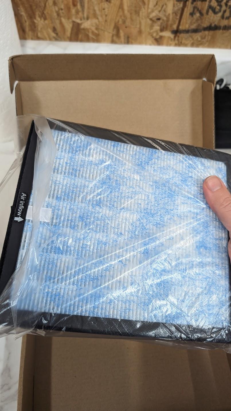

Oh - you're right about that filter. Realized when I took it out of the box (LOL):
Back:

Front:
Rivian R1T R1S Cabin Air Filter Replacement ...wildfire smoke 1701903766178
Edit: or do I have "front" and "back" backwards? Suppose I'll figure it out when I go to put it in there. ?

Blue side faces the front bumper, also the foam gasket around the edge gives it a nice fit.
