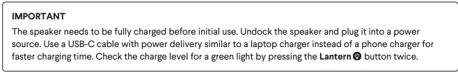

Are others finding the speaker is not charging in the dock?
In the owner's manual, they explain that the speaker must be charged initially from a wall plug in the house:
Rivian R1T R1S Camp speaker pairing and charging problems 1713145044931-7f
After that it's supposed to maintain the charge from the dock in the R1. If you never charged it externally until you got the beeping that may have simply been your issue.
