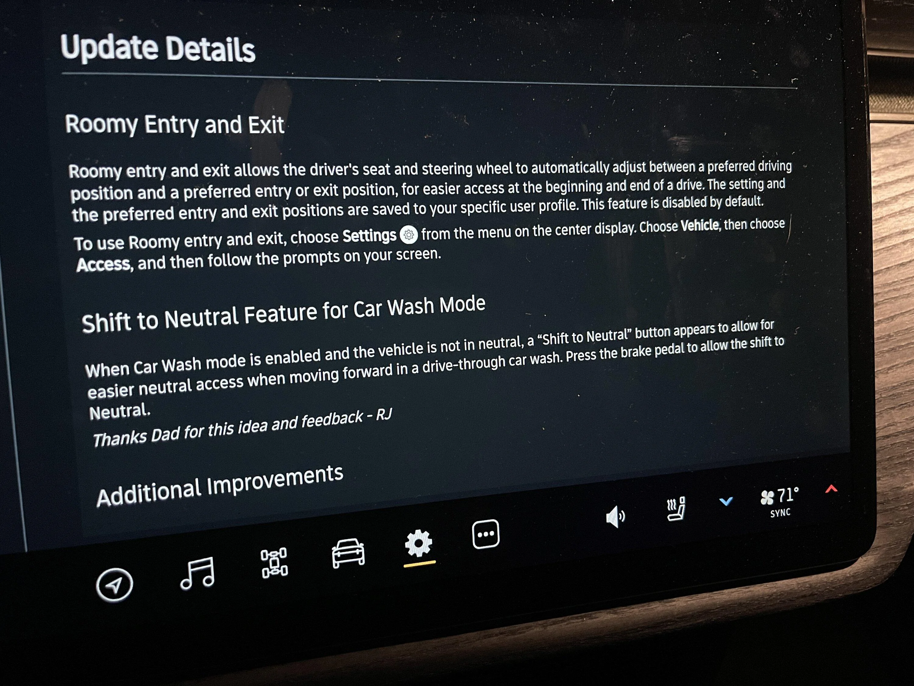

It appears from the notes on the 43.0 update that they have addressed this issue thanks to RJs dad. We just need to wait for the next update.
see pic from @JizJizJiz
