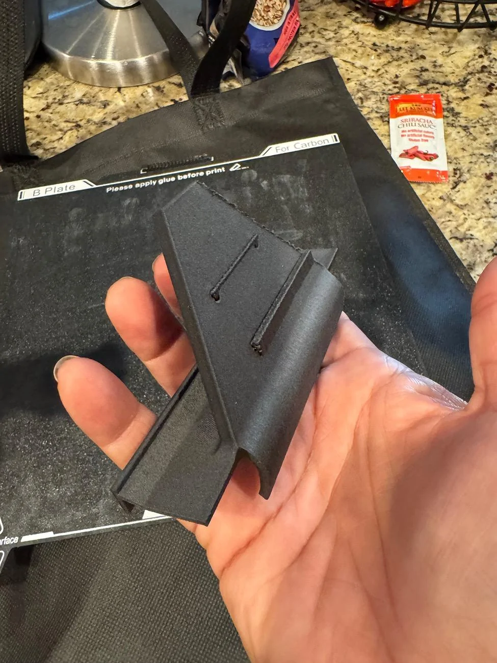

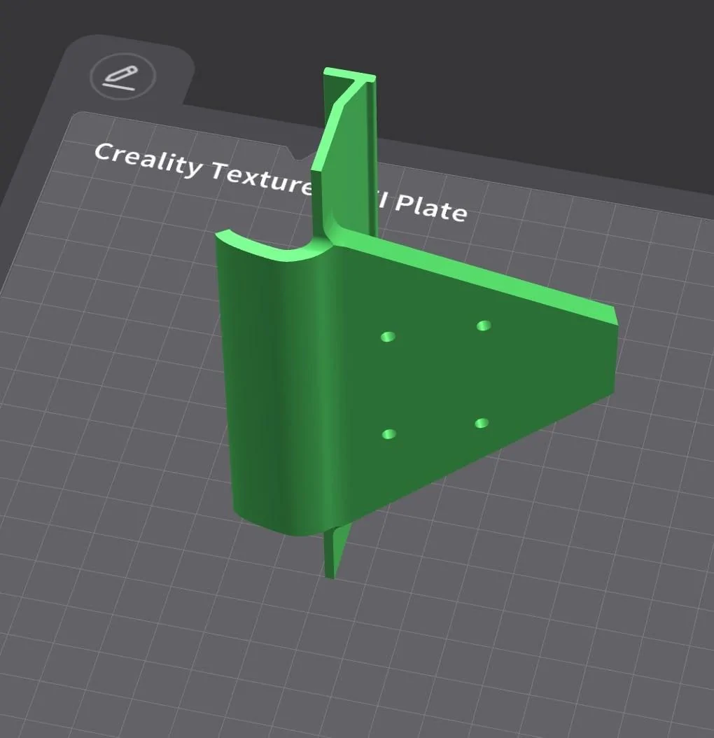

And I'm on the final (I think) iteration of this 3D printed mount:

Looks great, Do you know if the hookup is similar to Evsportline screen? Did seller provide hookup wiring? The mount you drew up. It looks like it's similar to the one the shown in the Evsportline install video. Kind of wedges underneath the top dash panel above the existing screen. Did it work?

The connection is identical, but they don't provide the cable. It's around $14 on Amazon. The mount I'm using was created by someone else orginally, but had a few mods needed, so I'll upload a remix file soon. It just came out of the printer and looks great. It's SOLID. It is similar to EV Sportline's but with one more support for less wobble/flex. I've printed several versions and they work but needed improvements.

I'll do a video, photos, and list of parts when I'm done. It all works great, just needs to be perfect, because I'm a princess.
