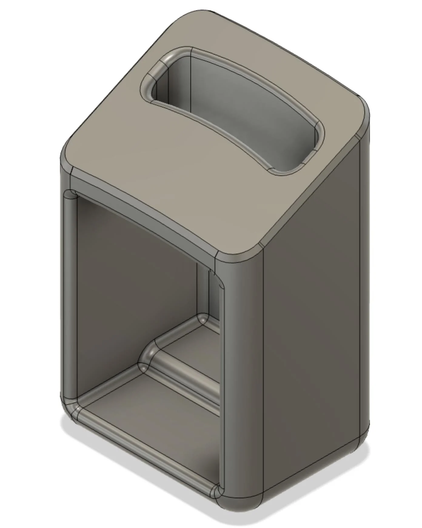

What I'm working on would definitely be 3D printed, but I am currently printing out the first prototype. I fully expect this to need several more iterations and modifications to fit the way I want it to, but I think I'm off to a good start

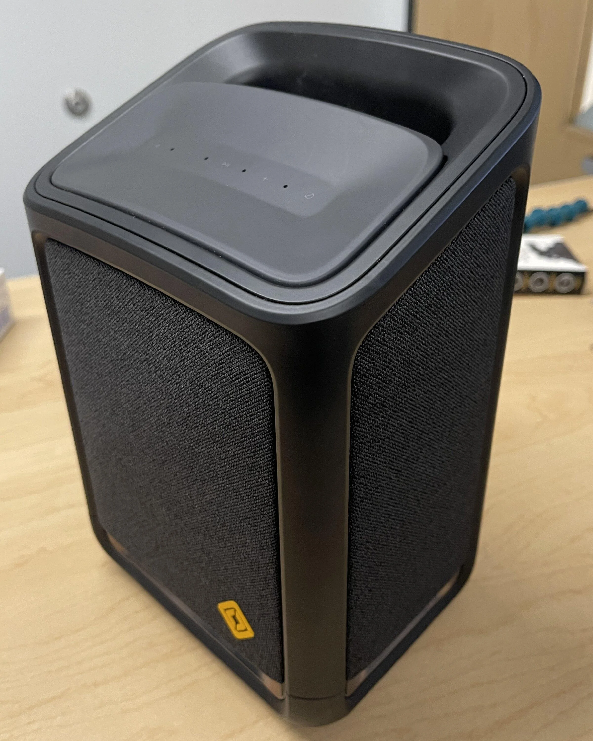

Has anyone forensically opened up the OEM speaker? can it be gutted and re-purposed into a storage drawer?
This is pretty great! Excellent start! There will likely be a TON of issues when it comes to printability/manufacturability, but they are workable.
If someone has, I haven't seen it publicly posted anywhere.
When I was measuring and mapping out the model, I did think briefly of how much easier it would be to gut the speaker, but I'm definitely not willing to throw my speaker under the knife for that.
Exactly! And since I don't work for any kind of production/manufacturing facility, I will likely simply share my design to let others print it. It is a large print, but thankfully I have printers large enough to handle it as a single object.
I would love to give printing this a shot if you want to share the file.
I want to do the first test fit and modifications as needed. I will definitely be posting it on Thingiverse once it gets going.
This is as close as I've seen. I decided not to tear mine down at all after seeing it. Looks like the panels all come off pretty easily but there's not a big open interior space from the "top" as it seems like a pretty solid core.
