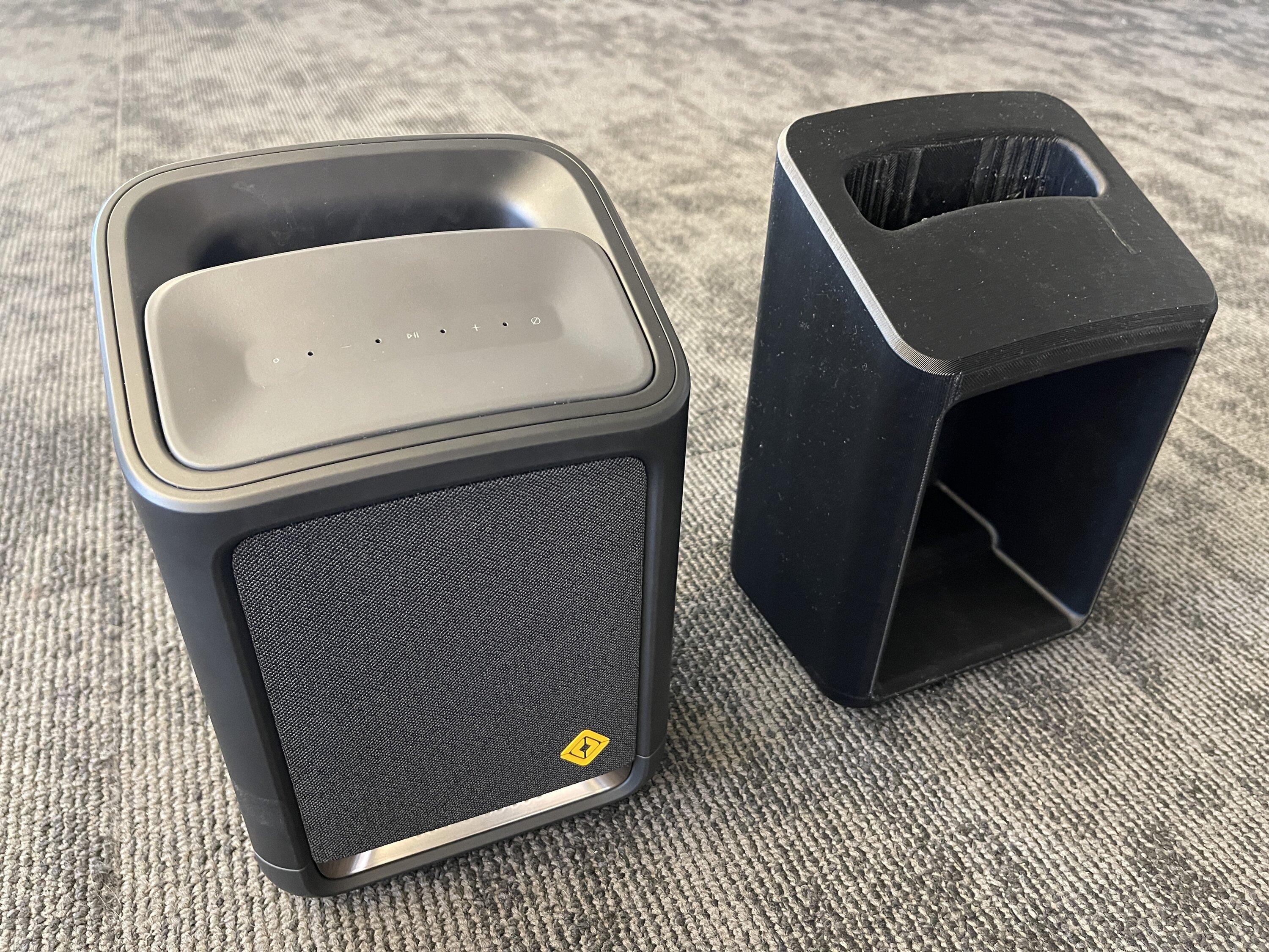

First prototype is printed and fits. It even looks like I was a little bit conservative, and could make it slightly larger. The next step is figuring out exactly what holds the speaker in both with and without the lock engaged so that I can make the drawer stay in the slot the same way.

That one of the contributing factors to why I (and likely others) haven't done anything in this space yet - We're uncertain what Rivian is planning. It could be a drawer. It could be a cover. It could be just a larger opening that makes the big area in front of the console just that much bigger.
The space itself it rather large, and frankly, without much going on inside of it. It's basically a horizontal hole with a latch and a pogo-pin 12V power connector at the very back. There are no guides or notches around the exterior of the hole. It is rounded at the side, rear, and front which makes using something off the shelf basically a no-go.
The latch at the back which is also seemingly the only way to keep something in the hole, also happens to be powered, so it will likely require a metal latch so it doesn't break when triggering close. I'm also not 100% sure if there is some connectivity using the pogo pins to signal if something is in there for the latch to be closable. If thats the case, it will be problematic. We will basically have to reverse engineer the pins to emulate the response from the speaker to get it to operate or do something kludgy like use magnets at the rear of the hole.
Size will also be somewhat difficult. This is juuuust big enough to make 3D printing more complex. It will likely need to be broken into different bits, and should likely be a combination of that + something like mesh or laser cut metal or plastic for the bottom and two sides. Injection molding isn't really an option due to the potentially very low volume of the item. Keep in mind that I would want to design an produce this in the US with real wages for the folks who are making it. Other vendors may have a different model, so YMMV there.
I don't think I would want to make a safe or similar. I think that additionally cuts down on the market, increases pricing, and likely others would do it better. It's more of a specialty item, even in a much higher volume vehicle like a wrangler.
The last bit is cost. Generally, I try to keep item cost down. This would likely balloon a bit in price - maybe to $100 or $150. Is that really viable for essentially a drawer? I'd really like to hear from folks that are interested. For me, personally, that feels like too much...

For those who are looking for a "concealed containment" solution, I will be honest and say that's not specifically what I am designing this for. But I once I have a workable model, I will definitely be sharing it on Thingiverse with appropriate copyrights to allow for remixes and remodels with appropriate attribution.

I'm still working out the bugs. The base model is fairly well modeled, but there's something keeping it from seating completely. Then I have to figure out how to install the "lock latch" so that the locking mechanism works.
Also, work has been super busy recently, so I haven't had time to focus on it.

I should hopefully have some time to work on it tomorrow. It's getting pretty close, but still needs some additional tweaking.
The trickiest part is going to be finding a way to engage the lock for additional security. That function may have to wait for a V2 design.
Nevertheless, your support is appreciated and I hope to make some progress on this project soon.
