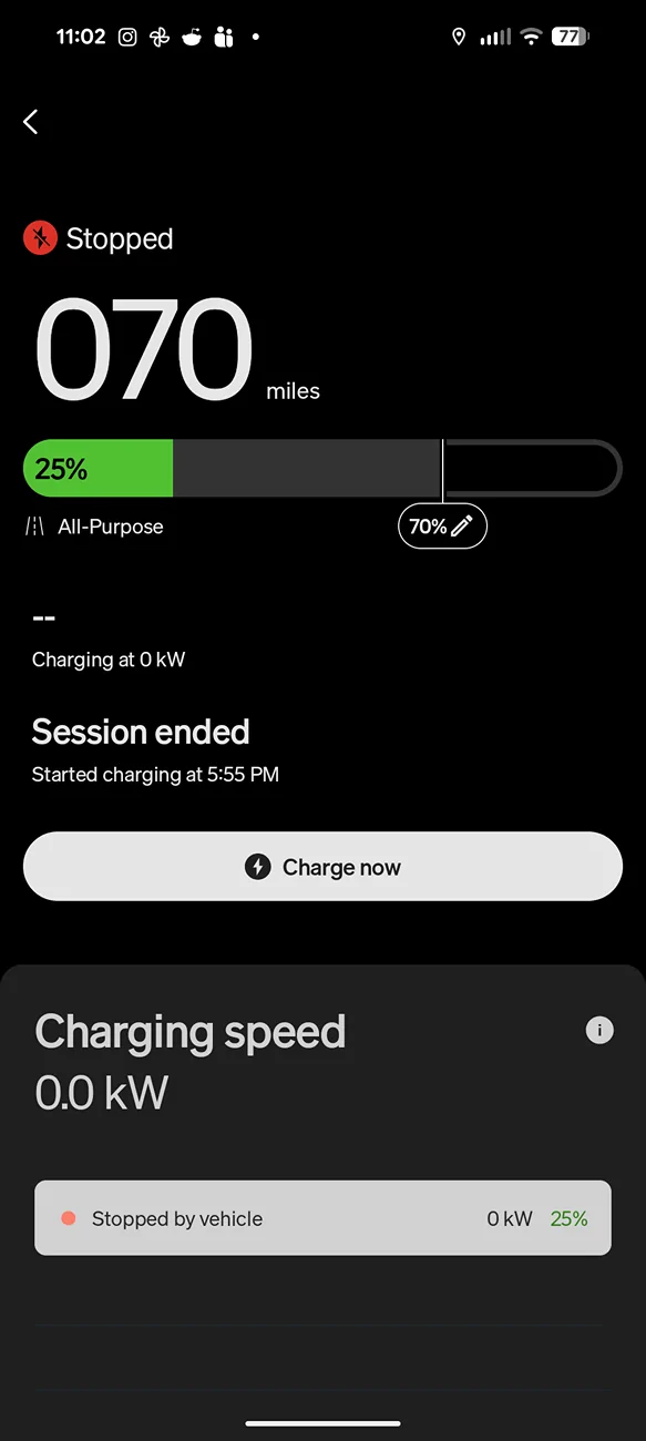

Just to add to this, the truck appeared to be waiting for charge at 10:59PM, At 11PM, the charger offered charging but then the truck indicated the charging was stopped by the vehicle. See the screenshot in attachment. If I hit charge now, it goes fine.
Rivian R1T R1S Charging Issue Since 2025.38 - Anyone Else? Screenshot_20251201-230222
