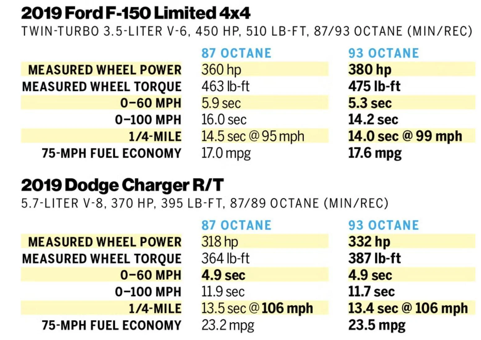

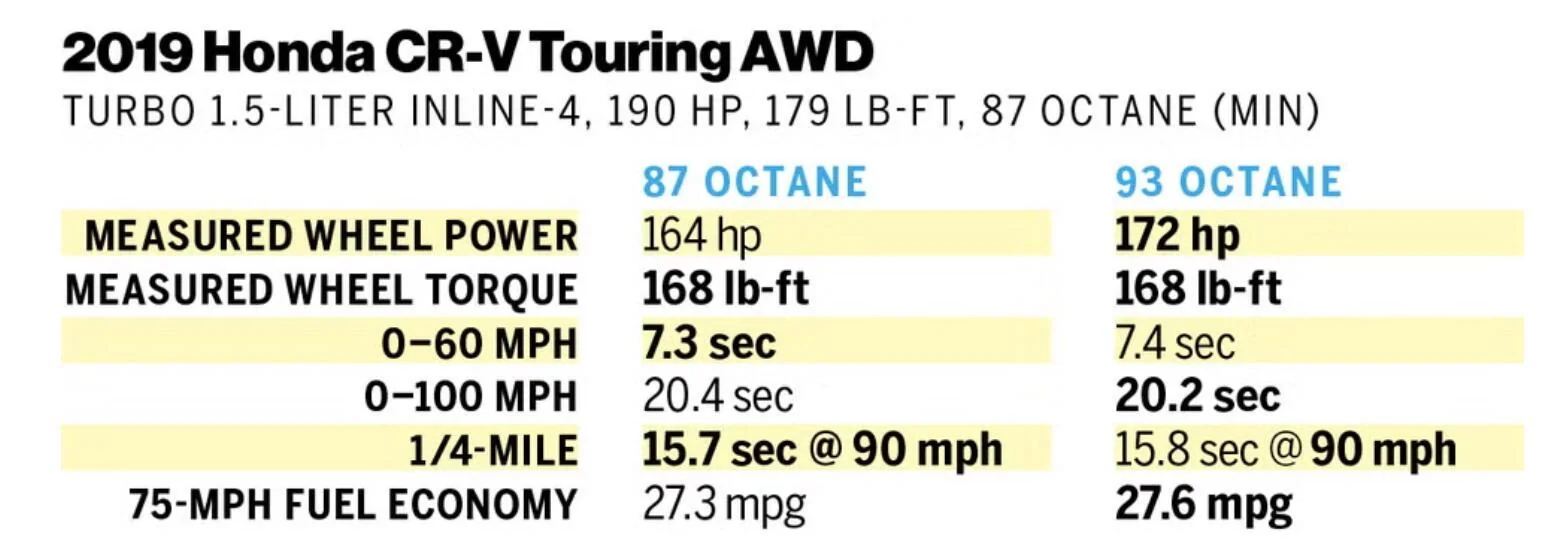

Interesting....but how do you equate what you do now with what future owners use/issue? Your Audi will run just fine on regular unleaded forever because the car has sensors to detect knock. As long as those knock sensors are working, then zero damage will occur to the engine. However, you're not going to get full performance of the engine using lower-than-required octane fuel. If that doesn't matter to you, then it's all good. Nobody is going to care and it's not going to do any damage to the engine.
The other issue is that your fuel economy is likely to be down using lower octane fuel compared to the required (or recommended) octane fuel. This is because ignition timing can be adjusted when using the lower octane fuel. So you may not be saving as much as you think by putting low octane in your Audi. But either way, you aren't going to damage anything or cause issues for future owners. Audi (like all manufacturers) know that there will always be cheapskates who refuse to pay the extra cost of high octane fuel and since they have to provide a warranty, they make the cars so that they will not get damaged by low octane fuel.
I'm going to call BS on that. 10 years ago I did a little test in my Volvo XC70: On a long trip from DC to Rochester, NY to Burlington, VT, I used 92 or 93 (the highest available to me) on my way there, and simply regular unleaded on my way back. 730 miles each direction. I got a whole 1MPG better.
And to be sure there wasn't any contamination, I filled the tank up w/ 93 a full week before we left, and put 87 in it while driving around Vermont. Sorry...the MPH improvement just isn't there. And I've been doing this in every leased vehicle for over 12 years, and not once have I heard any knocking.

Why are you calling BS on it? He's correct, it's well known, and has been for years, that using the recommended octane will allow the ECU to optimize the timing based on knock, which is a function of octane rating.
Your extremely unscientific experiment of NY to VT and back is surprisingly close to what has been found in controlled tests such as Car & Driver, along with improved performance which you may not have noticed. You won't hear knocking, the ECU detects it before you even hear it and adjust the timing accordingly. @White Shadow is correct, not BS.
